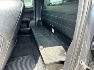

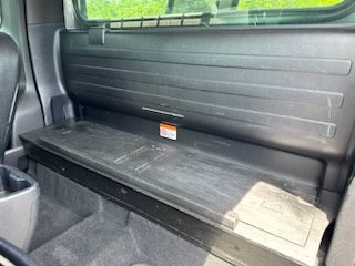

    Here's what it looks like after doing the backseat delete.
    The previous owner did this and had this custom box installed for storage.
    Unfortunately, I wanted the seats so I'm currently swapping it back out with trade of my back plastic for parts from another TW member here.
    Having said that, if anyone is interested in this storage box for their back area, it is essentially a wooden frame that bolts through the upper portion of the metal storage bin of the cab. The lid then screws to the frame and has 2 lids with handles. I have all the hardware for reinstallation and can ship if necessary. Located in California.
