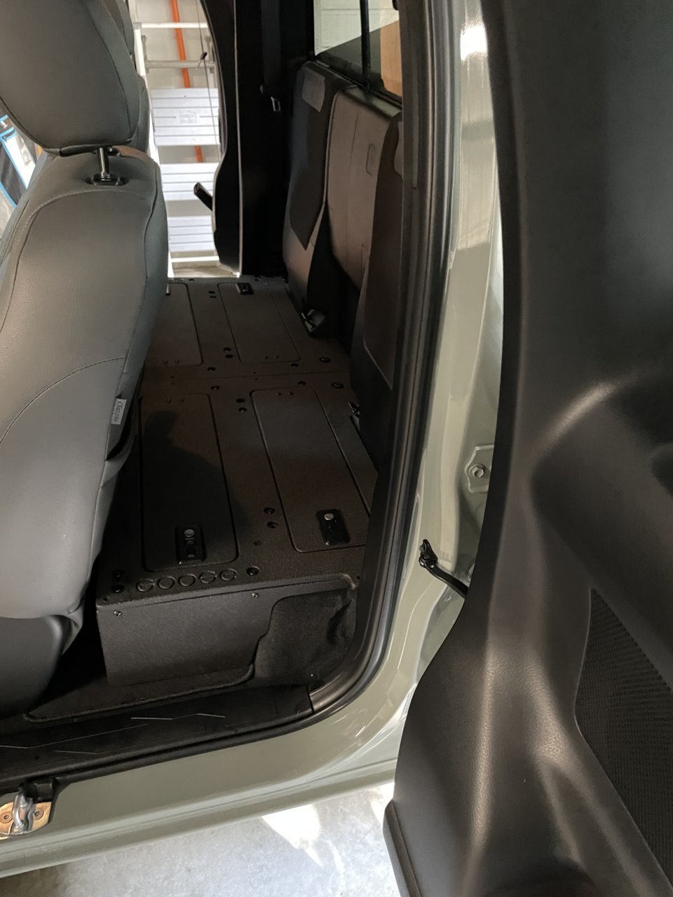

    Your seat looks a lot further back than I set mine.
  2. Aug 6, 2023 at 5:19 PM
    #102
    Plaintaco
    Plaintaco Well-Known Member
    Mar 4, 2013
    #98992
    50
    Houston, TX
    2023 Access Cab TRD Off Road
    Yes, that’s as far back as it will go. I’m 6’2”.
  3. Aug 6, 2023 at 5:28 PM
    #103
    2Toyotas
    2Toyotas Well-Known Member
    Dec 11, 2016
    #204565
    2,867
    Ken
    Western NC
    '13 Taco SR5 AC
    5'10" here.

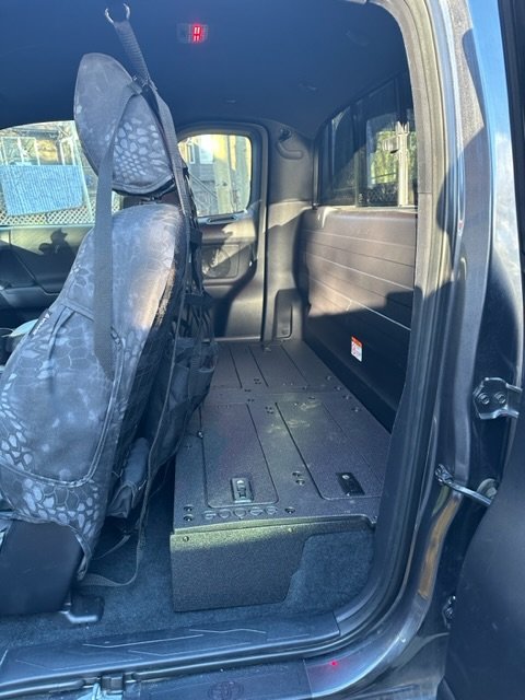

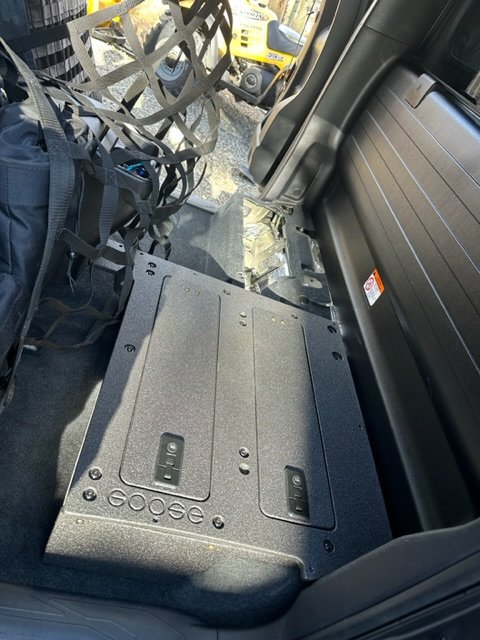

    I'm putting one of these in my access cab right now... I'm sure it's a long shot but do you remember where you put the long bolts they included vs the short bolts? I'm going to start trying each one to see if it fits lol. Just a basic set of instructions included would've been awesome :frusty:
  5. Nov 17, 2023 at 2:57 PM
    #105
    jgr81
    jgr81 Well-Known Member
    Feb 8, 2016
    #177511
    477
    Jen
    Summit County CO
    16 Tacoma TRD OR Access Cab, 03 4runner v8
    For any other 3rd gen AC owners who get the goose gear seat delete... (with the utility back wall panel anyway, guess it may be different if you still have the seat back wall)!
    For each seat delete side, there are three long bolts and washers, one is thicker and it goes in the outside corner kinda below where the seat belt is. The two long thinner ones use the two nuts that come in the kit and bolt into the holes that were used by the cargo cubby tray thing. The two shorter thicker bolts along the back wall toward the middle of the truck. It will make sense when you have the box sitting in place :) don't tighten it all down til the end to make sure it all aligns nicely.

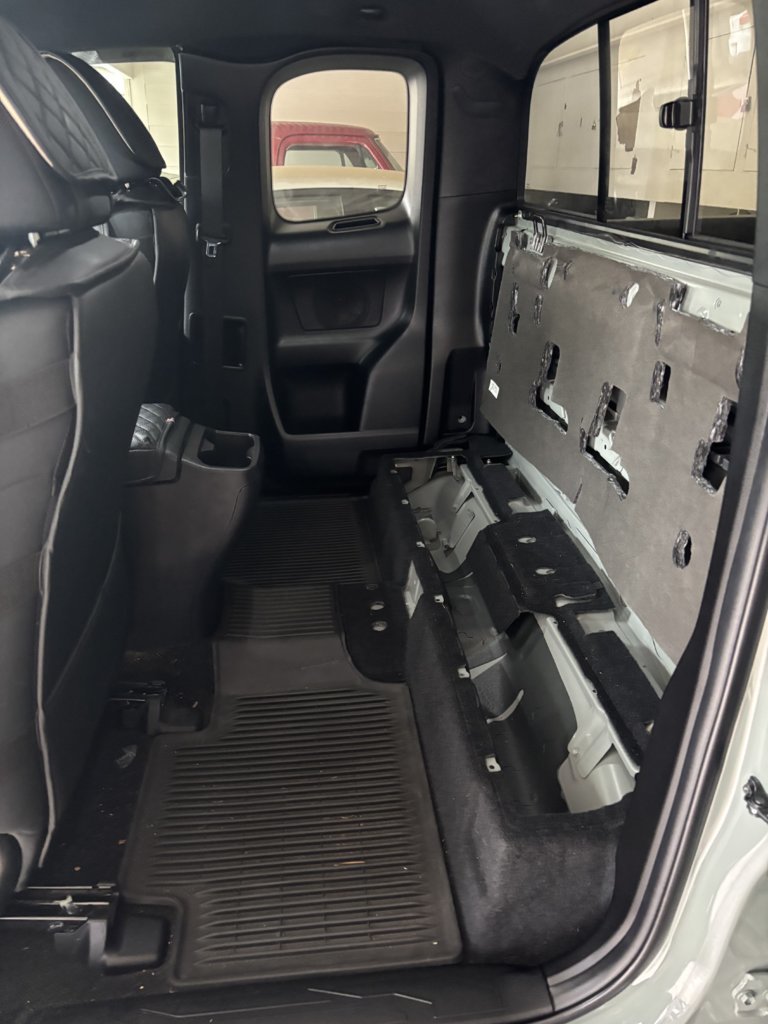

    Can you remove the rear seats without having to peel back the entire rear panel? I realize I need to peel back the panel for the headrests, but haven't found a definitive answer for just the seat portions.
  9. Feb 23, 2024 at 2:35 PM
    #109
    Thompson486
    Thompson486 Well-Known Member
    Feb 23, 2018
    #245340
    285
    Sherwood Park, AB
    2022 AC Off-Road Blue Crush
    Absolutely you can.
    I removed one seat and then decided to remove the headrest. Seat portion was easy. Headrest I had to remove one half of the back portion to access the bolts for the headrest.
    czukie[QUOTED] likes this.
  10. Feb 23, 2024 at 2:37 PM
    #110
    Plaintaco
    Mar 4, 2013
    #98992
    50
    Houston, TX
    Yes. I was able to remove my headrests by just pulling the top part of the rear wall panel loose. It’s a bit tight to get a wrench down in there. I dropped a bolt. But I was able to retrieve it with a mechanic’s magnet.

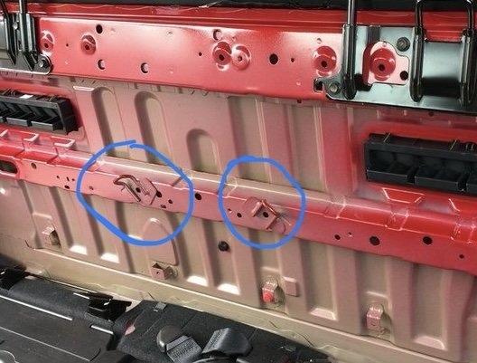

    Another member and I loosely used this thread as a reference today to do a full swap between a 2021 SR and 2022 TRD off-road.
    The only difference that we found between the two models was there were no angled car seat brackets in the SR. There are still brackets under the headrest and under the seat to attach a child seat, as well as the seatbelt that goes from the pillar to the floor.
    I marked up one of the pics from the beginning of this thread to show what we did not find in the SR.
