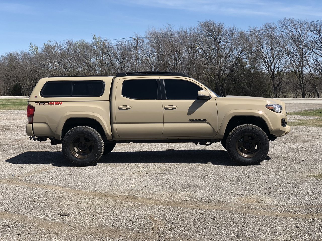

    Ok, that looks like an OEM roof rack. When I installed mine, I hade to remove these rubber strips that fill the channels on each side. They run the full length front to back. When you remove your rack, these channels will be exposed as well as the screw holes the rack mounts to.
    If you remove the rack, you’ll have to replace those rubber channel strips. You may be able to find some on here from a member that installed a rack.

    Just to clarify, they're not just rails. The "rail" portions swing across to the other side providing a roof rack with two cross members.

    What lift are u running on it and tire size? Looks good

    it is a tuff country uniball 4 inch lift. Basically a spacer lift with an aftermarket upper control arm. I actually just ordered toytec boss coilovers to change out the spacers. The tires are 275/70/18s.

    There are no huge holes under the oem rack. They are factory bolt holes and all tacos have them. Like people said above you can replace it easily with 2 factory rubber channel strips.

    Looks like you’re missing the actual racks anyways
