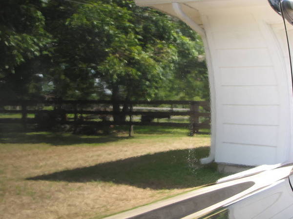

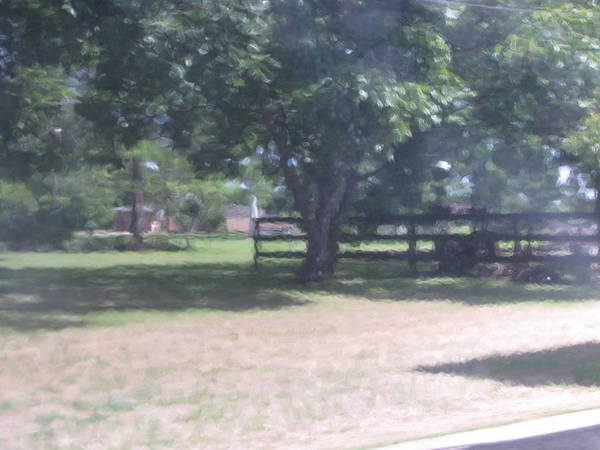

    Now the best I can tell this stuff is a light abrasive and kinda sands down the clear coat untill the sharp edges in the scratch round out and blend in much better. I don't think that you can ever fully get it to disappear but I got mine extremely close. I have a hard time finding exactly where they were.
    I have some before and after pics.

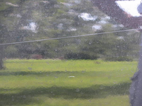

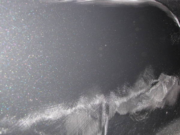

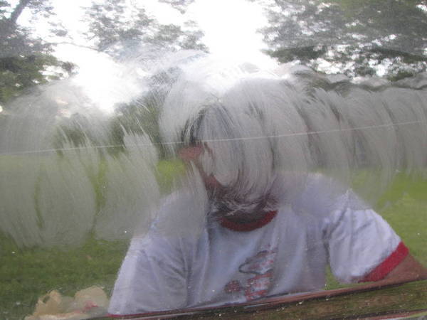

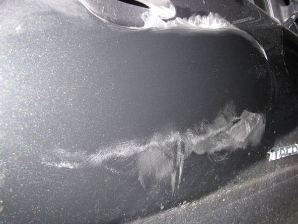

    This one is from going mudding and was pretty deep and noticeable.
    Before:
    It just turned in to little low spots in the clear coat that nobody in their right mind could notice
    After:

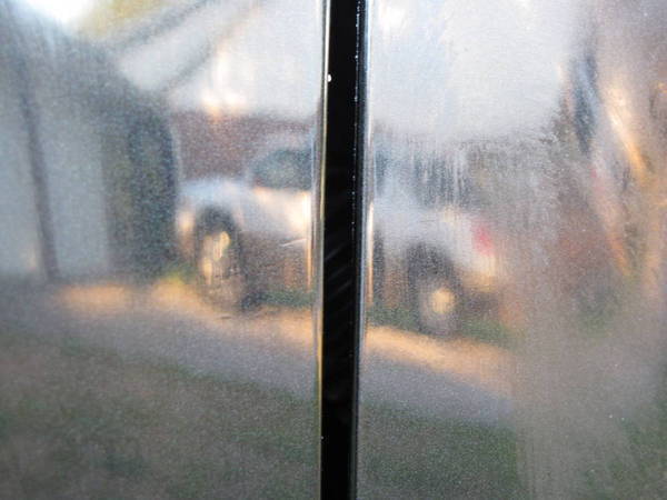

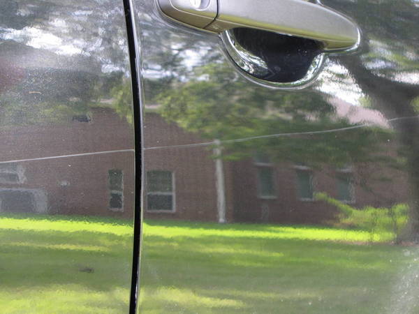

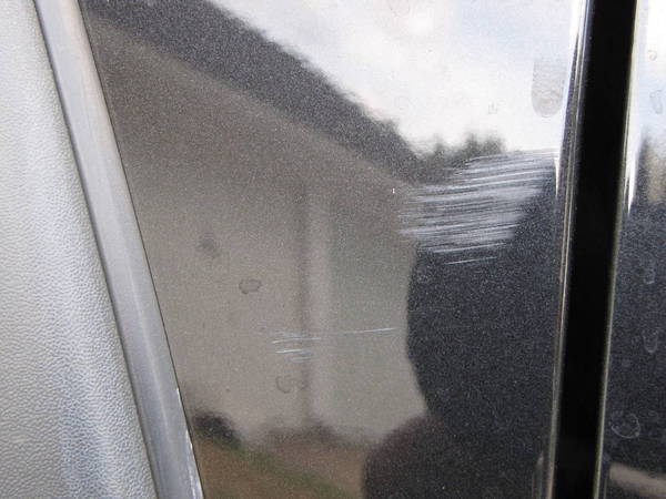

    This one starts at the back of the cab and goes almost to the mirror, but it isn't deep at all just long.
    Before:
    It is gone to the naked eye you can't see it without a very close up look. If I catch it in the right light I can see it but someone looking at the truck would never notice.
    After:
    Ignore the line at the top of the pic it is a power line not a scratch

    when the car gets dirty and the wax starts fading, will the area that was fixed using meguiars start hazing up?:
  13. Feb 20, 2010 at 10:07 PM
    topgun155
    topgun155 [OP] Well-Known Member
    Dec 18, 2008
    #11728
    2,767
    Zack
    Richmond, TX or College Station, TX
    08 Prerunner V6 Black
    Viper Alarm, In Pro Car Wear L.E.D. Tail Lights, Fog Lights, ScanGuageII, AvidOffroad Light Bar, Ammo Box Mod, Tailgate Theft Prevention Mod, Satoshi Grill, Hella 500ff behind the grill, blendmount, Cruise Control Mod, Fog Light Mod, 5100's @1.75, Toytec TSB AAL 1.5".
    No. It looks perfectly normal.
    The haze in the pictures is just leftover scratch x that I didn't wipe off.
