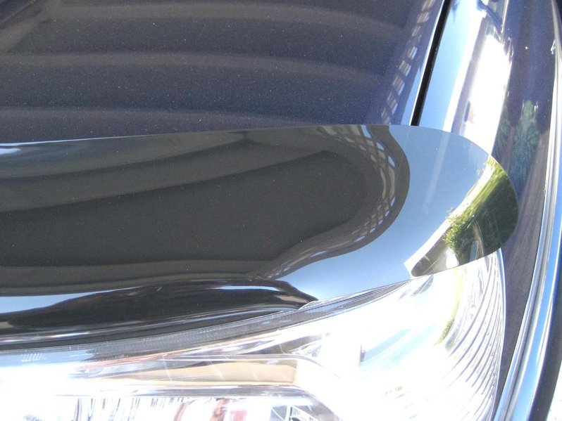

    I really like my new AVS Bugflector II, but it has a distracting white logo that looks like bird splatter. Here's a way I found to remove it. There are probably many ways; this method worked extremely well for me. Also, I take no responsibility for any damage that may occur. The logo is painted on with white paint. Use a very small amount of lacquer thinner on an old t-shirt and gently rub the paint away. Keep applying the thinner on a new section of the t-shirt and gently wipe until all the white paint is removed. This will leave the plastic dull. Apply some automotive clearcoat polish to the dull area, gently rubbing in a back and forth motion. Let it dry to a haze, and buff off the polish. Do this twice. The plastic will be restored and be shiny again. I can't tell the difference now that there was ever a logo there. It looks so much better.:proposetoast:

    nice tip. got a pic of the after shot?

    Here is an "after" pic. Just like new, and no white logo.

    Nice, I will be doing this tomorrow. I put on an AVS shield today and was immediately bothered by the emblem. I didnt think there would be a solution here so I google searched it and it brought me right back to this site. That painted emblem irritates me. Its not enough that I buy your product. Why the hell do I have to advertise for you too??

    While I agree I hate the bug defelctors, I did try one on my first '08 taco for a few months. The AVS logo annoyed me too... I just used my finger nails to scrape it off though lol...

    Well done! You cant tell it was ever there!

    I did this today. Worked awesome. Thinner took the emblem right off and the wax shined it back up.....

    A little goof off did the job and waxed afterwards.
