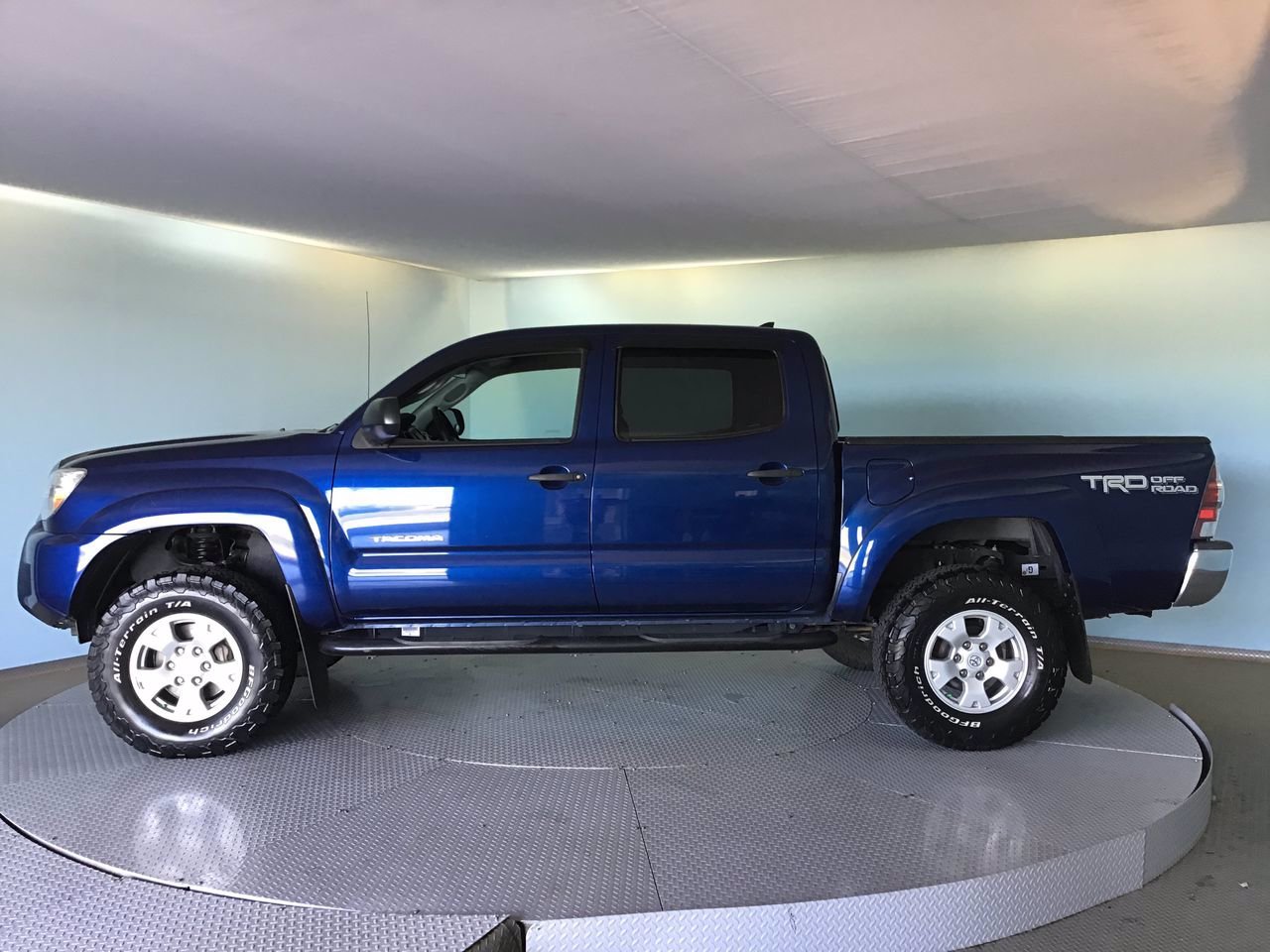

    I got another question, this time regarding the lift. I don't know much about them. I was told it has a 3" lift, but that's it. Is it possible to tell from this photo what type of lift it has? A suspension? Spacers?

    Congrats! Hard to tell, but from the pictures it looks like the front has a spacer lift. You'd really need closer up pictures to be sure.

    Nice looking truck. I do see stickers on the frame, meaning it's either new, or it's never lived in salt country. That's a good thing.

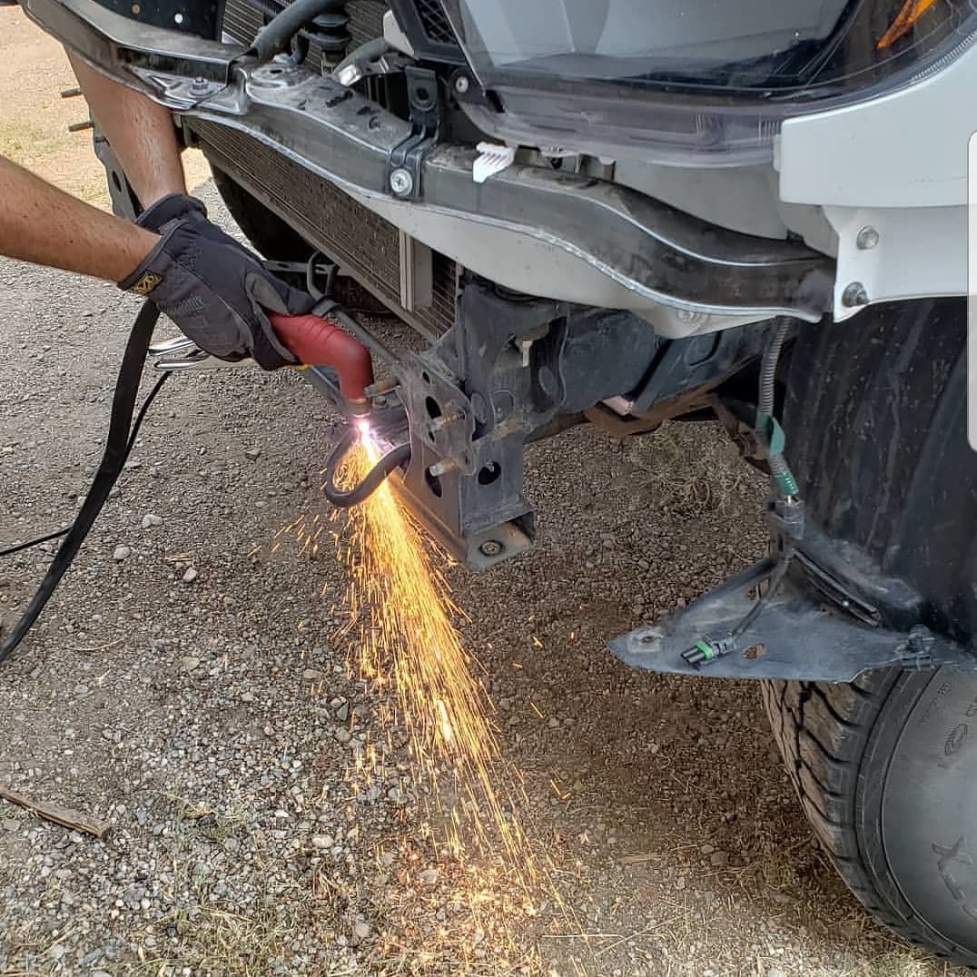

    And part of the frame (the tiedown loop):

    Spacers in the front. Rear is very likely lift blocks in that case. Truck looks pretty tidy, so it's been loved by someone.

    Usually Id agree, but this truck looks like someone added it for marginal utility. The rest of the truck looks too clean to be a offroad beater. Usually the back corner of lower front valence where it meets the front fenders will start to gap from the tires rubbing if you stuff them even semi-often.

    That truck sure looks suspiciously clean for a late 2nd gen. Clean frame with sticker and not even a rock chip on the plastic front bumper cover. OP, how many miles does this tacoma have? Look for any repaint of truck and undercarriage.
