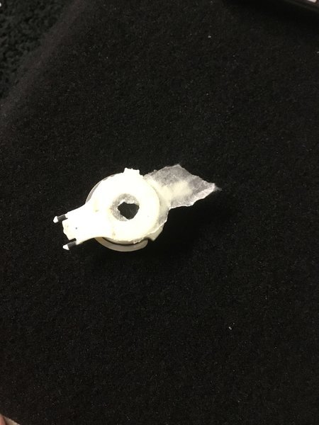

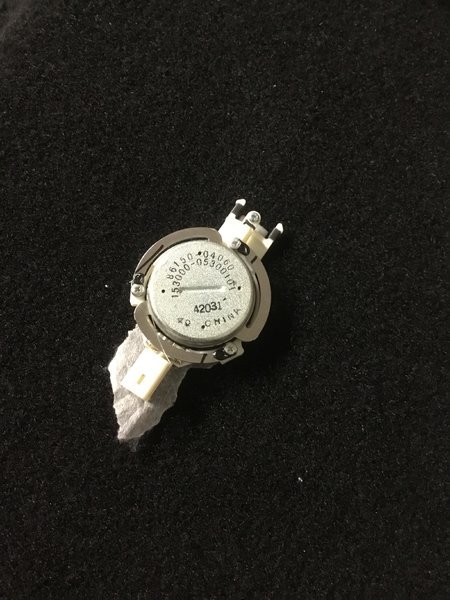

    Any Access Cab owners replace the pathetic ceiling "speakers" while the headliner was down? Any photos/measurements of what fits up there?

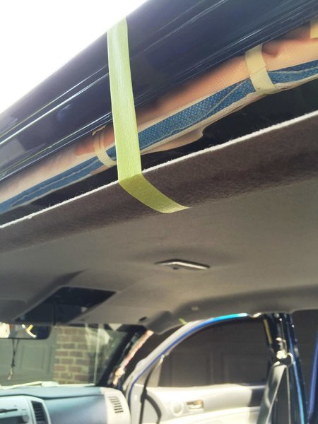

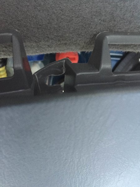

    This was the last step in my deadening project and I finished this off yesterday afternoon. This is the 2nd vehicle I've deadened, and it still sucks to remove all the panels and stick this crap in place. BUT....it works. Anyway, lots of good info in this thread and thought I'd add one more picture to it for anyone who is removing the B pillars.
    Once you pop off the lower half of the B-Pillar, you'll have access to the 2 bolts at the bottom of the upper trim piece. No picture necessary for those. You can't miss them. After you remove them you can work on getting this thing off. Unlike most panels, it doesn't pull straight off. There are 2 hinges at the very top, and one more trim panel fastener holding it in. You'll see which end is open and slide it out. Don't just pull. or maybe you can just pull and snap the fastener, but I'd just slide it. Then pull the fastener out with needle nose and break it that way before reinstalling with half the clip in tact ;)
    The red fastener in the background is what the panel attaches to. You can see the open end in the foreground as well as the two pieces where it hinges. Hope it helps.
    And for anyone doing this on their own, if you need assistance holding up the headliner when it comes time to reinstall everything; use some 3m tape. Make sure you pull it off from the inside out though when you're done.

    That's the speaker in the back roof its maybe 2" x 1/2". It's glue to headliner. If you go to post #69 and look at picture 6 , picture 9 the white plastic with the squares is what fills the voids. Might get a 3" or 4" in there . Could take that stuff out and glass it . And fit something bigger. But it would be surface mount.
    Norton[QUOTED] likes this.

    Great info! Thanks! (No wonder they sound horrible. Rhetorical question to Toyota: Why?!?)
