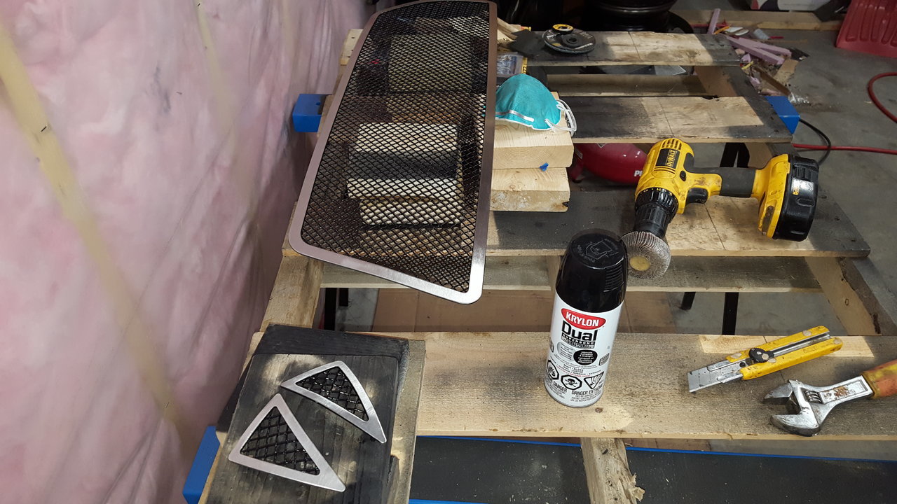

    Looking at the picture, I remember now I actually used a sanding flap wheel meant for a drill.
    First I wire wheeled the mesh section with a 4" angle grinder, then sanded the lip with the flap wheel, which gave me a brushed steel texture. I taped off the lip and painted the mesh portion
