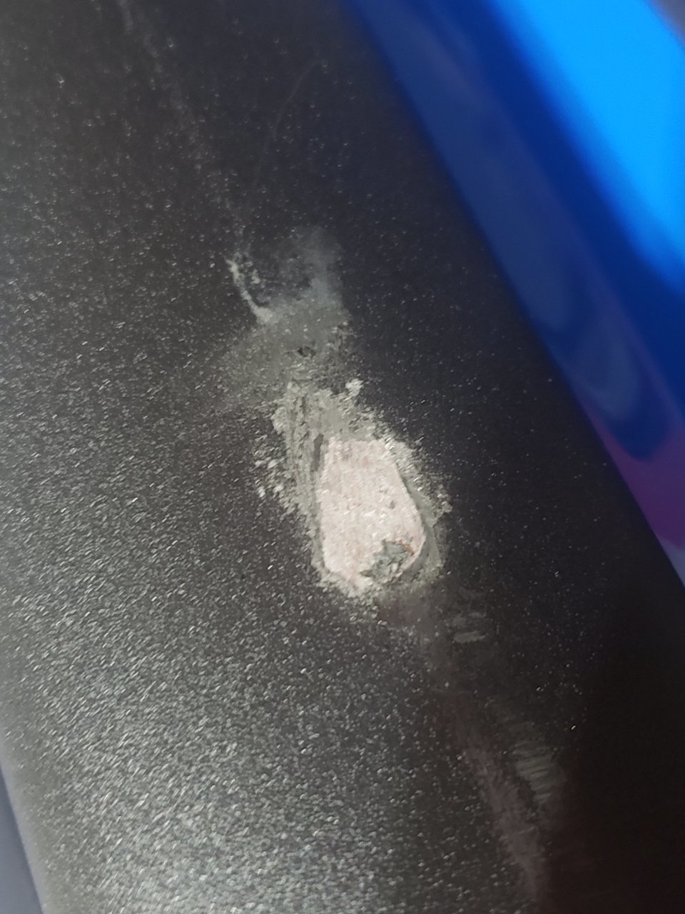

    Can anyone tell me what to use to repair the paint/coating on the factory roof rack cross bars?
    I went on a long road trip and wore a few spots of the cross bars down to the metal.
    Thanks!

    I would try SEM Trim Paint, it is excellent for matching Black Trim on vehicles.

    Or just get a touch up paint bottle. It's probably gonna get beat up in the coming years anyway

    Texture black spray paint is a perfect match for the bed header rail, so It should match that too.

    I would see if your local Line-X shop can blast them for cheap. It would be nothing to throw them in the booth when they do a truck and will hold up much longer!

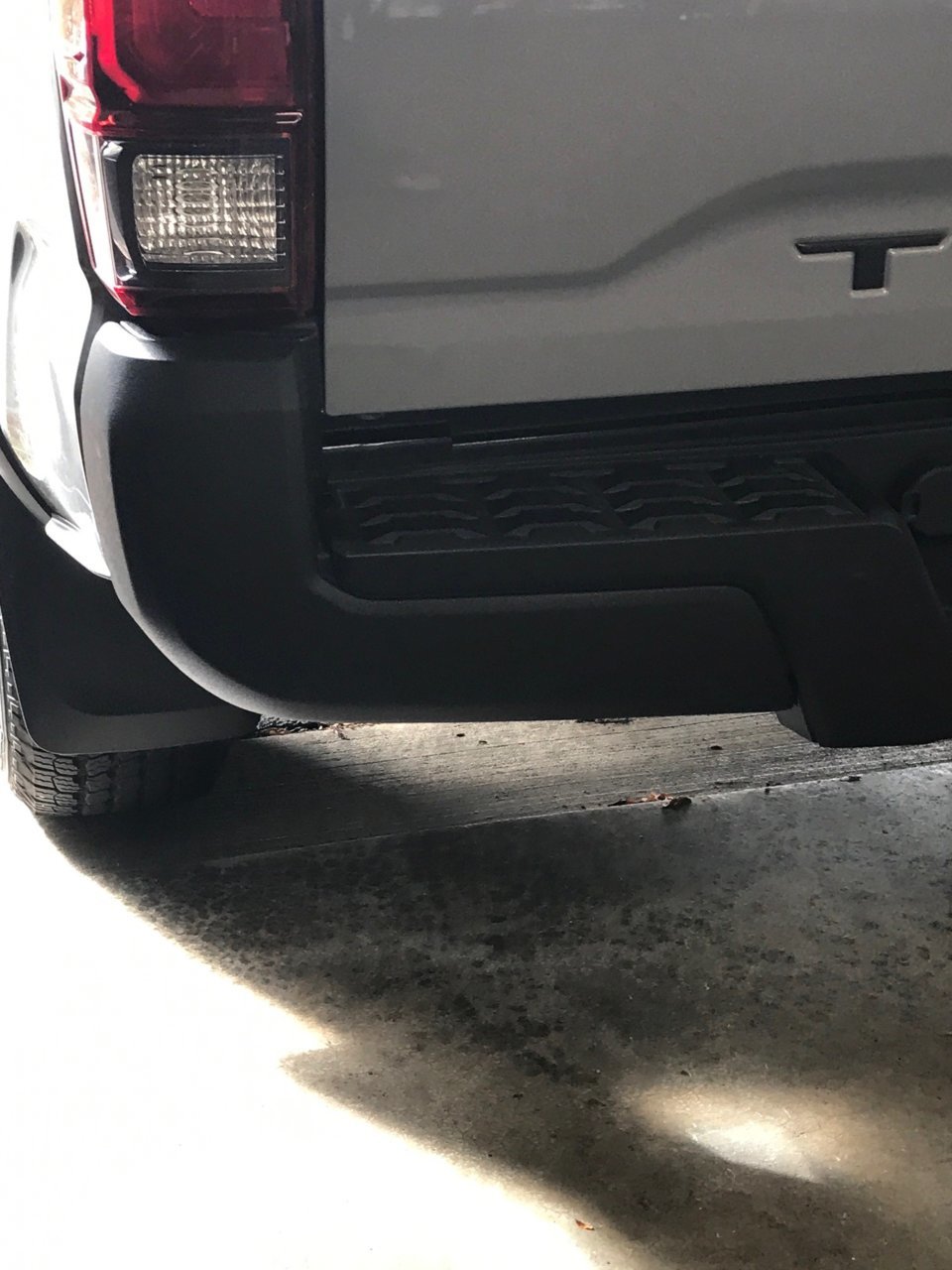

    I used Rustoleum bed liner on my bumper caps and matched the texture of the middle plastic bumper section perfect. Should hold up pretty well and its cheap.
