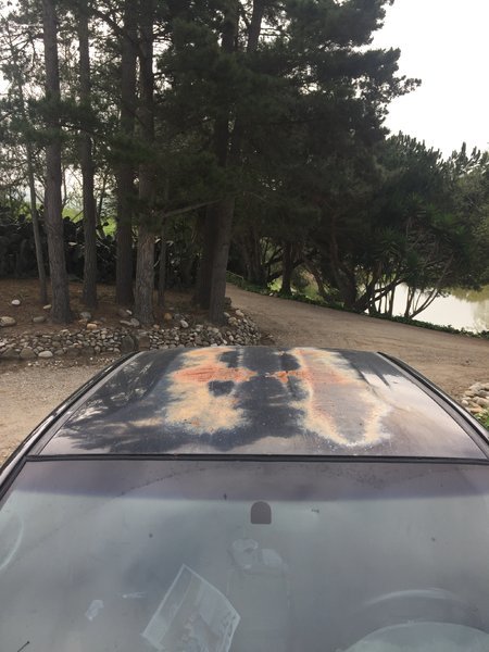

    I have a 2006 Tacoma that has the dreaded peeling/rusting roof. I was wondering if anyone has any advice or tips for doing the repairs on my own. I have never painted any vehicles so it will be new to me. I'm guessing it will simply need to be sanded down and sprayed. I will do my best to post some pictures tomorrow.

    Holy shit that's the worst tacoma roof I've ever seen. Once you get that sorted out do some regular paint care/wax

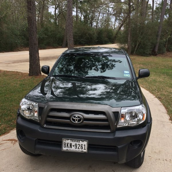

    Heres a before and after of mine. I took it to get the roof and hood painted a few months back because it was starting to rust.
    Cost was around 400 altogether if i remember correctly
    Edited to add: turns out, it was december of '15 when i had it repainted. That made the truck 6yrs old when the clear was already peeling off the roof

    What pisses me of is that all the peeling/rusted roofs all have the same pattern. Long uniform strips running down the length of the roof. It's like a step was missed from the factory or something. Whats funky too how there is an acute rusted zig-zag pattern that can be seen running down the length of the strips... Whats up with that?
  14. Mar 16, 2017 at 11:49 AM
    BassAckwards
    BassAckwards Well-Known Member
    May 3, 2016
    #186002
    27,643
    AWD Turbo 2TR-FE
    Its almost like they didnt put the same amount of clear coat down on those certain areas on the roof as the rest of the areas. Its strange for sure. Its probably one of the only problems ive had with this truck so far

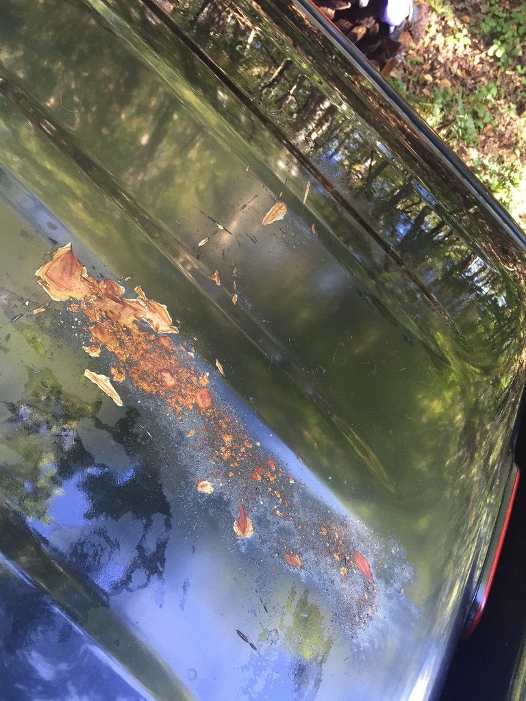

    Me too! Black 2006 Tacoma. Thank God I hand washed it today instead of the drivethrough. I never look on the roof. Man I'm pissed. I've driven way older vehicles than this, one of them black, with never any paint issue. Just like the other posts, tiny scratches all over!!!!! What the hell????
    So it sounds like this is best left to the pros. I don't have a paint booth or a sprayer or any of that stuff. What's the max I should expect to pay?

    I personally paid only 400 for the hood and the roof to be repainted, but they only sanded it down and they did not chemical strip it. Its still good a couple years later, but with painting, the quality is all in the prep work so i wouldnt mind paying 600 (for hood and roof) or so to have them strip it down and repaint it with some type of included warranty. Either way, if you get it repainted youre much better off than having the thin metal on the roof to start rusting through and causing you problems
