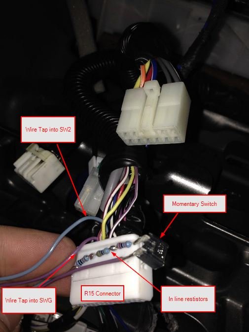

    I finished adding a voice switch to the steering wheel control. I'm not sure why toyota decided not to support voice commands on the stock unit but the 2014 nav unit I swapped in its place does.
    There are two basic ways you could add the voice switch. The easiest way will allow you to mount the button anyway on the dash or where ever you see fit.
    Using this steering wheel circuit, just added a switch with an inline resistance that ranges from 3,178 ohms to 3,242 ohms and tapped into the SW2 wire and SWG wire from the back of the stereo.
    e549b143-f78c-47d5-b860-15d651273c37_zps_13be0f983ee1d740d3b5a52b4174f7922610f4f0.jpg
    2014-03-0210_06_42-80444A32-F360-4AAF-B8_09af4861b6ce8c117fb83c3b08fb8f580760b943.jpg
    I only did this to confirm that it does work. You can use any momentary switch. After I tested this first method out I decided I was going to try and install the switch on the steering wheel.

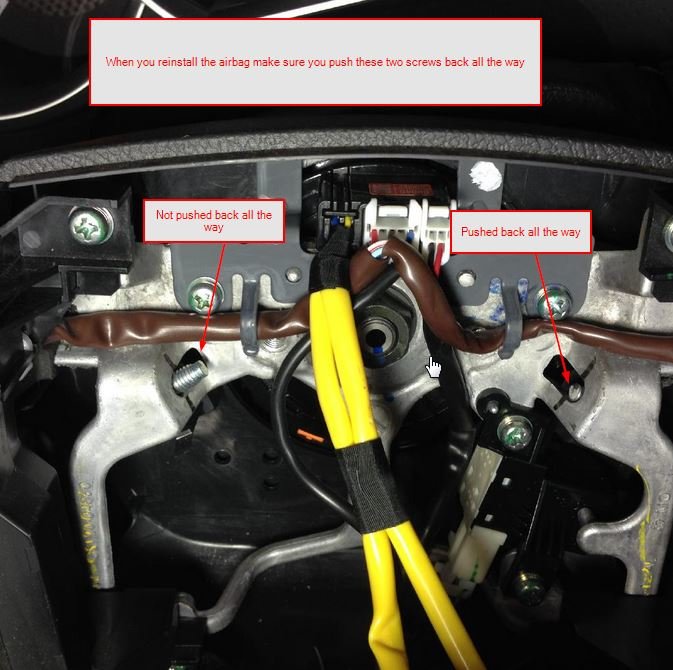

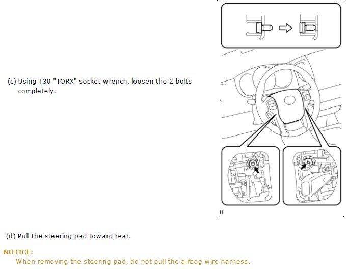

    First I disconnected the battery ground since I was going to be working around the Airbag. Then I followed these steps:

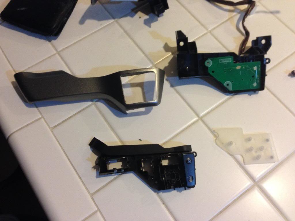

    I did not have to disconnect the airbag I only carefully set it onto of the steering column. Next, I removed switches then disassembled them:
    EB7219C3-461D-4CB8-9E75-1DF03045EE90_zps_4fcc4b531293ca07697ce98e0e29582ccd4ef80c.jpg

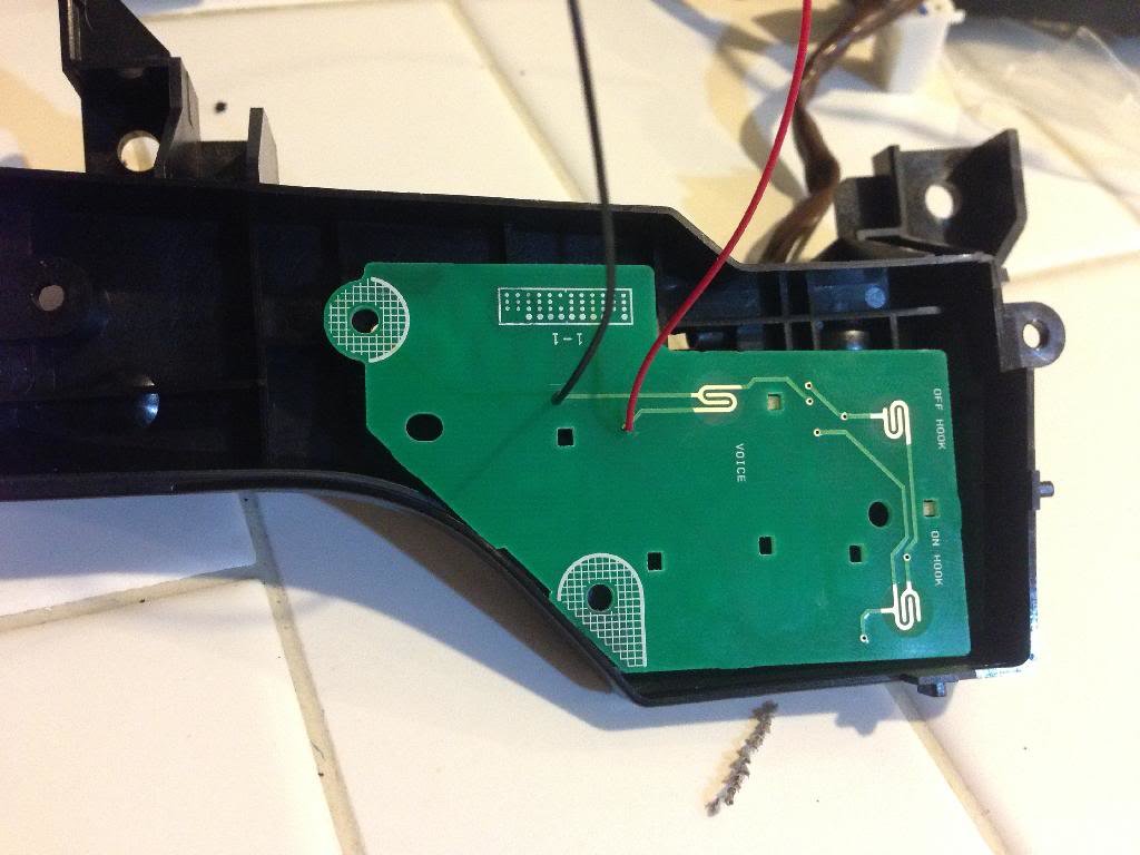

    If you look at the circuit board you can actually see the contacts for the voice switch. I soldered wire leads as shown bellow.
    C6FCAA83-42DB-4FBA-A9B1-93CE8B8400AB_zps_3d11439e2ae095d80052551a7ba414242db7b057.jpg

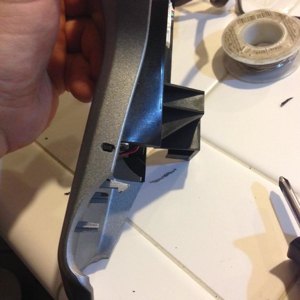

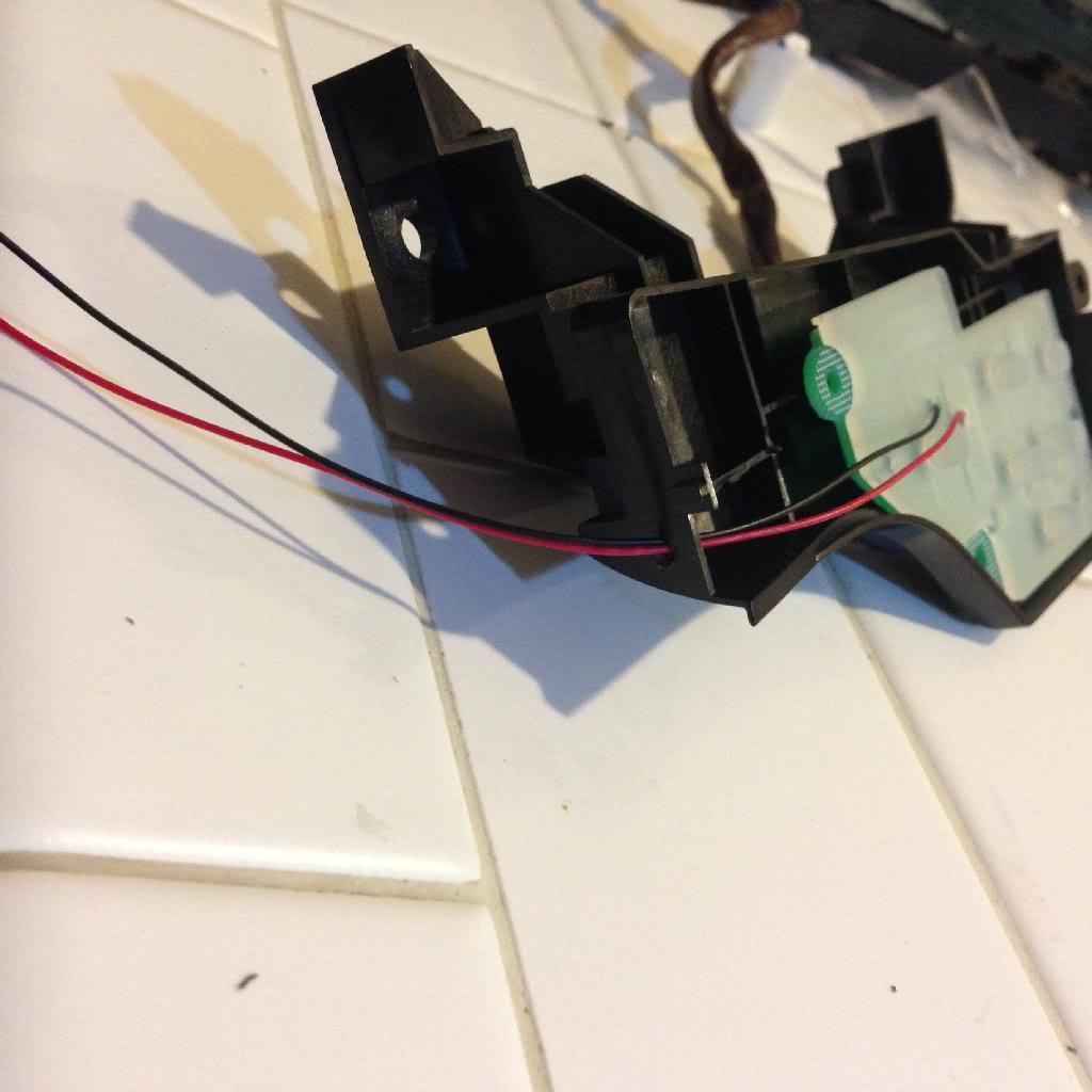

    Then I had to cut two little hole in the rubber contact pad to allow the wires leads to poke through. Also drilled a hole in the back part of the assembly to run the wire to the switch. Note: I only needed to wire a switch to the voice leads on the circuit board. The resistors are already part of the circuit board.
    1E357F96-DF25-4D06-9026-E962CF9E3D2F_zps_5f253b0cdee54c7d39ee5ae680aeac9b8fae0277.jpg

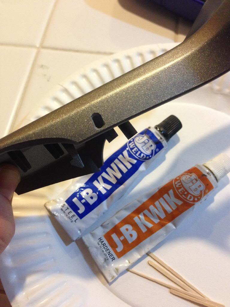

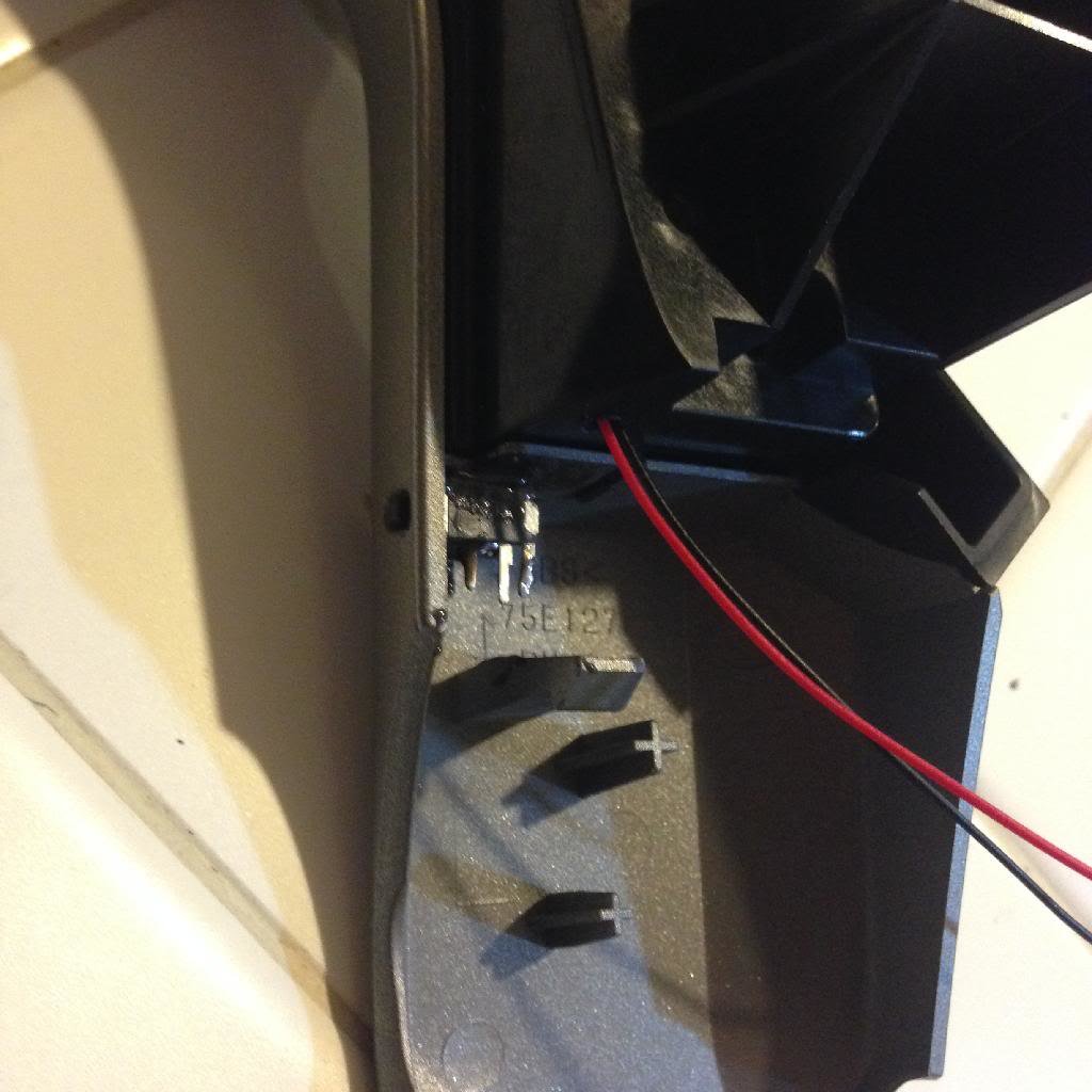

    This next part is why I wouldn't recommend this method. I cut a very small whole in the assembly cover for the switch to be mounted to.
    8AAB7507-BE6D-49DB-A87A-E3CE3E7CE9A8_zps_6385799e8446dd1b8aa3b8f634574a5e6e6e83d3.jpg
    Then using JB weld I epoxied the switch in place and connected the wires.
    FFD1E82E-40DE-4540-BB49-B17FE7328B79_zps_b260e06ed3ee14a289b686565e11c65c2472de87.jpg
    B11631F3-C996-4229-B1F4-C819ADA6FA99_zps_0702860c80fa0a756a4b0339f56963e11b729670.jpg

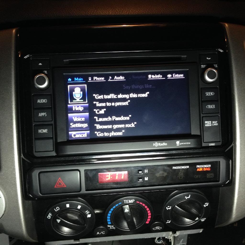

    Here is a shot of the voice control switch working with the stereo after the install.
    FA7893A8-67D1-436F-BBA4-BAC6638C7E1E_zps_f580017be0629352a256db7ec9c4967f19bee076.jpg

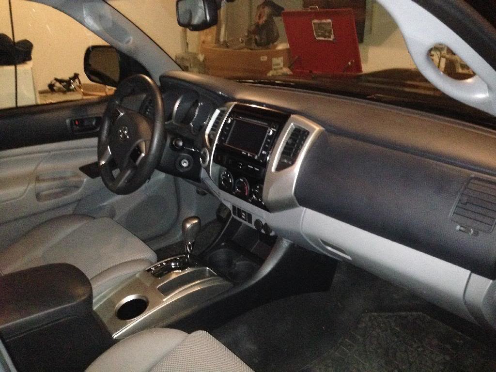

    Hey, Sorry I have been meaning to say thanks for the parts. I got everything in the mail a while back. I had to clean up the USB port a little. I can see why you can't sell any electronics off those trucks now. Anyways, I got it put back together. The usb and Aux jack are working good, and thanks to FLTrucks good deal on a 2014 Nav unit, I'd say the truck is better then it was before all of this.
