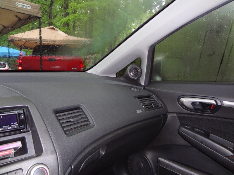

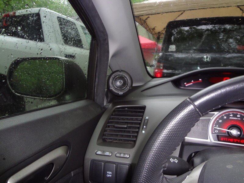

    I'm redoing these below with scanspeak D3004 tweeters and 10F mids so I can relate. I've almost decided just a strong 2-way for the Taco. Here's another idea... Illusion Audio C3CX point source 2-way in the pillars. That'd be a crazy good frontstage. fa47f1dcb6476c20c421bd7c3fc7812d_af021537dcf4375c7bc3b968a43f7c9b22ca44bb.jpg29c5499bd6ca6f030dfd187a7e3045aa_0e4b4e4f60e8b6096e9c002d9b130a4cac19c917.jpg

    I've heard them recently at the NCSQ meet. They'll belt it out just fine IMO. They hung well in "Captainobvious's" wife's Corolla. No output issues whatsoever. It's all about the crossover points I believe. About 300hz to 3.5Khz and they'll scream. In a good way. I was sold after demo'ing that car. Silly clean and flat too.

    That said though. I suspect they might not fair so well in door free air. Probably 400hz better. IF they fit. Plus they're a little big for the grill there which was my concern. However, small enough maybe for the pillars. :)

    I am going to flush mount the mids on the door card instead of under it. Plenty of room. Tweeters in/on the A's.
