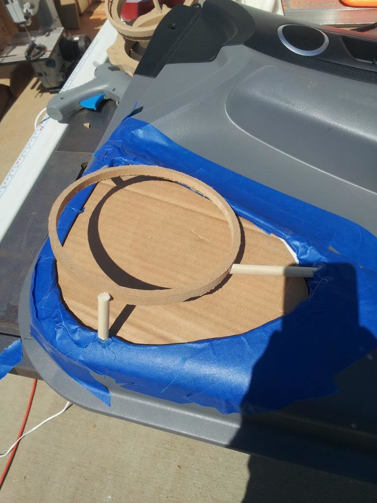

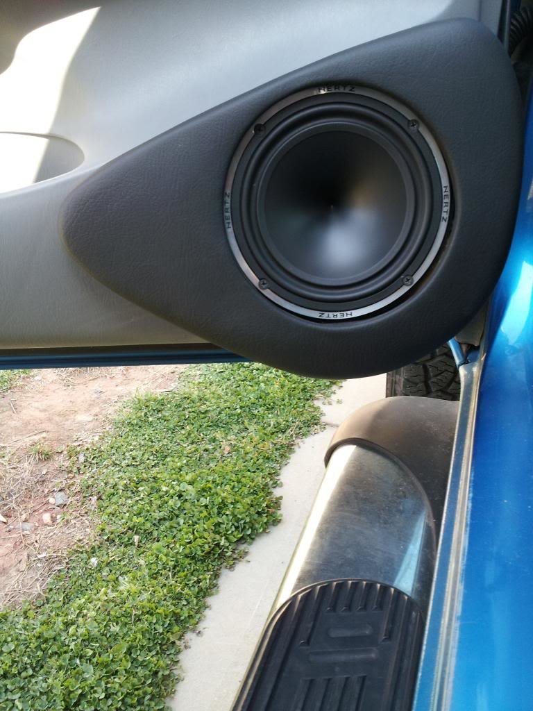

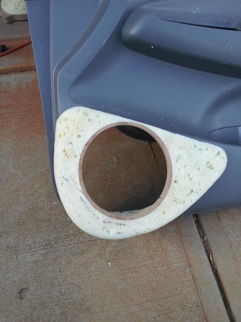

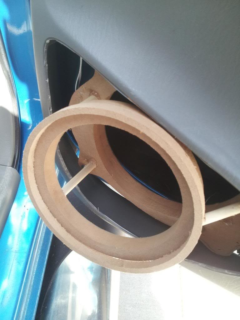

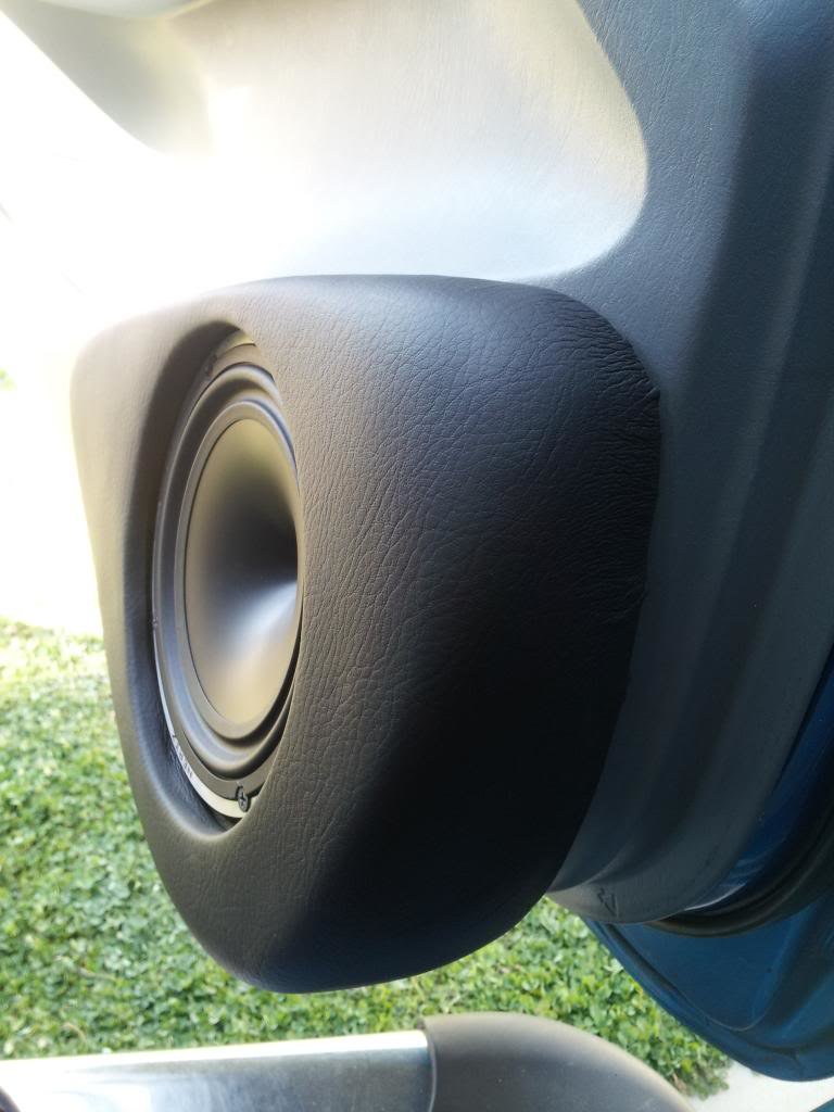

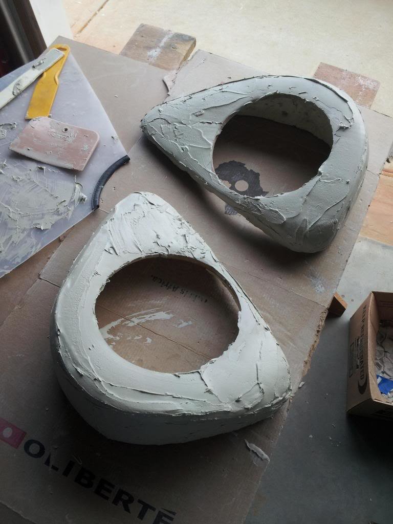

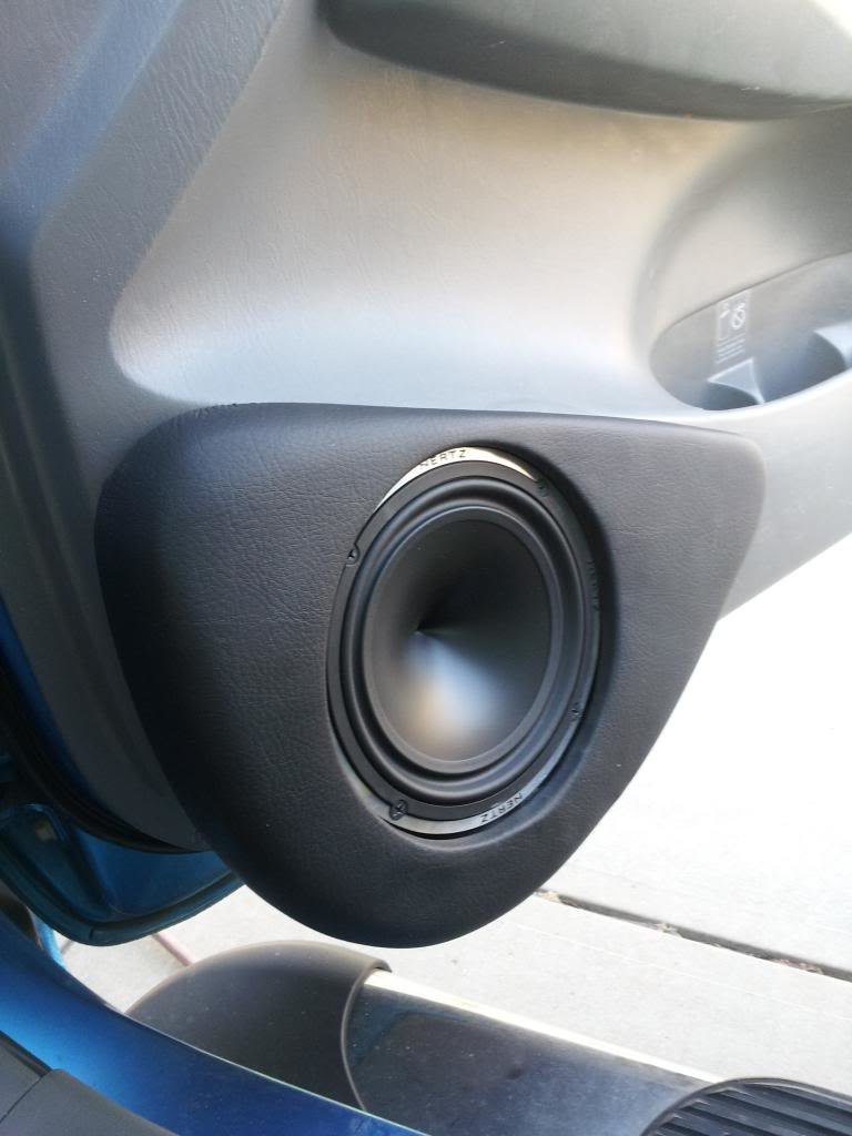

    I took a leap and decided to custom make some door mounts for this install. Being a novice in every aspect, I feel the results were better than expected. The end result is one of both satisfaction and humility. I really learned a lot.

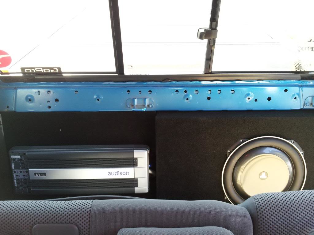

    I have abandoned my previous set up for a set of Hertz Mille components run active and powered by an Audison LRX 5.1K.
    I have to say, and being a huge fan of Focal, the difference is night and day. The pure power handling of the Hertz alone is astounding. The crisp and clean highs and powerful midbass produced from the LRX match up very nice with the only remnant from the previous install, a JL 13TW5.
    This is also posted up on DIYMA. I highly recommend perusing that site for tips and knowledge seeking. The majority of guys over there have some great input.
    Thank you for taking a look. Please feel free to criticize constructively.

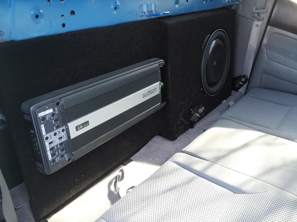

    Audison LRX 5.1K and JL13TW5 (Before clean up! [​IMG]) Still kicking around ideas to trim in the surround.

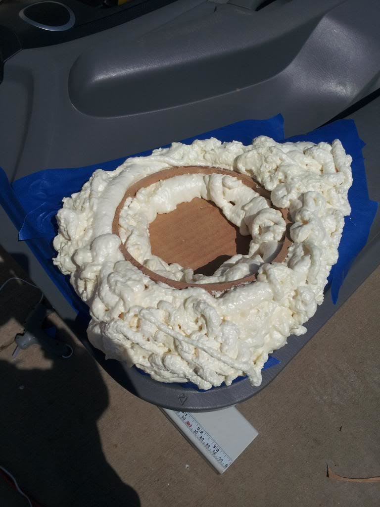

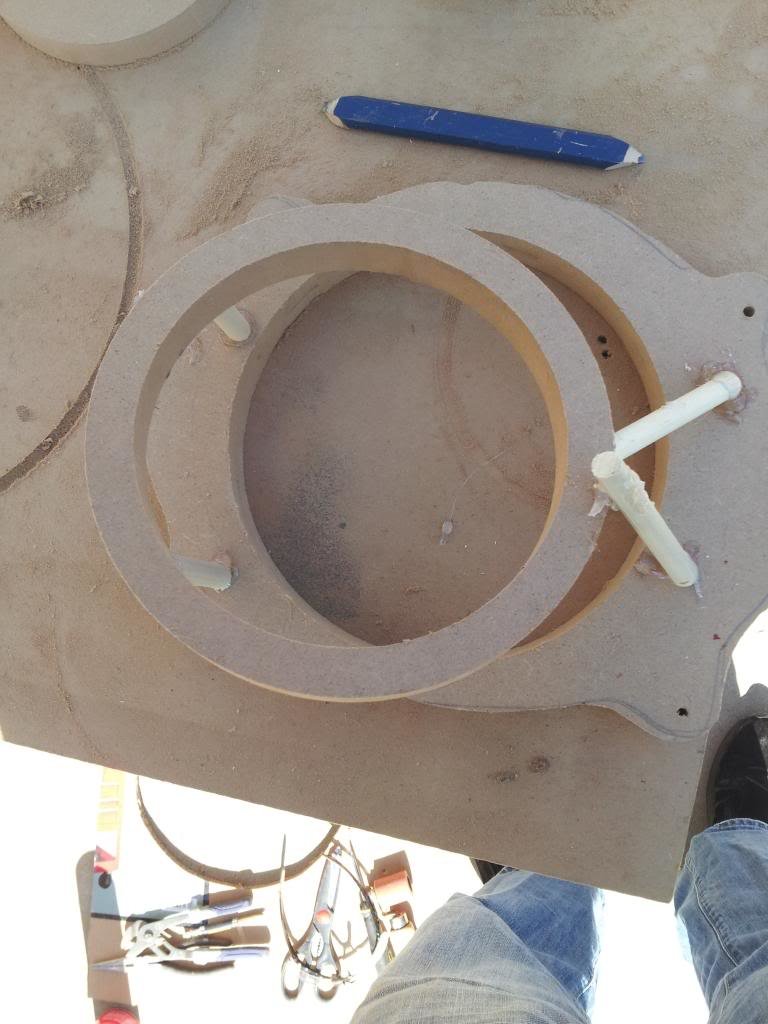

    "Custom" door mounts.
    Point of no return.

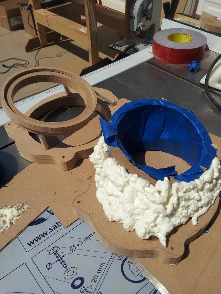

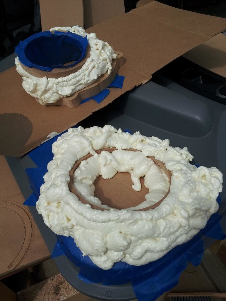

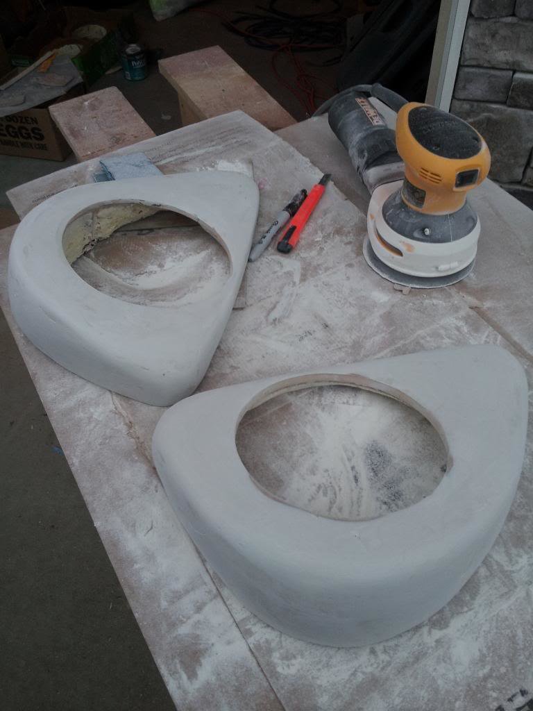

    FOAM, Trimming, Bondo, Vinyl

    Excellent job! As I was first scrolling down your post I was thinking omg why did this idiot cut up his door panels like that and what on earth are those weak ass post looking deals on his baffles.
    Of course a few pics later and my wife was right, I'm once again proven a fucktard to the core!
    Excellent job! I just might do this for my cheap polk db's to fatten the fucktard appellation! Thanks again!

    One suggestion I would make is to cut the ends of the covering fabric/leather when stretching and it wont roll the edges at corners.

    I should have cut reliefs. But I was stretching them by myself and at 8 in the morning with a 12 1/2 drive to make that day, I kind of rushed them. A second pair of hands would have been great. I kept coming up with better alternative ideas for these as I was going along. The next set will be much better. All and all, I am very satisfied by my novice effort. ;)

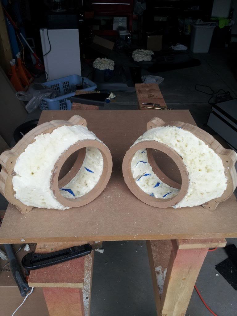

    Did you just use that same foam stuff you can fill holes in walls with found at home depot, lowes, etc? Like the can type stuff?
    How does it sound? Do you think its worth the effort sq / spl wise vs having them in baffles behind the door?

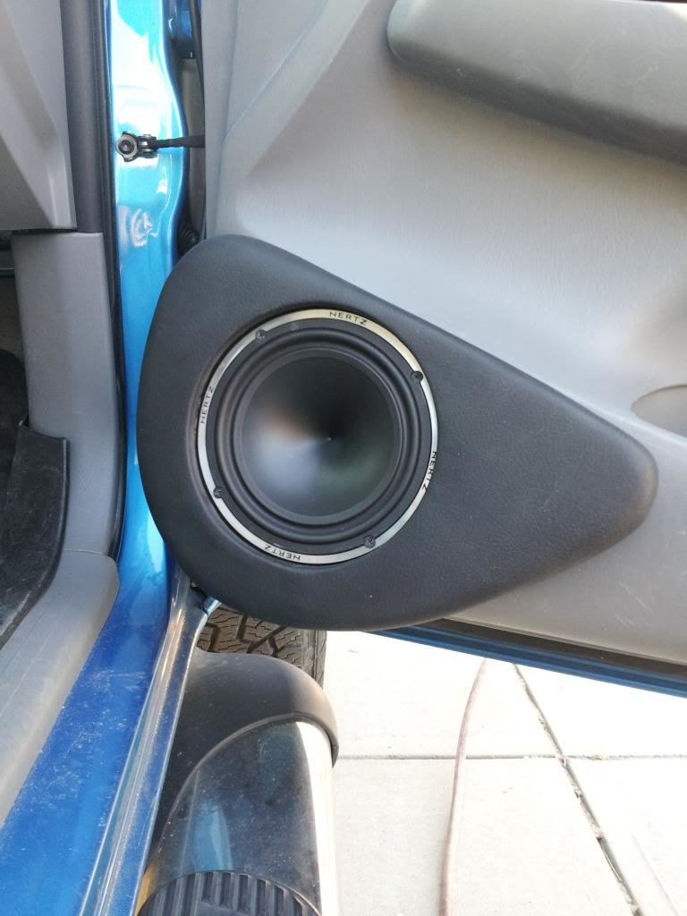

    I would still put a mesh protector over the speakers. Them being on the door "kick" panel should say it all.

    The foam was Great-Stuff insulation gap filler. It is readily available. I will go with another produt next time. It ended up very porous and I had to do two layers to solidify the base.
    As far as having them behind the door. Do you mean still behind the door card, the plastic part and mounted to the metal? If that is so, then yes. I believe it is worth it. I had previously deadened the whole truck, doors too. That is where you get the most measureable gain in sound. I didn't want to make pod on the card and waste the work I had already put in.
    Along with deadening and proper installation of the speakers to the door. I used CCF (closed cell foam) between the baffles I made and the speaker to the baffle. Essentially it turns the door into a speaker box. Well, as box like as a door can get.
    As far as upgrading. I only have opinions and you know how they are. I believe it all depends on budget. Really. If you are short, I would piece it together. Start with the source. A good HU will make anything smoother. Next, a clean power source from a good amp. There IS a difference. Then components, and finally the sub. Again My opinion. 60w RMS is just wasting your time on those speakers you have in mind. They are power hungry and you need to feed them.

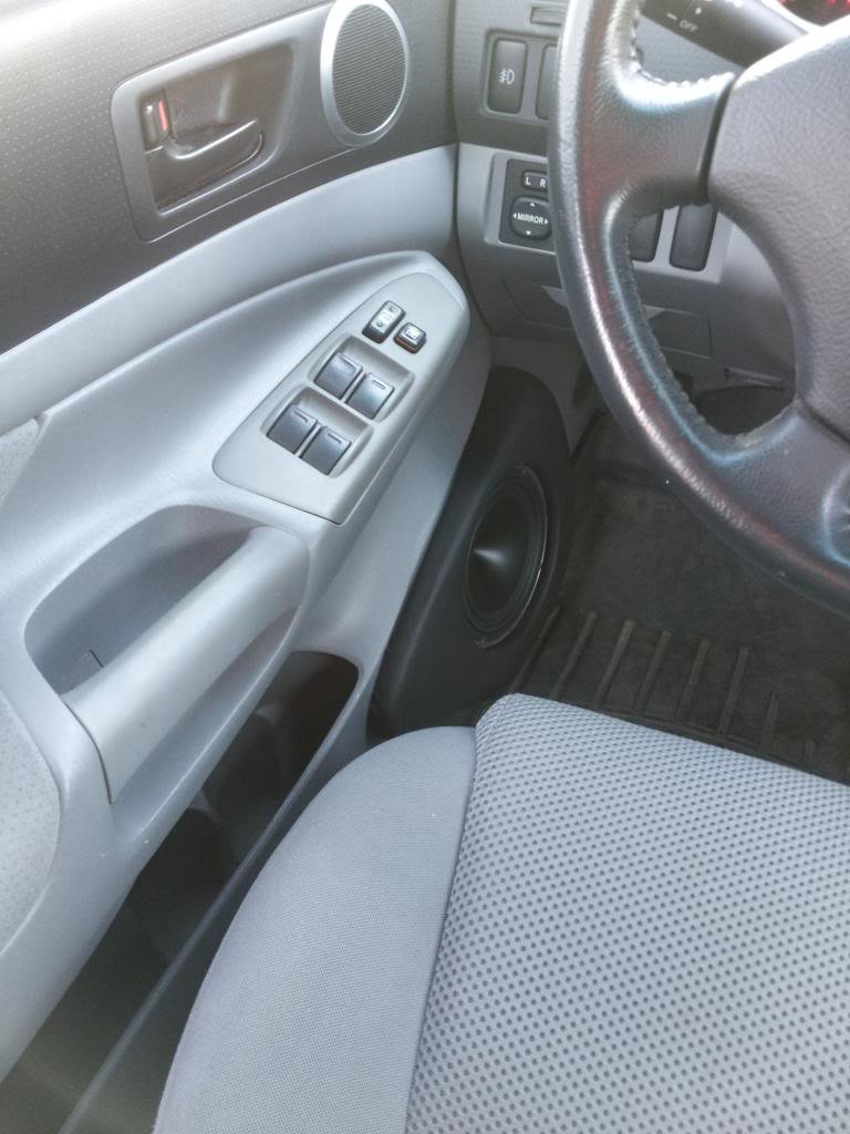

    I might do something to keep them safe. They are recessed 3/4" I am careful getting in and out. I damn sure make the passenger up front watch thier step.
    They are actually in the doors not the kick panels. There is no way I could drive and be comfortable with a set of speakers down there. They would get crushed no matter what I put over them. I angled these up some to try and bring the sound stage up a little from what I think is a very poor stock speaker location.
