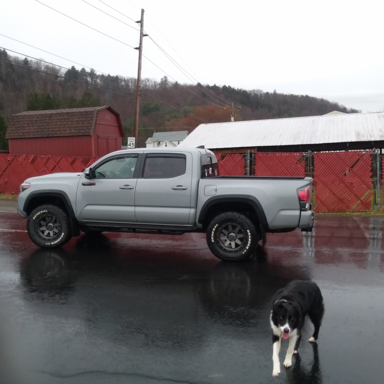

    i really like my grabbers.. nice smoothe ride and quiet,, 20200328_105838.jpg
