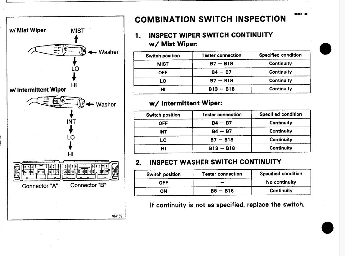

    Appears its all in the stalk but you lose the mist function for the interminent feature.
    semco-inc likes this.

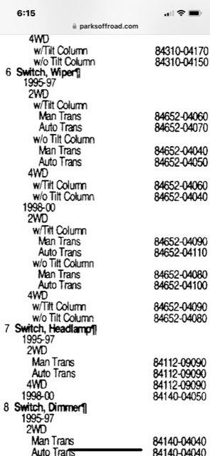

    I believe this is the PN for the 1995 wiper switch
    Wiper Switch
    ‎84652-04060
    if anyone can confirm or refute this, please advise.

    Ugh
    9 different part#’s

    Next step is to find out which one comes with intermittent setting
    Maybe the most expensive/option loaded model?

    I have 4WD w/tilt column so my previously quoted PN is the one listed in the parts catalog listing.
