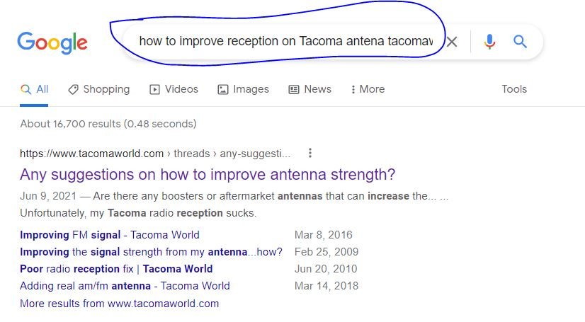

    Google "how to improve reception on tacoma tacomaworld.com
    bunch of hits but yes, most of us cut to shorten

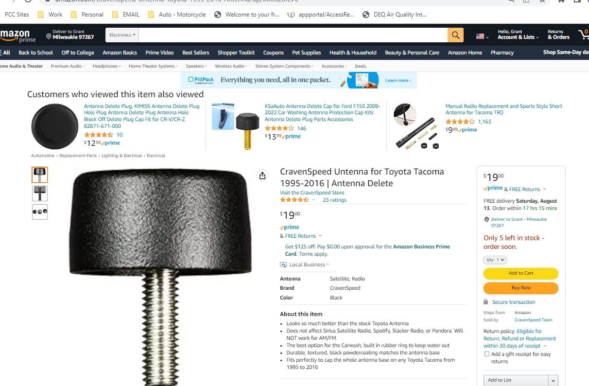

    @Sarra
    Sort of a delete... short of removing, plugging, prep-n-paint

    That is going in my cart, thank you very much. :3

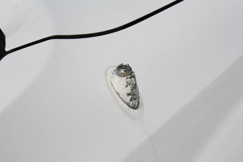

    Most large Boston FMs appear to have their antennas at 350 Cedar Street or 800 Boylston Street, so you would have been well within their coverage area.
    The Cape should be inside the reliable coverage area for the large Boston FMs, but it's near the edge.
    Somewhere on TacomaWorld, there are one or more discussions about cleaning up corrosion in the Tacoma antenna base. That could be your problem. Also make sure the antenna isn't loose.

    No FM stations either. Really surprised no one else has this issue or has found a solution.

    It’s probably the base and NOT the antenna. It corrodes and causes poor reception.

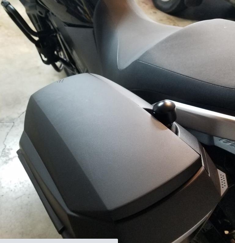

    How about a PVC end cap, shot to the color of choice, with a bolt epoxied on the inside... I do MacGyver crap like that.
    Did the above on my MC side cases. JB welded a key in each.

    I ahve one of those sitting in front of me right now, and it doesn't fit. The threads are either too small (slides straight in), or it's not long enough. Either way, I drop it in, it falls as far as it can go, twist it, and it just spins freely. Gonna have to see about getting a refund.
