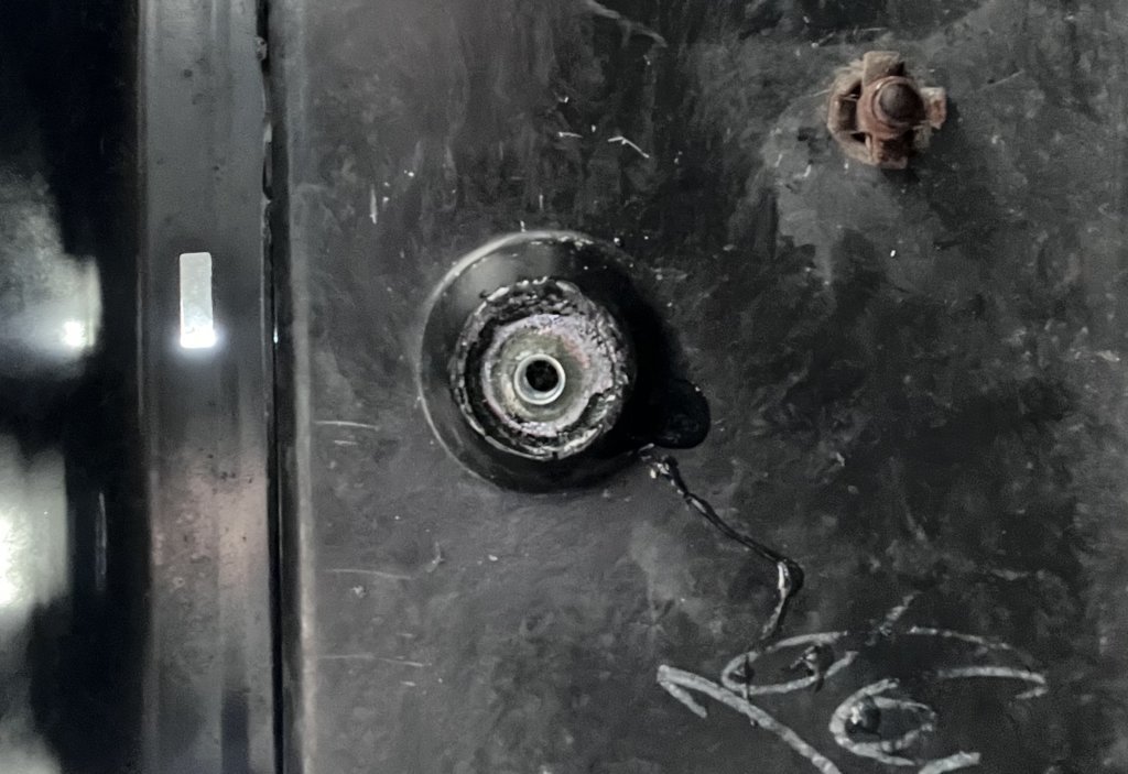

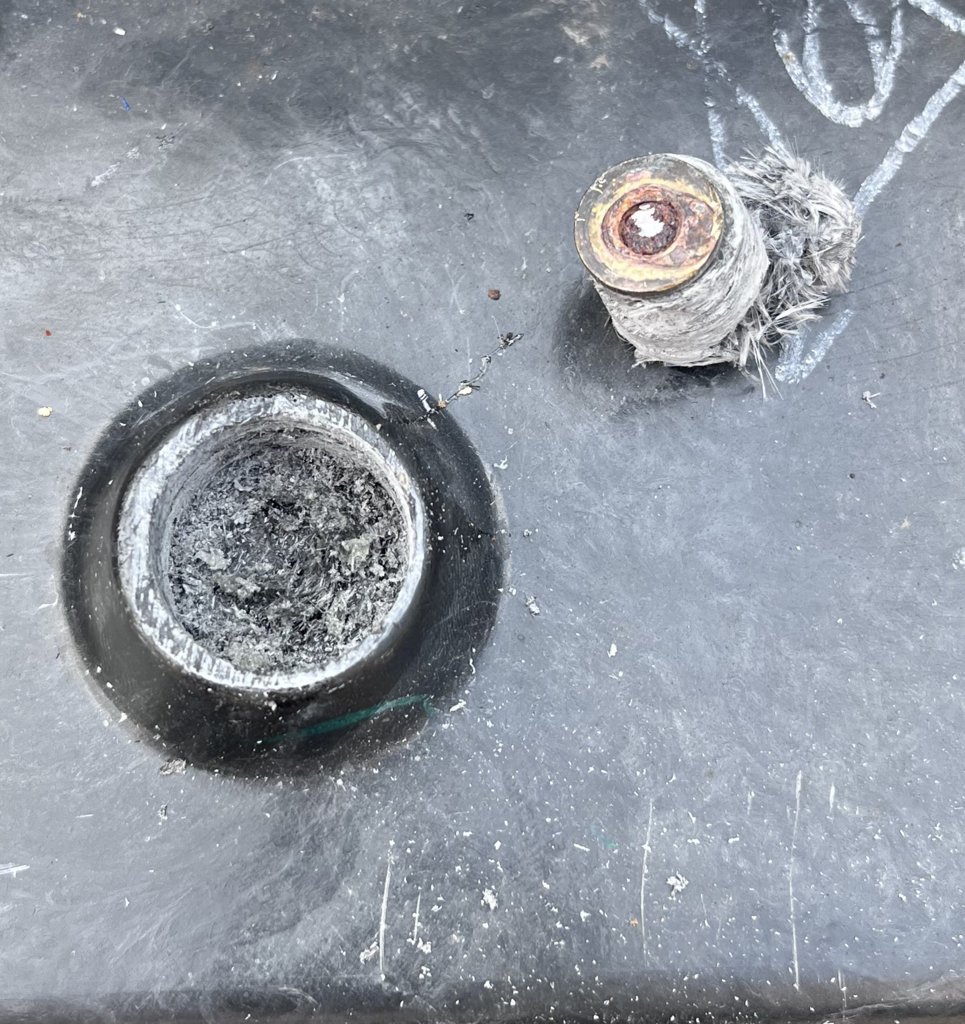

    Below is a pic of the inserts. They are on the underside of the wheelwell hump. The one on the left is as is from the factory with a broken off bolt rusted in it. The right is after using an angle grinder to cut the insert in half and remove it. The hole left behind is 3/8".
    I'll probably have to open up that hole for a new insert.

    I drilled around the inserts with a 3/4" hole saw and then popped them out. I epoxied in M6 T nuts.

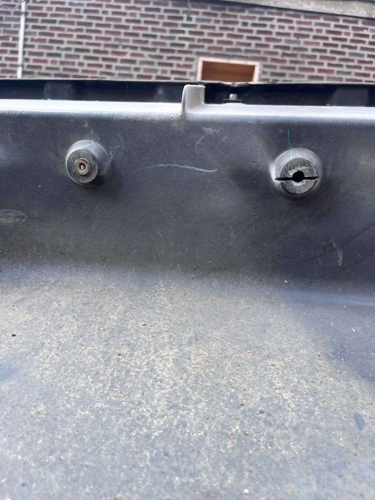

    Here's the epoxied nut. Can't tell much from the pic but it works.

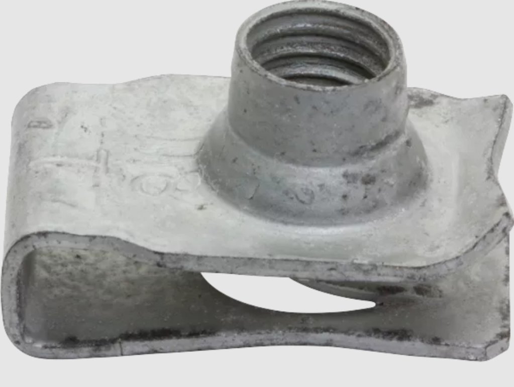

    Thanks Alantaco78 for your link. That's a nice alternative.

    Is that a modified U-nut? Looks good!

    I used a T nut which are normally for wood. They have spikes to grip wood.
