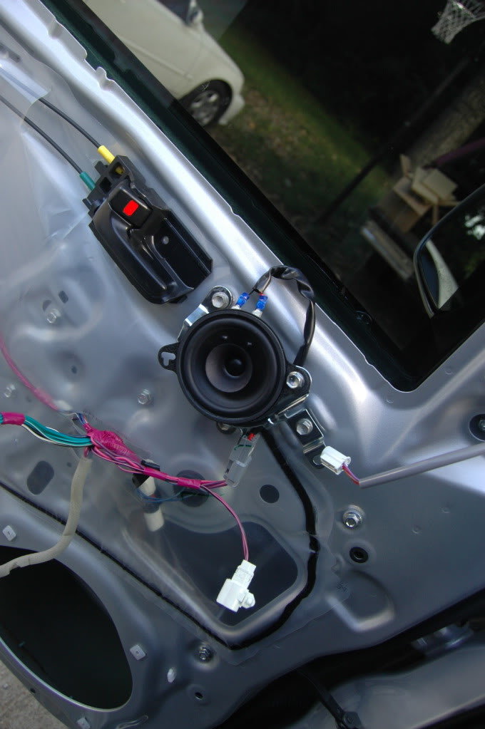

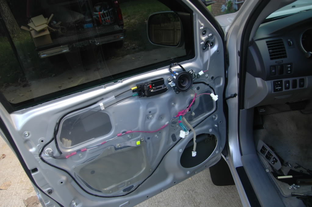

    Replaced stock tweeters with a pair of 3.5" Polk EX-351a. Surprisingly, I got the suckers to barely fit with the stock bracket. However, I could only get one of the screws to fit, but it's torqued down pretty good, so no problems there. Anyway, these will complement the Polk MM6501's component set, for a 3-way system. I sniped the stock tweeter wires and connected these to the head unit. (Pioneer 4200 DVD) and bass blockers will be added. However, the Polk components will be amped with a JBL GT5-A604, with a pair of Hertz ECX-165's in the rear. To finish everything off, I plan to mount the 6501 component tweeters in the sail panels. They sound pretty good. The Ex351a's cost me about $20 off of Ebay. Here's a link if interested: http://www.polkaudio.com/caraudio/products/recent/ex351a/
