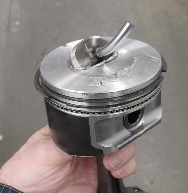

    Possibly... If you floated a valve like this kid
    Took mom's new M5 to go get gas... had a little too much fun.
