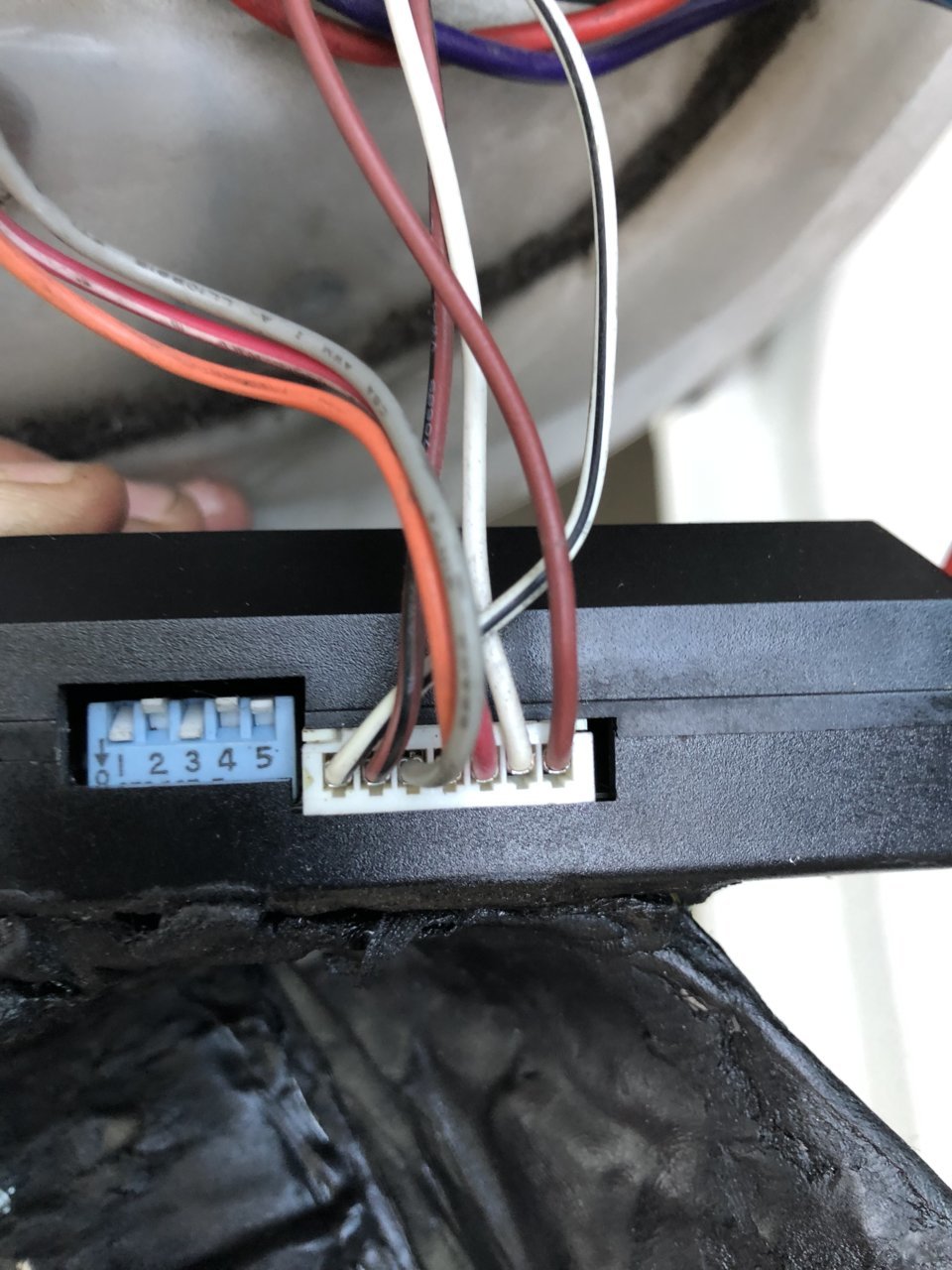

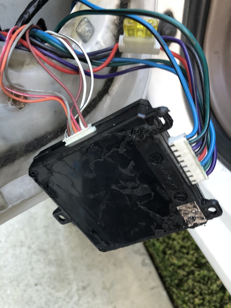

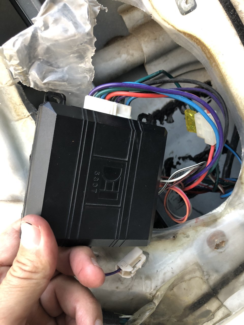

    Replaced motor and assembley. Still not going up. Found this box inside door panel. Is this what needs to be replaced next?

    I can hear a clicking noise from this box when I try to raise glass

    I'm almost positive that's a car alarm of some sort. It shouldnt affect windows. Were there any wires running to the driver kick panel?

    Just looked it up, you could control windows with a remote. Believe unit is dying so can’t control drivers window now.

    Is there a company logo or stamped? If so, call for replacement controller

    From viper...

    How do I get rid of it?

    Nothing to it. Just remove it and patch any wires that were cut on the original harness.

    If you no longer have the alarm system, simply remove the unit and return all factory wires to their original destination.
