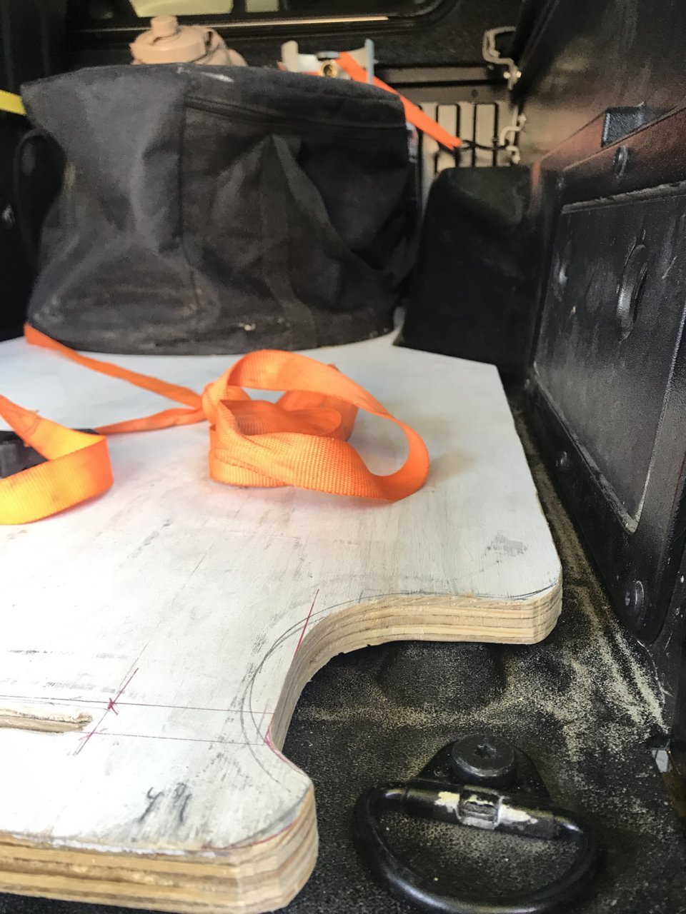

    I’m wondering if anyone has replaced their D-rings with equally burly D-rings that lie flat. The hole in the existing D-ring is about 5/8.” Most I’ve found online are smaller and flimsier.

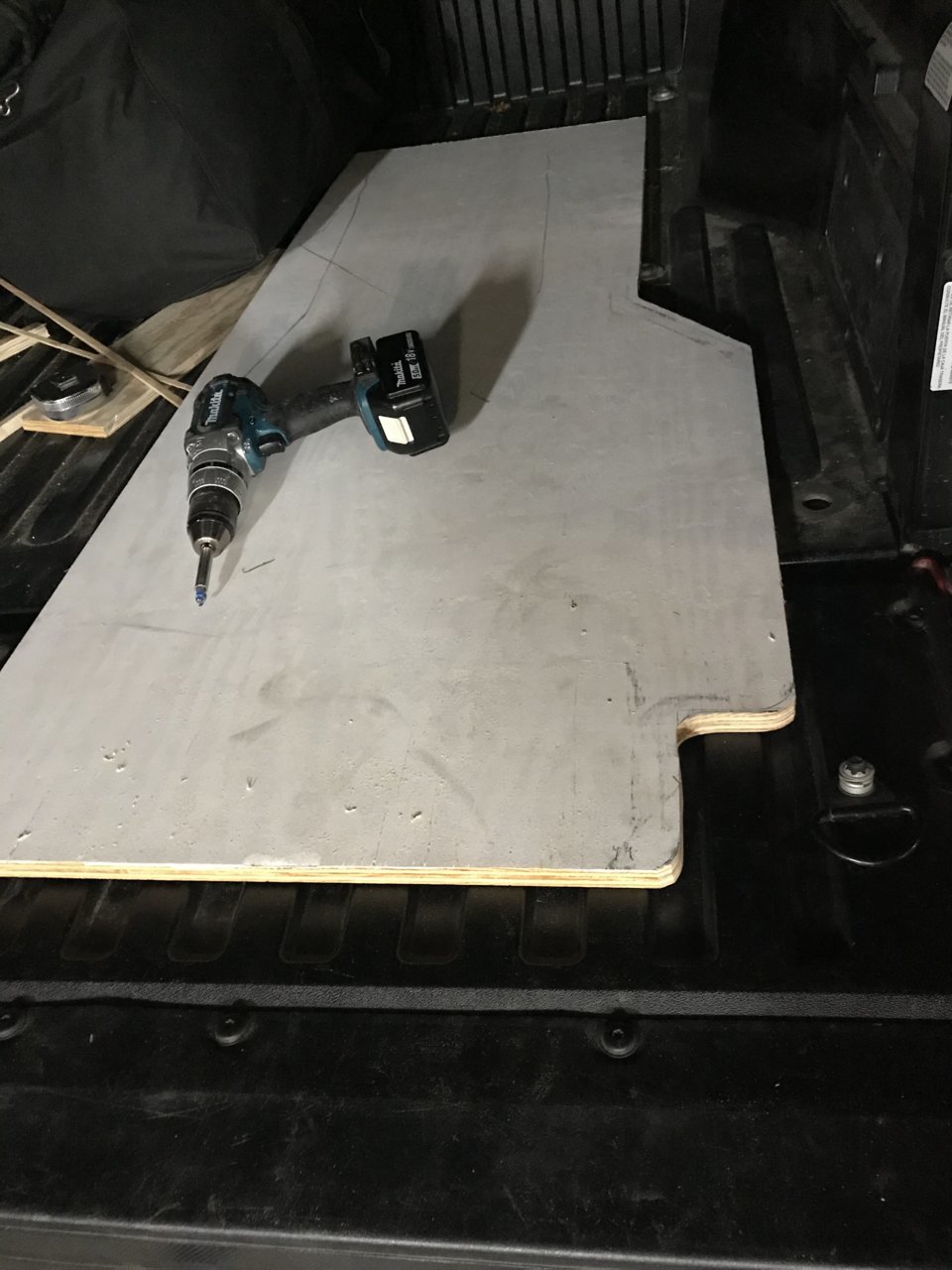

    The long-winded reason: I’ve made a very basic sliding tray of 3/4” plywood for half of my 5’ bed so I can put heavy stuff on the tray (propane tanks, 5gal jugs, camp kitchen) and slide it out close to and onto the tailgate for loading and ease of access. It has a single wood runner on the underside that rests in one of the bed grooves to limit sliding. I hope this simple slab of plywood will limit hunching over inside the shell to move awkward items and speed packing/unpacking. I’ll make a few recesses and tie-down slots so the items can be lashed down. But the tray catches on the OEM D-ring that is designed to pop up and sits higher than everything else.

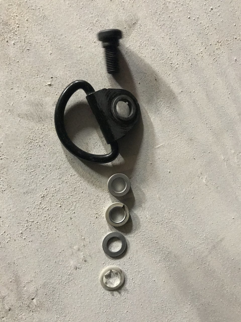

    On a side note, the parts and bushings and everything included with the OEM D-ring were more involved than I expected—it’s nice to see they’re designed to hold a decent amount of weight.

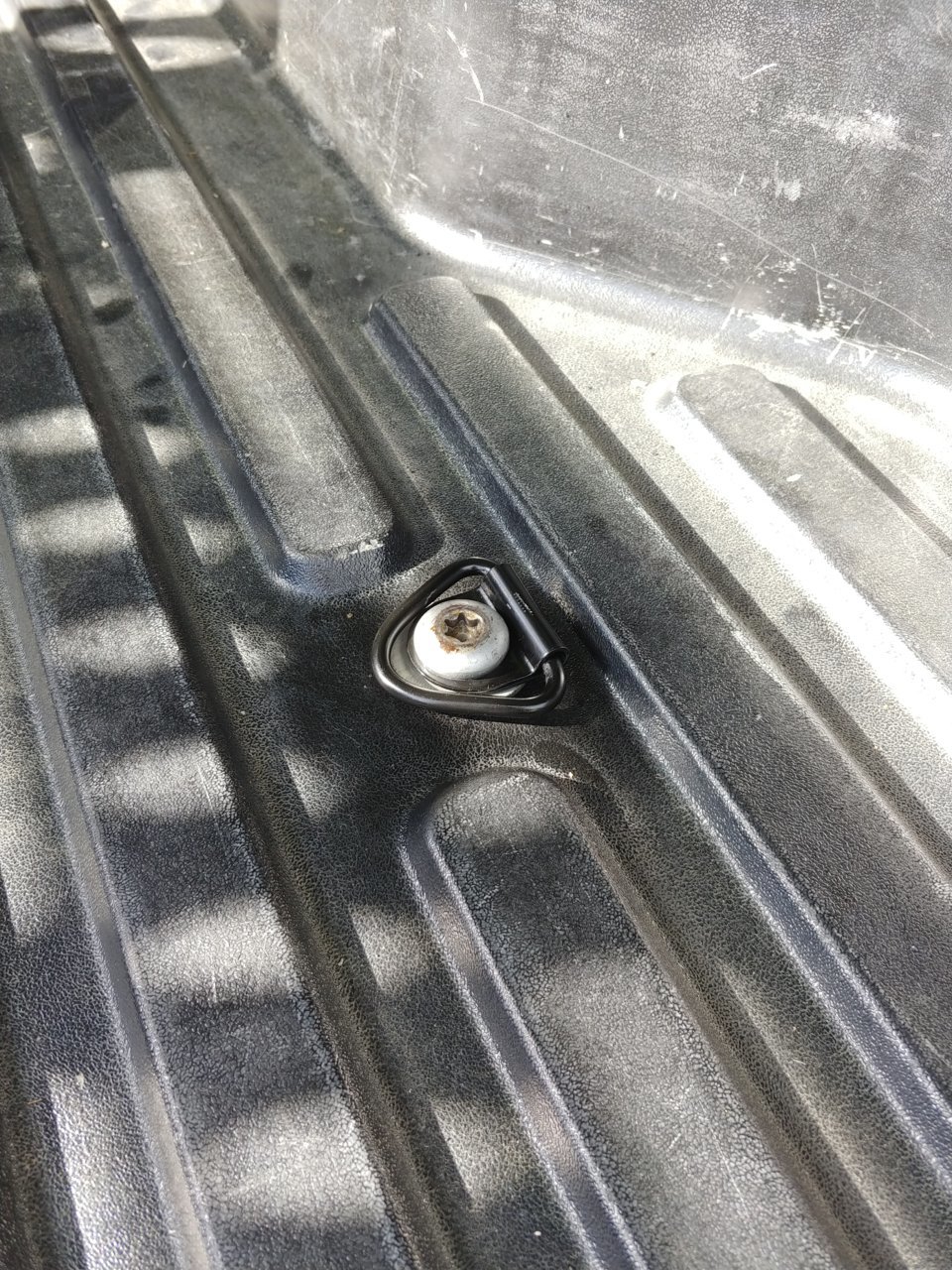

    These will work and lie flat. You may have to make the hole bigger and do the belt bolt mod, cheap and easy, good info at the link below. The OP used oe d rings, the ones that lie flat you can buy anywhere, they hold alot of weight.

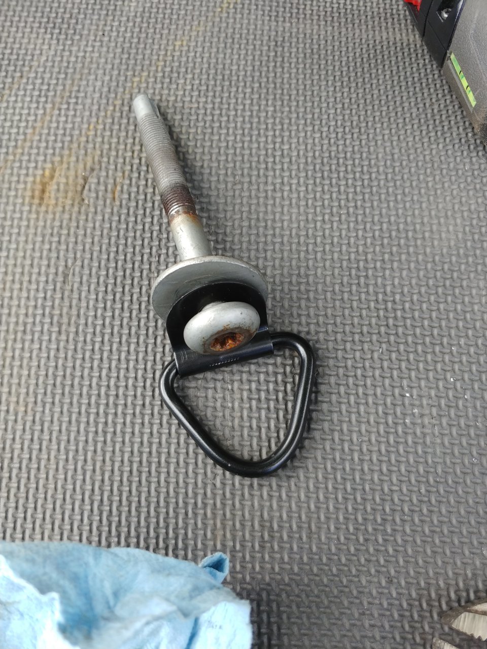

    Last week I added 4 more tie downs to the bolts that hold the bed to the frame. Im not sure if they would work for you application, but the do lay flat.
    These are what I used:
    https://smile.amazon.com/gp/product/B01CGXSNC0/ref=ppx_yo_dt_b_asin_image_o02_s00?ie=UTF8&psc=1
    Required drilling out the hole to 1/2", as well as a bit of grinding down on the bolt to get the washer off. But Im real happy with how it turned out, only possible issue is they dont rotate like OEM.

    For me, I used a socket to hammer off the washers with a chunk of wood under the the tail of the bolt just in case. My only mistake as not wearing gloves. :D
    Rotation would be nice, but I just pointed them somewhat toward the center of the bed. Straps at different angles have not turned them at all. You should be good to go!

    Update: I ended up grinding down the little nub on the OEM d-ring. It lies flat now. It’s a bit ugly but functional.
