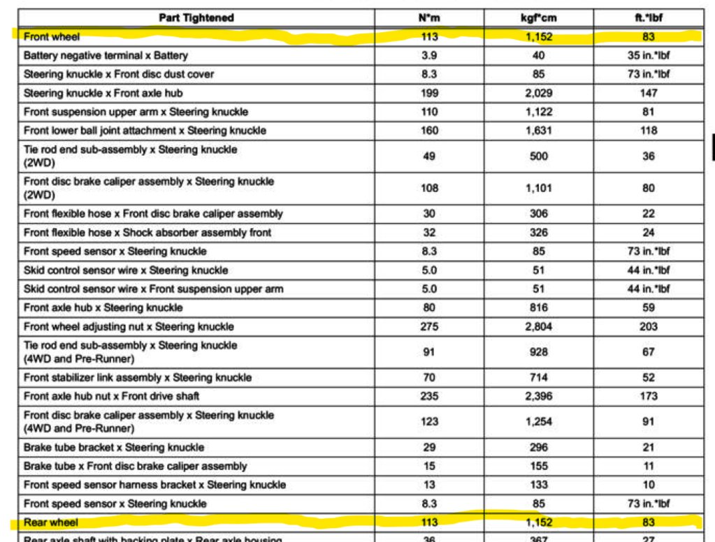

    I tighten my lug nuts to 84 ft*lbs.

    Good catch on the lug nut torque. Thank you! I just edited the above post.
    Although the FSM states that it's actually 83 ft/lbs.

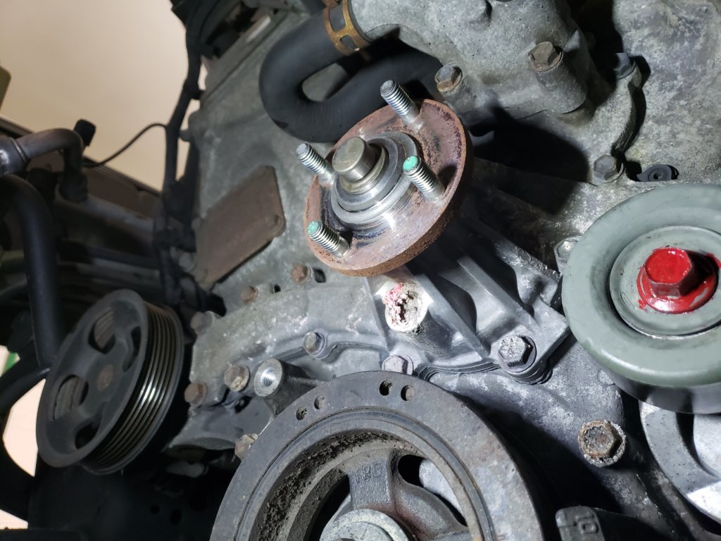

    Original Coolant pump with 135K miles - showing crud at the weep hole. This crud led me to replacing the water pump. You can also see that I painted the tensioner pulley grey and the bolt red so that they would not rust, and to differentiate the 13mm LEFT hand thread from the 14mm right hand thread on the other pulley bolts.

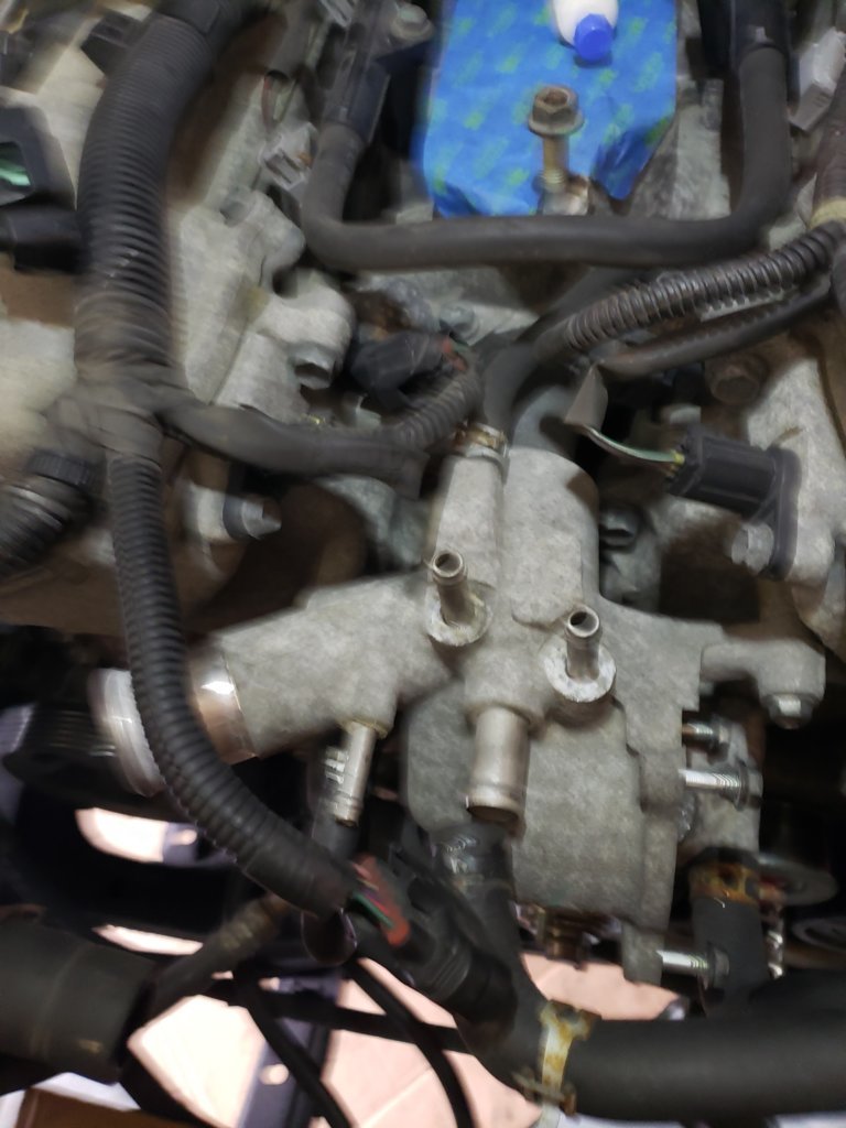

    The thermostat / bypass housing.

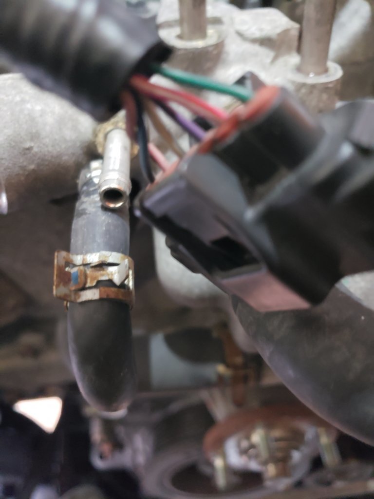

    A closeup of one of the original hose clamps showing the rust that weakened them over time. I believe that this one broke as I was re-installing it.
