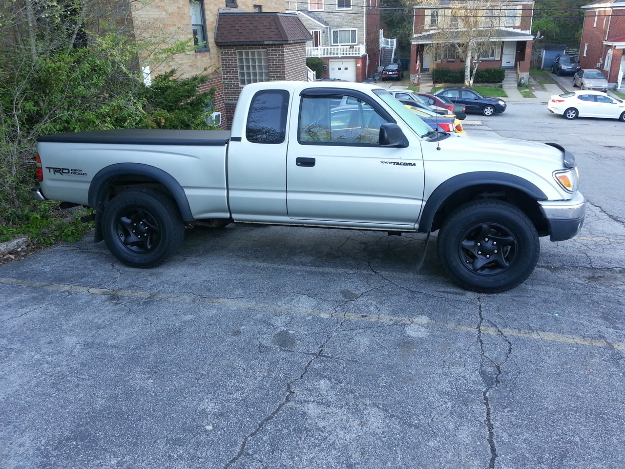

    here's a pic of the 5-star with black on them
    Xbeaus likes this.

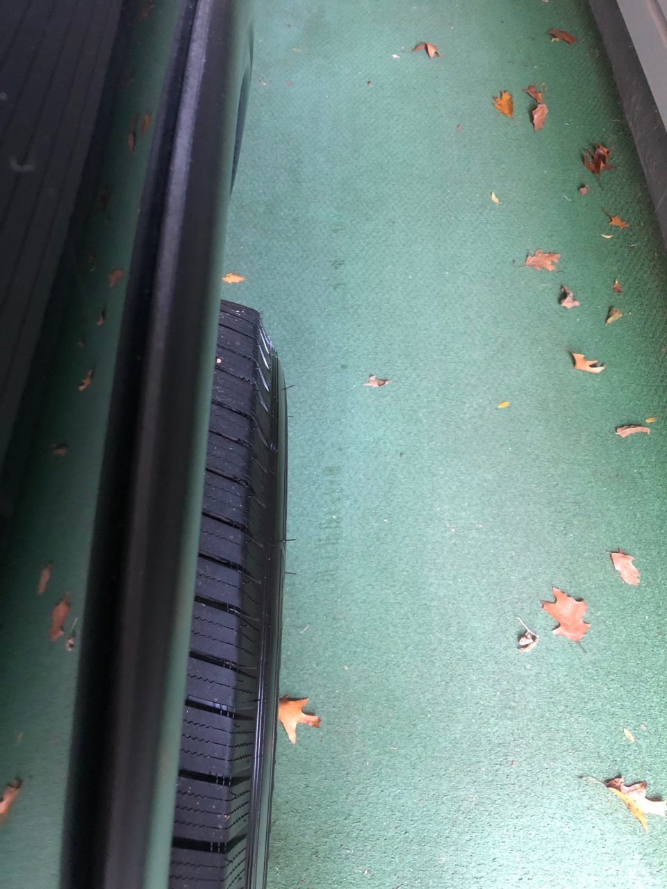

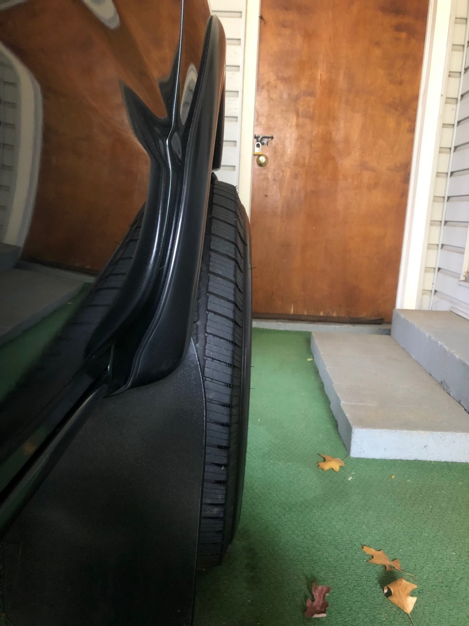

    Pics of current wheel
    ToxicTwin likes this.
