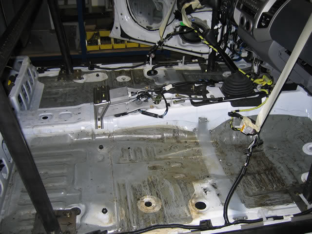

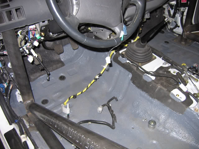

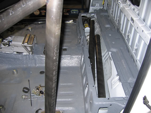

    It's definitely loud, but then my truck would be even with more insulation. I used Durabak and am happy with the results. Rhino lining could be applied much thicker and could result in a decent amount of sound deadening over the roll-on stuff I used.
    I scraped/cut/xylened the glued-on insulation off of the floor before applying the Durabak.
