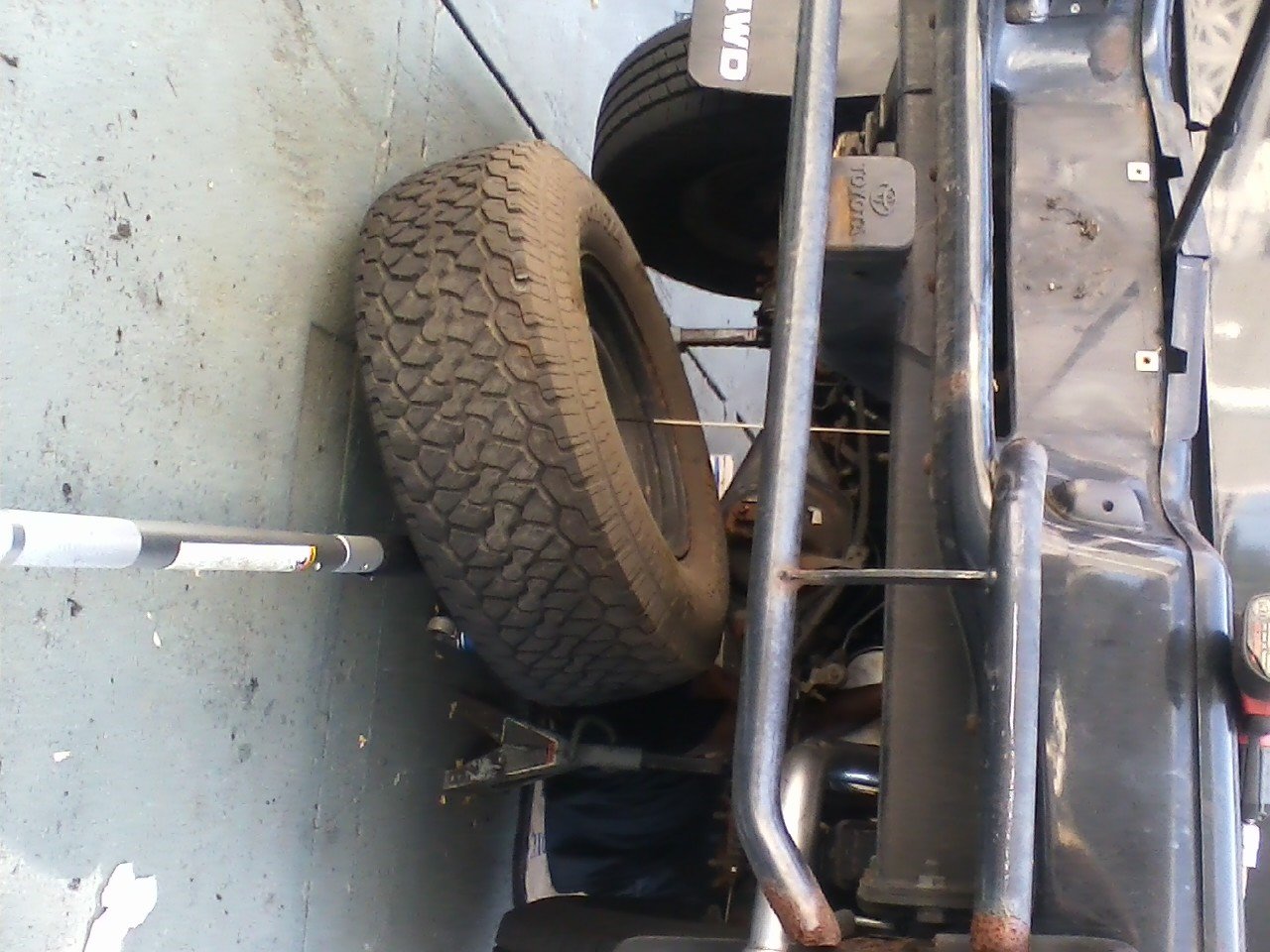

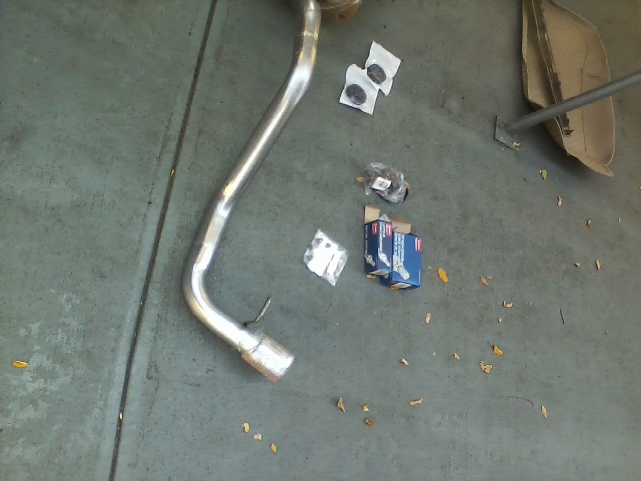

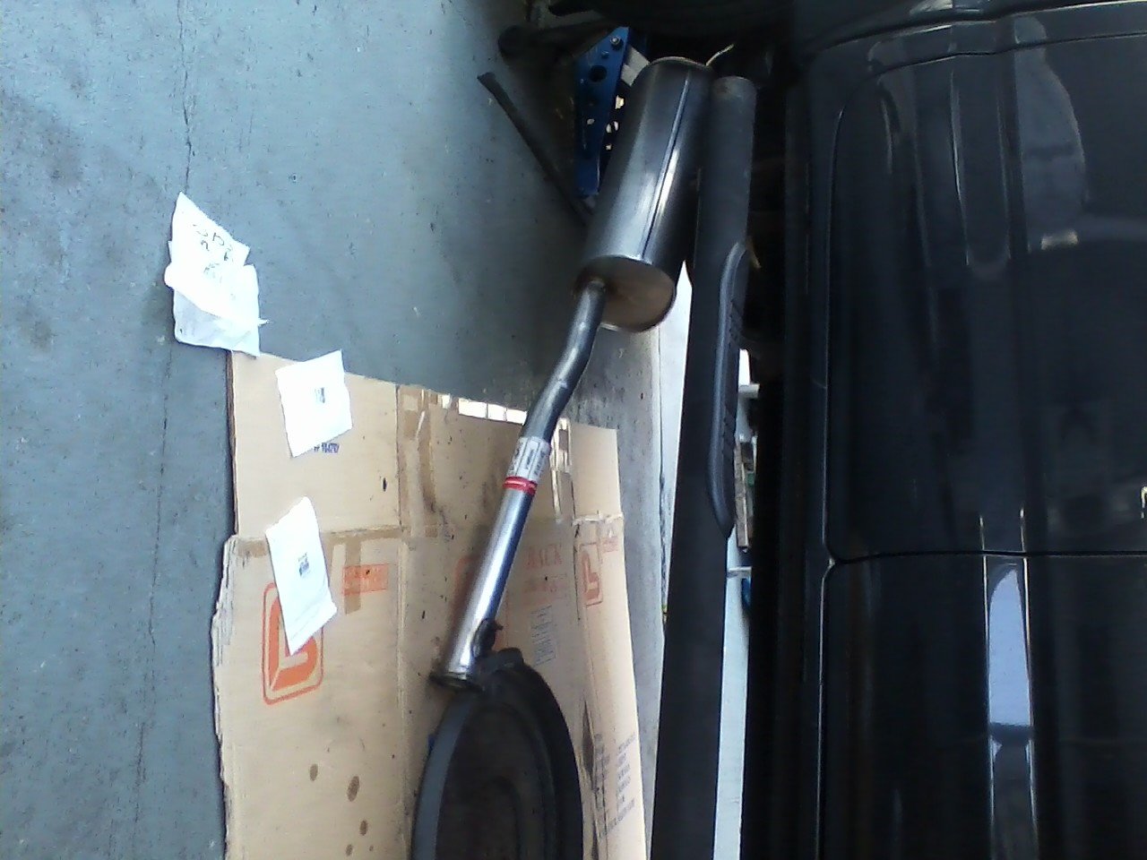

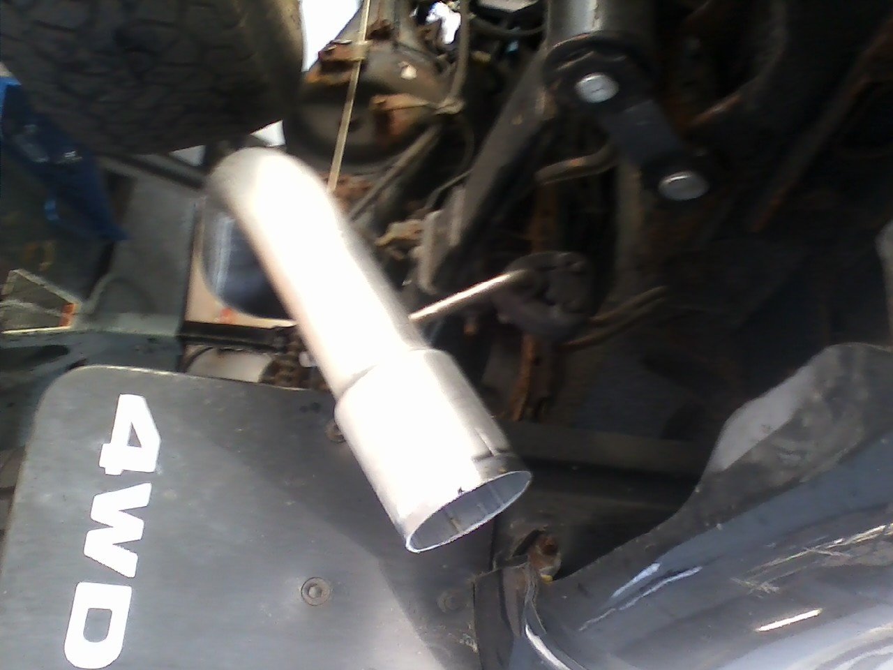

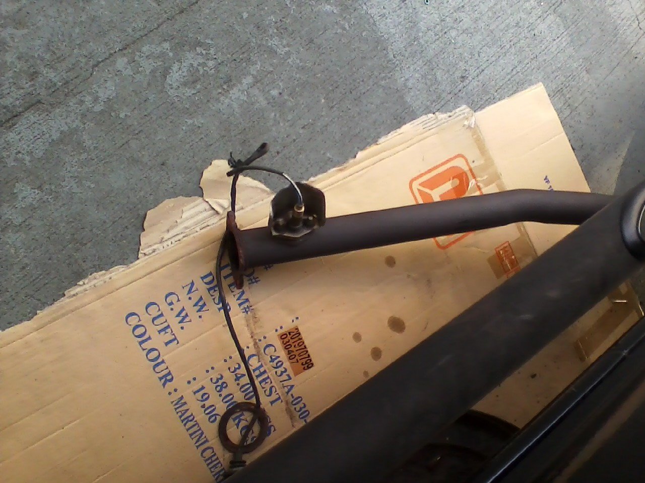

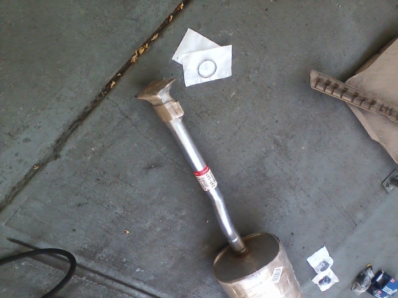

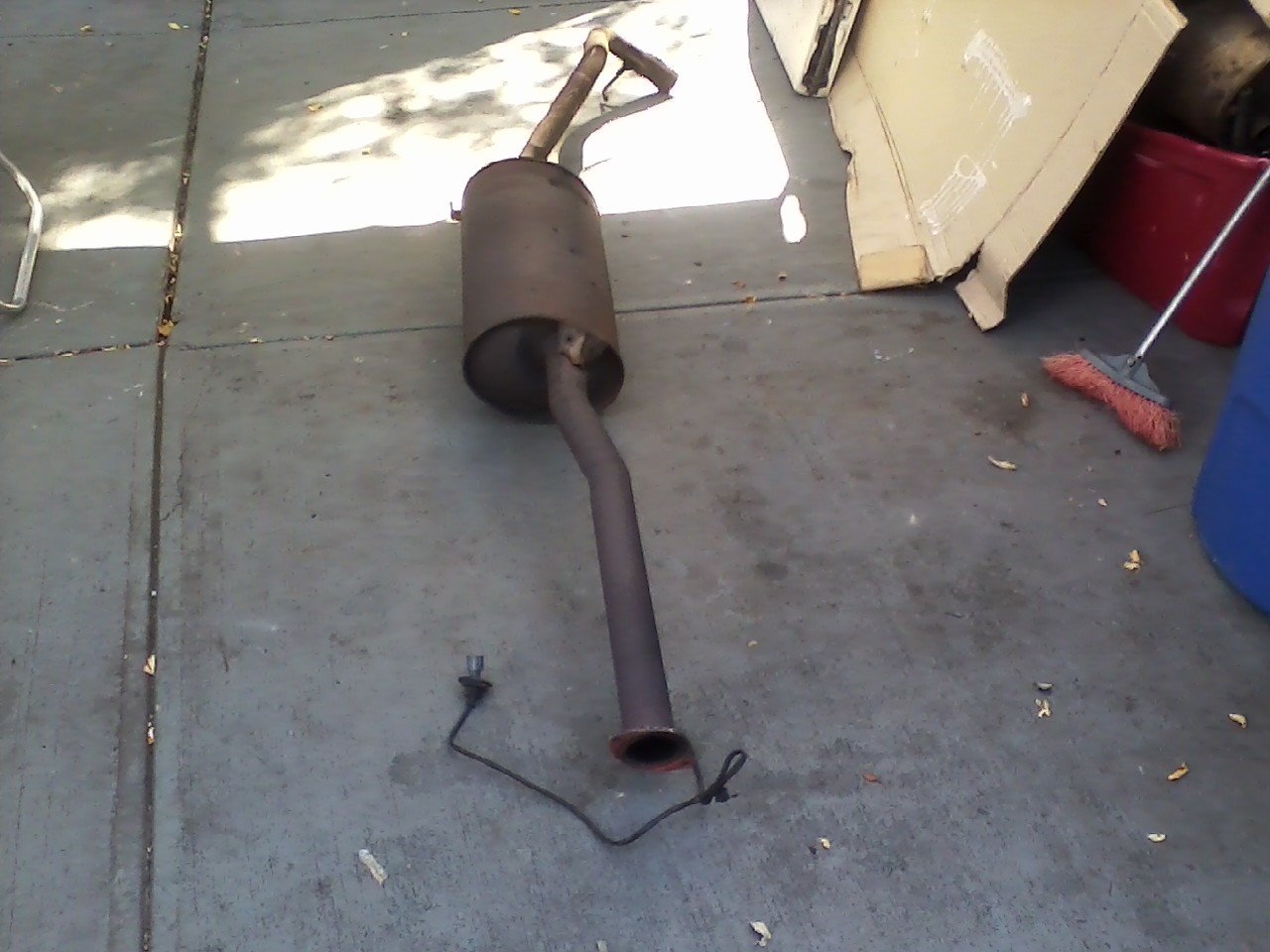

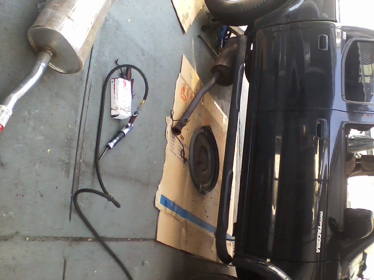

    I bought the Bosal plus new hardware and oxygen sensors. The quality of the Bosal (for the $) is very good. The pipe is HD and not made out of coca cola cans. Fit was spot on. You have to be very careful in taking off the nuts for the front oxygen sensor as if they break, it is a major PITA to fix it. Heating it worked as usual. The spare tire has to be lowered to change the exhaust system. Good time to check and lubricate the cable.
    Some pictures are attached.
    PS: Purchased the Bosal from Amazon with free shipping.
    I need to change the rear bumper guard. Any suggestions? looking for basic, decent quality product that will last 5-10 years.
