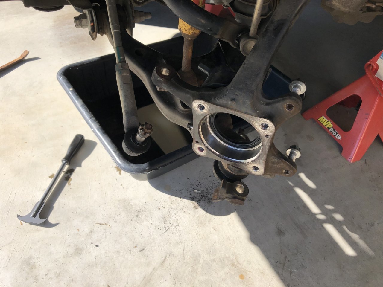

    @Mastiff37
    If you look close, you can see the outer seal still in the knuckle:thumbsup:
    This is from when I did my bushing.

    Good afternoon, @ TnShooter, from your photo...that 'outer seal' still in the knuckle. Do you use the tool on the ground to pry (?) that seal out? Now, there's another seal which has been mentioned to replace, is it in that photo as well? Did you replace both/one/none of those seals when you did yours? Thanks in advance for your (and others) taking the time to share information. I'm hopeful to have my new bearing assemblies within a couple of weeks and I bet that when my tire comes off and I'm able to actually see how everything is connected, things will come together and I won't have to ask too many more questions. Oh, and 10 4 on the screwdriver not being used on the dust cover.

    The tool on the ground was used to pull the seal out of the front differential.
    You won’t need to do that, so ignore the tool.
    To get the old seal out, use a screw driver from the back side of the knuckle and pry it out.
    (I used a wood chisel, because I already had it laying there) But a screw driver will work fine for that seal.
    The other seal is ON the CV axle.
    I know better than to say this, but if that seal looks good.
    Leave it alone. It can be a pain to get off and on.
