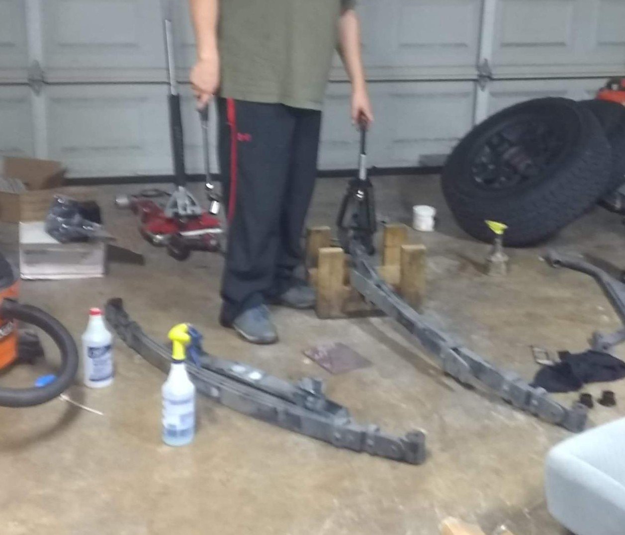

    Do one side at a time. Remove leafs from truck. Easy work.

    I got to mine without taking the whole packs out. Was easy enough.
    A bushing press helps to get the old ones out. And a pry bar to get the pack down enough to get at the bushings.

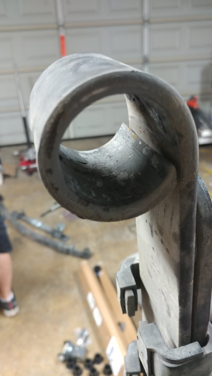

    Got a trick for you on removing the OEM bushings. Use a 1/4" drill bit and drill into the busing right up against the shell. Then put the drill in reverse and it will go around the outside of the bushing and walk the bushing right out of the shell. Make sure the bit you use is at least as long as the bushing. Works like a charm.

    @Torspd and I used a huge 3 jaw press
    The forward side was easy its one piece steel sleeve bushing. Rear side of the spring has a split type.
    Punch those out and ur golden.
