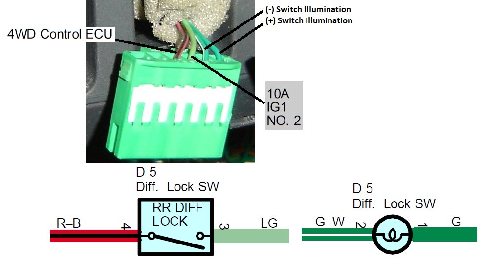

    Ok so this is my first posting here but hopefully someone out there can lead me in the right direction. Recently I purchased a couple OTRATTW LED Rocker Switches. One for my RIGID Fog Lights and one for my RR DIFF LOCK. The Fog Switch light was able to successfully match and land the circuits thanks to the help of this forum.
    But for rear differential lock switch its different story. I cannot find any posts out there on this site or others that provides the guidance that was available for my fog light swith replacement.
    I guess ultimately I have two problems that I am hoping to get someone to give me guidance on on:
    1) Do I need to buy a different type of OTRATTW switch to replace my OEM RR DIFF LOCK switch? I bought a SPST, dual LED. Is this even the right type?
    2) Where do I need to land the four wires (G/W, Light Greew, Pink, Green) from the old switch onto the new OTRATTW switch. I have have attached some pics which might help.
    PLEASE any assistance would be helpful.

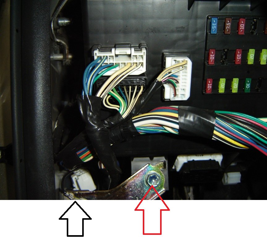

  8. Jul 5, 2015 at 8:34 AM
    WhiteTaco2007
    WhiteTaco2007 [OP] Member
    Jun 10, 2015
    #157156
    5
    Jason
    2007 White Tacoma TRD
    Pro Comp Suspension Lift with 33" Super Swampers; RIGID Exterior Lighting
    Thank you for the wiring diagram caribe makaira and photo. Much appreciated.
    I do have one more question where should I take the B/W chassis ground wire from that you show on pin #6?

  13. Aug 5, 2017 at 5:27 PM
    caribe makaira
    caribe makaira Well-Known Member
    Feb 13, 2011
    #51121
    10,442
    Caribbean, Puerto Rico
    05 PreRunner TRD Offroad AutoTrans
    Hood Struts, My version Fogs always ON, Map & Overhead Light Mod,
    Either one is a good ground attachment.

    Bump! The wiring diagram got deleted.
    @caribe makaira
    I need the pinout from the factory switch so I can use it for my new Eaton Elocker
    SR-71A likes this.

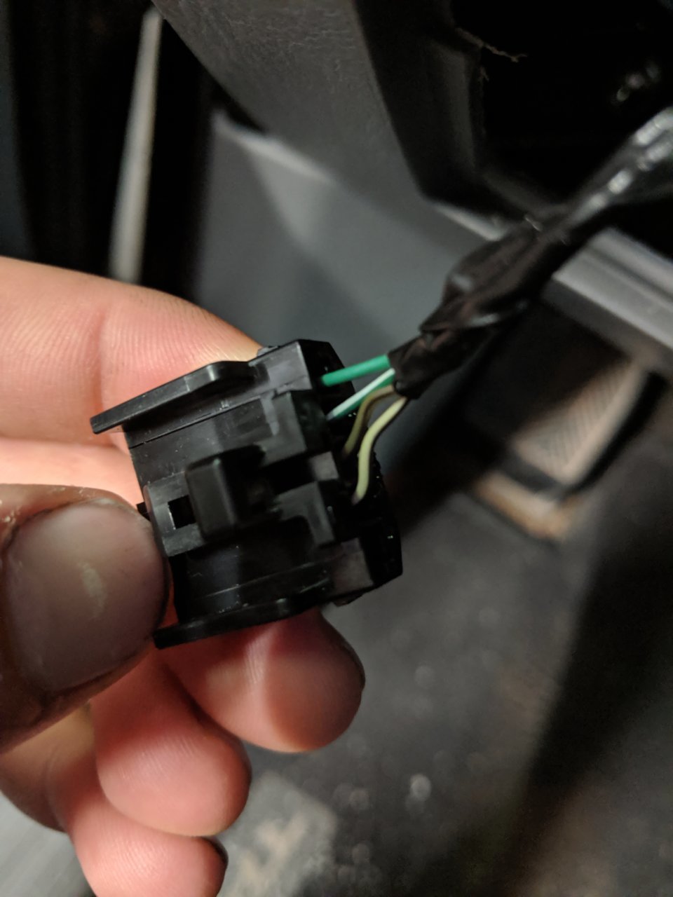

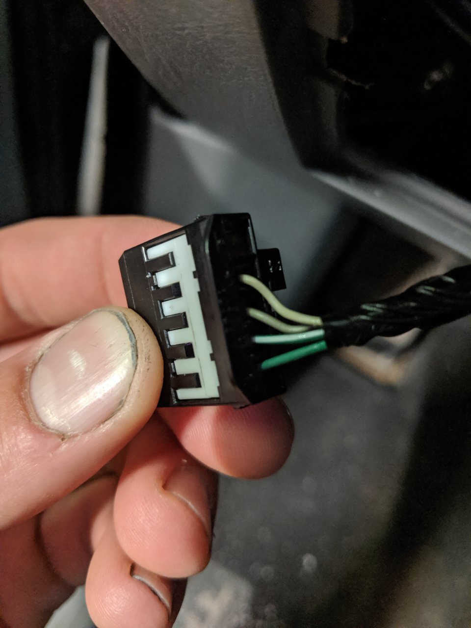

  19. Sep 8, 2019 at 1:51 PM
    #19
    GregoryS10
    GregoryS10 Well-Known Member
    Feb 23, 2016
    #179212
    81
    Gregory
    Casper WY
    2015 tacoma TRD off-road
    My colors don't quite match and I noticed the picture above shows two blank holes without a wire, where mine only has 1. Does anyone know if it is the same?
  20. Sep 8, 2019 at 3:32 PM
    #20
    caribe makaira
    Feb 13, 2011
    #51121
    10,442
    It is not, it's the Traction Control switch connector.
