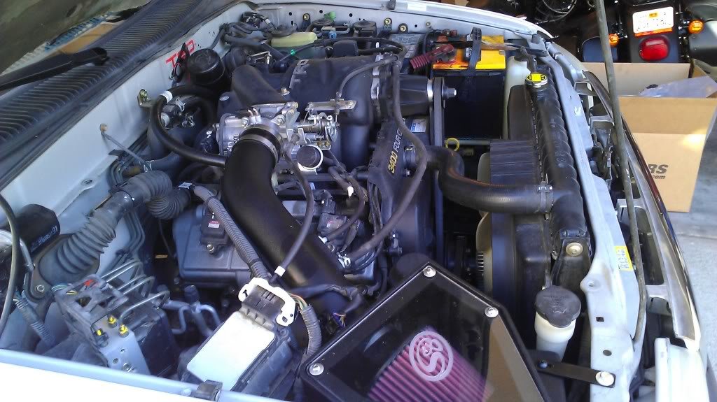

    S&B is C.A.R.B approved. I prefer there 8 layer filter over K&N's 5 layer filter & they also have the dryflow filters available for the people who prefer a dry filter over an oiled one.IMAG0470_zpscab75f24_531126dac8117c2c37b45d1def2e5bed2998a059.jpg

    Looks solid, never heard of S&B but I would totally opt for a dry filter.

    I use the 8layer oiled filter & a prefilter on mine.
    S&B are solid intakes, they do more diesel intakes than anything else I used to be big in to the diesel scene & was a dealer for them. They make good stuff. The 8 layer filter was a big plus with the diesels because it filters way better than the 5 layer K&N uses & the massive volume of air diesels suck in.
