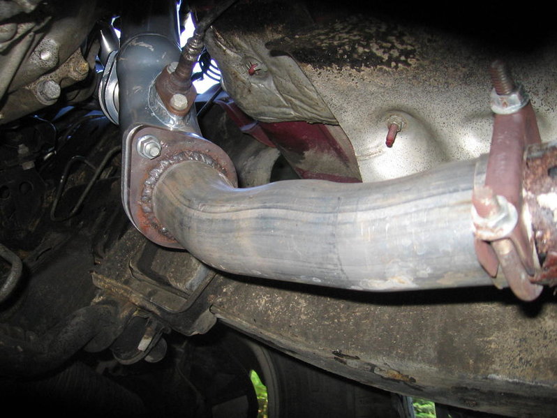

    I have an '04. I removed my front cat when I installed my headers. Mostly because the inlet and outlet for both cats is 2". i am ordering a magnaflow highflow 2.5" cat today. It will be installed next week in place of my second cat. I can let you know then if it is a good buy. Here is a pic of how I replaced my first cat. However you would need to allow a place for your o2 sensor. My doug thorley headers ($600) had a place for it. Also I don't know if removing the second cat is going to throw a code. I removed the 1st one without any problems. The high flow cat I bought is OBDII rated but we'll see. see this post for a little more detail: http://www.tacomaworld.com/forum/builds/38130-gas-mileage-build.html#post623437
