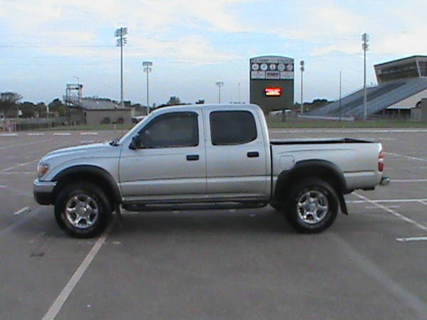

    Hey guys looking to replace my stock suspension soon on my 01 Tacoma Prerunner. Was looking for advice on what to get, or how I should go about it, meaning should I buy a whole system at once or go on a easter egg hunt for all the parts.
    Sick of seeing my truck with rake :eek:
    As some fellow TW members already told me it can be solved by replacing the stock coils with new ones but since im replacing them anyway why not do the rest.
    Also I wanted to get some new tires so figured I get the suspension first then the tires. Budget is about 1500$ for suspension and 650$ for tires.
    Looking at this suspension system
    http://downsouthmotorsports.com/i-7...96-2004-tacoma-suspension-system-stage-1.html
    Thoughts? :confused:
    Tires debating about it still. Want to run 33's but need clearance first hence the reason why im doing the suspension first. But maybe I should just stay with standard 285/75R16 with 16X8 wheels. Brand, leaning towards Wrangler Duratracs , or ofc the obvious picks for most of us the BFGoodrich AT's. :cool:
    This truck is my daily driver btw and Im frequently on back roads and highways most of the time when im driving. So I believe my suspension and tires would be a good investment. Any reccommendations, thoughts, or opinions you have feel free to share. Id rather have a bunch of opinions and ideas that I can bounce around to come to a final decision on this. Thanks guys! :D

    ICON is great but there is nothing in that kit for the rear lift. If you're leaning towards that kit, just give DSM (Sonny or Marco) a call. They will answer all you questions and get you set up for exactly what you want.
    The Stage 2 will come with a rear lift

    The suspension you have chosen is very nice. Be advised that if you need to get your coilovers rebuilt, and you likely will, you will be without a truck for a period of time while you send them out for the rebuild.
    My advice would be to not get the 285/75/16 tires, I installed them on my truck and while they look great, they are the worst thing I have done to my ride. If you want 33" tires, get the 255/85/16. They are just as tall, but way more narrow. There will be fewer issues with fitting them. Unless you need a 33" tire, stick with a nice 32, like a 265/75/16. You do not lose much ground clearance and they fit with no trimming or rubbing issues.
