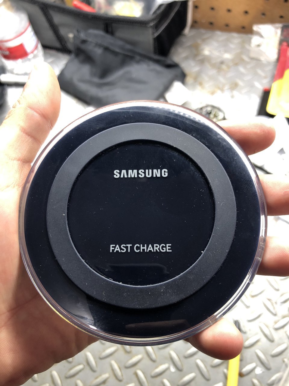

    I like the concept. I have the tray but mine doesn't have the wireless charging part. I set my phone into the larger compartment and, with the case, it fits but its tight. I'd need a tool to remove the phone. But I found this and it just might fit the bill. If it'll fit the overheating oem cubby hole then that won't just be empty space. I guess it's worth it to spend $20 to find out. If it ends up working, I could tie the wiring into the oem Qi charging power button. Of course, I'd need to remove power from the oem Qi charger as well. Itll be here Sunday.
    https://www.amazon.com/Wireless-Cha...ds=b07gzzx37f&qid=1567815929&s=gateway&sr=8-1
  15. Sep 13, 2019 at 4:22 PM
    #75
    porterx
    porterx Well-Known Member
    Dec 3, 2018
    #274643
    296
    So I ended up installing the fast charger mat on top of the OEM Qi charger and it works great so far. I wired a Quick Charge 2.0 accessory USB charger into a live 12v and hid the wiring. This is what it looks like and it fast charges as it should. Maybe I'll get around to wiring it into the OEM Qi power switch but I doubt it. It wouldn't be that hard to do but it's way down the list of stuff to do. I'd really like to build the magnetic Frankenmount. If the charger coil and accessory plug end up draining the battery, I'll have to wire it through the OEM Qi switch but I doubt I'll need to. We'll see.
    Edit: I had to cut the lip off of the mat with a razor blade at the wire end because the phone sat on top of it. It still charged but it didn't sit flat. Now it does.
