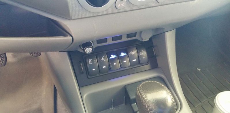

    I ended up tapping into the wires for lighting for other switches, other than that, she got pushed back into the dash ktnkf the way. I was just gonna cut the switch out, but this gives me the option to go back one day if needed.
    Ultimately I want to get that spot converted into a mount for a second switchpro.

    I could probably do a lot less if I wanted to link up some of my camping scene lights onto a single switch, but I honestly like the ability to control the individual sides. I have six that are running different light options, a compressor on the way, and saving the last spot on that one for a horn update. This will leave me needing additions for my onboard water, as well as some mad scientist ideas for future camping updates. It's probably overkill... but it keeps me busy.

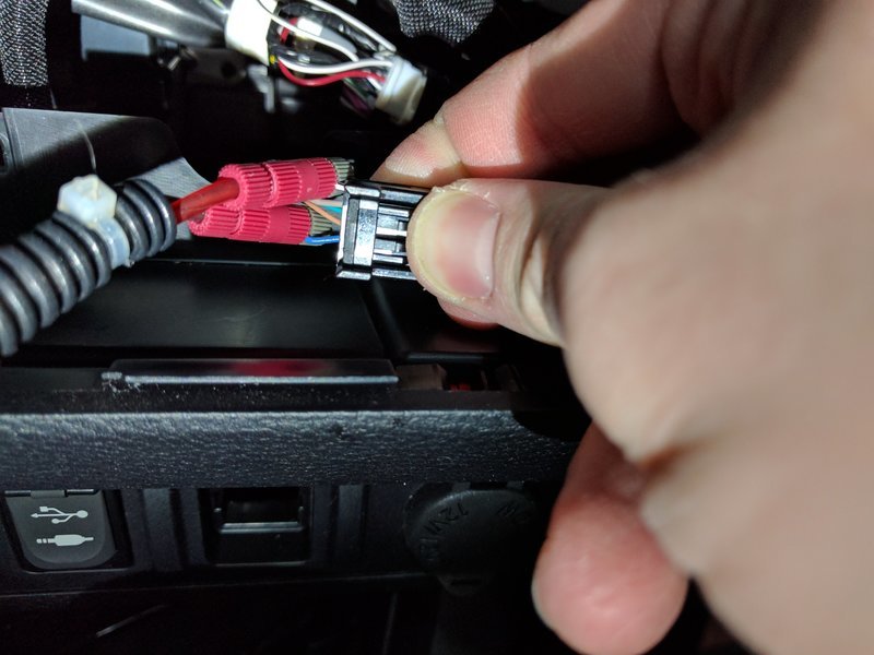

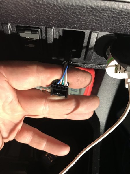

    Okay here you go. I wired up my ditch lights using the qi switch. I had to cut one factory wire. You could probably use a tap but I didn't have any.
    Im not fancying the photos up. So you'll have to take the images and words and put them together. :hungry:
    Here is the qi connector.
    The wires of interest.
    Gray is acc 12v
    Green is dimmer
    Blue is switched 12v. Meaning when you press the qi button it has 12v. You want your relay attached to the blue wire.
    Here is mine cut.
    Connect your power request to blue and you are done. Save adding a switch!:broccoli:

    There's not really much for me to re-post. I just hooked up the blue wire and ground to a relay just like OP did, but I used posi-taps and left the Qi functionality intact (which I don't actually use).
