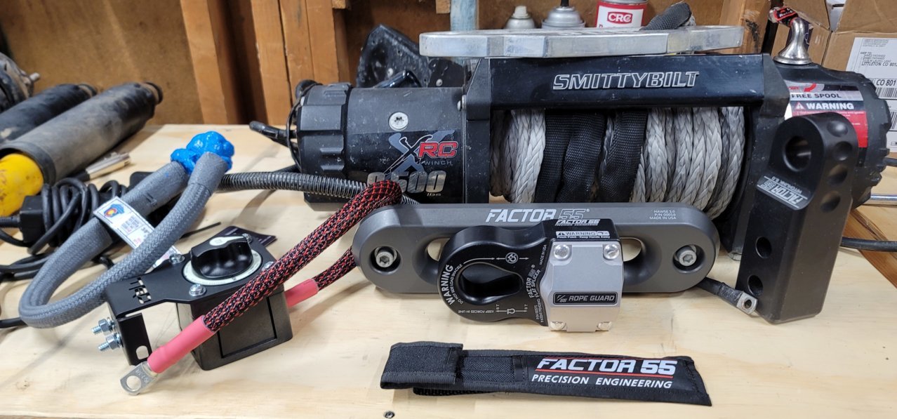

    Morning everyone.... I am about to receive my SSO front bumper in the near future. During the time that it was being fabricated I picked up a Smittybuilt XRC 9500 lbs winch. With the current location/access to the winch controller box being limited I thought it might be a good time to consider relocating it. Has anyone done something similiar? Does anyone know the size of wire I should use? I heard welding wire would be safe.
    I purchased an arb dual air mounting plate that sits about the fuse box that I was thinking of repurposing to relocate the controller box and my fuse block etc...
    Thoughts?

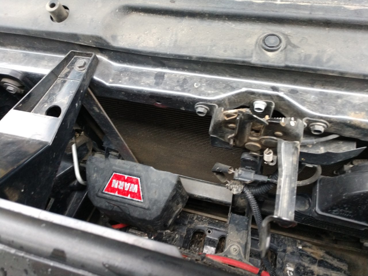

    I ended up just bolting a piece of flat bar in front of the radiator and mounting mine there. No issues so far.

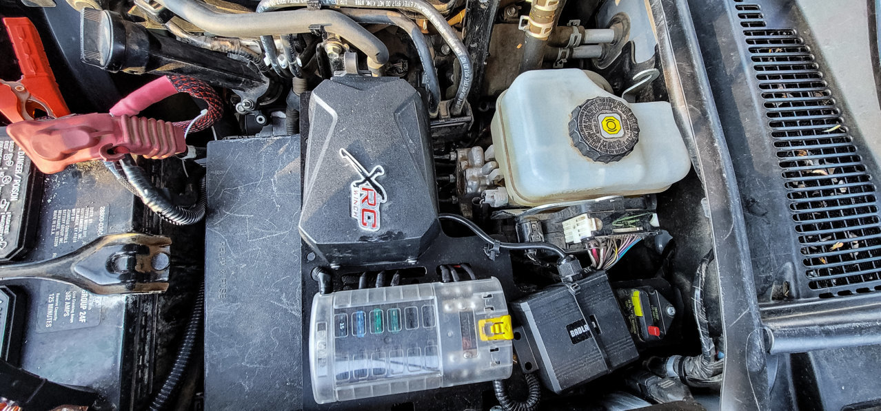

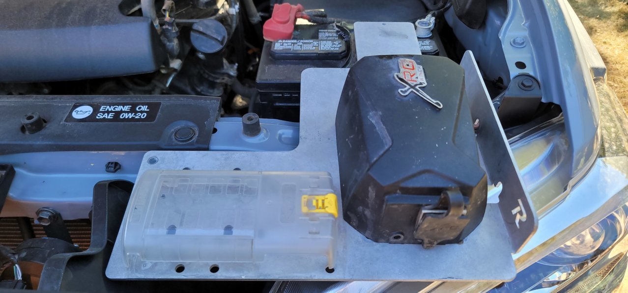

    Finished up my relocation... came out pretty decent.

    No problem sir. Yea I ended up calling smittybilt they indicated a gauge wire then I went bigger. Based on some ratings it looked like welding wire was the best approach.
    In the end it's just a typical rewire job.
