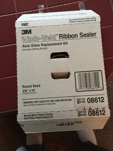

  14. Apr 25, 2017 at 3:53 PM
    303tacoma
    303tacoma Bad Karma is a Bitch
    Jan 19, 2014
    #121024
    10,762
    Rebecca
    Sw Denver Concrete Jungle
    2008 TRD AC 4th gen Rav4 Platinum
    ICONS Front & extended Rears DAKARS LR UCAS Wheelers Super Bumps F/R Homersoshi & Bumper insert, Ultra Gauge, Wet Okole seat covers, AFE air filter, Truxedo tonneau cover, LED White Cluster swap by yosh2000, Audio upgrade, ECGS Bushing, rcbs204 Lighted 4x4switch, Bullaculla trailer harness relocate bracket SOS Concepts IFS skid & sliders Anti- Dark RedLine Hood Struts Matt Gecko Bed Lights BHLM Depo Tailights Fog light anytime mod ABS cancel mod Rear diff breather mod Brake light 35watt mod Relentless u bolt flip Mobtown Recovery Bar Sound deadener doors rear wall
    Use this way better than silicone
    My headlights haven't leaked since I pulled them apart and resealed using this stuff
