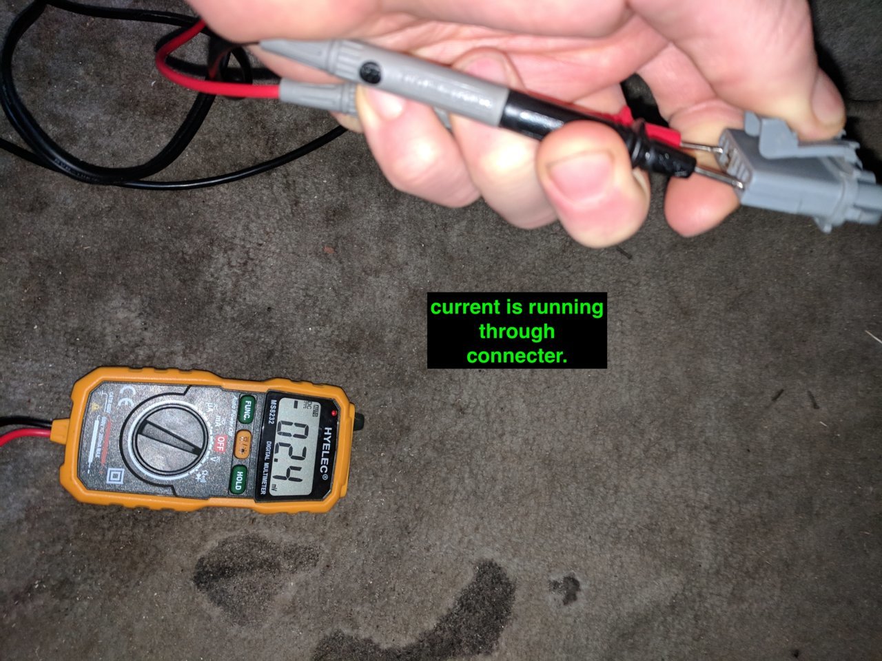

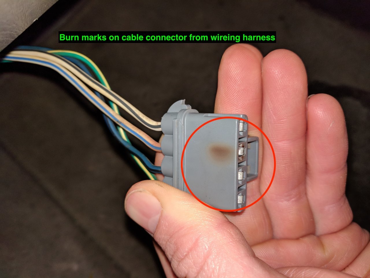

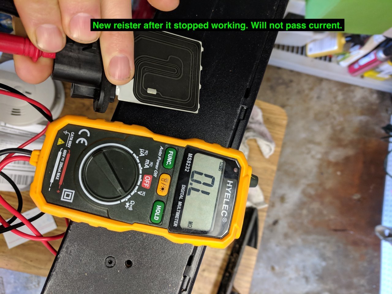

  17. Jan 24, 2019 at 12:25 PM
    #17
    00002006
    00002006 Member
    Jun 7, 2016
    #188977
    8
    2006 V6 tocoma with access cab
    Airbag suspension.
    I am having the same problem.
    2006 tuck with 186,000miles
    Replaced the relay it the new super hot to the touch and only lasted two days. Put the only one back in which seems to be working on with the controller set to high, however, the blower motor runs very very slow. Just enough to defog the windscreen.
    Just purchased a new motor off Amazon. Will install and report back if that works.
    https://www.amazon.com/Plastic-Heat...automotive&vehicleId=1&vehicleType=automotive
    Link to album: https://www.tacomaworld.com/media/a...g-blower-motor-wiring-resister-problem.50914/
    newReisterDoes not work. .jpg newReisterDoes not work. .jpg test#2 of orignal resister.jpg burnt cable connecter.jpg newReisterDoes not work. .jpg stock resister for blower passes current.jpg current is running through connecter. .jpg
    TRDsnb likes this.
  18. Jan 24, 2019 at 3:16 PM
    #18
    Jimmyh
    Jimmyh Well-Known Member
    May 16, 2012
    #78991
    13,807
    SC
    2012 Prerunner SR5
    Your pictures are confusing and seem to be repeating.
    For the new resistor you keep saying that it won't pass current but the meter is set to resistance.
    The Last picture you say it is running current through the connector when the meter is set to Voltage and showing 2.4 millivolts.
    Granted the resistor should show various resistances depending on where you place the leads. See the drawing below to see where the pins should be. Your guess is as good as mine about what the various resistances should be as they are not specified in the prints.
    Also there should be voltage at the blower whenever the truck is on through the heater relay. The resistor controls motor speed by inserting a resistance in the ground leg of the blower motor.
  19. Jan 24, 2019 at 4:43 PM
    #19
    00002006
    00002006 Member
    Jun 7, 2016
    #188977
    8
    Airbag suspension.
    Jimmy,
    Good point. Let me clarify.
    My goal was to use the multimeter to troubleshoot the parts in the system in an attempt to identify what was and was not working and to choose the next best step based on the results.
    1. I used the resistance measured in ohms on the multimeter to verify that electrons move through a conductor, in this case, the;
    a. old original resistor has a resistance measurement of greater than 0 or 2.8 Ohms. I believe this is an indication that it may still be functional. So I am going to keep it for now.
    b. the new resistor, which seemed to overheat for the short time it did work has resistance measurement of 0. For this reason, I am going to stop using this part after I install the new blower.
    2. I choose the voltage meter measurement in DC = Direct Current of the cable connector from the wiring harness because I could easily take measurements while using the AC controller unit to send power to the cable connector while the truck was running. Despite the burn marks on the cable connector voltage did flow. In the photo included in the post, we can see that the voltage is at about 2.4v. In another measurement of the fare endpoint of the connector (not photographed) I received a reading of 12v.
    I believe this is an indication that both the wires and connectors are working and for that reason, I am not going to replace this part yet.
    3. The blower is the weird one. It is functional with a new resistor. However, I am not sure how to test whether or not it is causing the resistors/wires to overheat. For that reason, I am going to buy a new one install it and check the temperature of the wires, connector, and resister after install.
    Hope that helps clean things up.
    Thanks,
    ~ 0000
