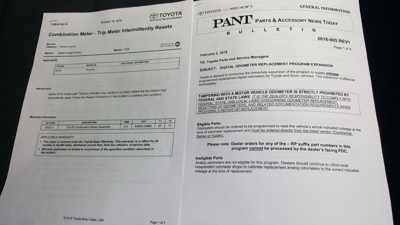

    That s what they TOLD me, it didn't happen yet. You know how that goes. I ll believe it when it happens. I ll let you know. I never did get a printable copy of the tsb, but if they replace it, don t really care.....................

    Here's what they handed me

    Its an extremely quick part change. The bulletin calls for 0.4 hours, and that includes disconnecting and reconnecting the battery.
