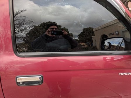

    Until I decide what to do long term I carefully covered my crappy window trim with two overlapping rows of black electrical tape. Cheap and quick! Looks a lot better than it did!
