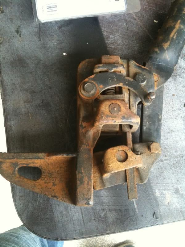

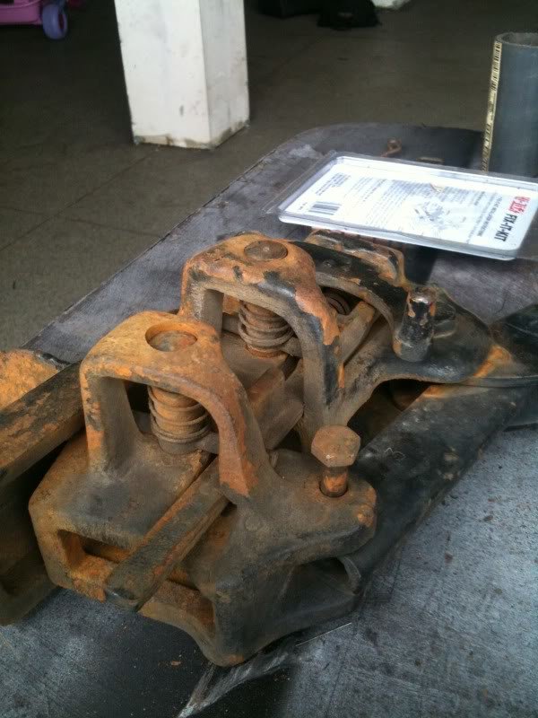

    So I was giving a Hi-lift from my buddy after helping him with some stuff around the house. It looks kinda rusty and he didnt have the bar that comes with it. I want to restore it back so where it works smooth and looks good.I want to mount it to the bed rail when im done with it, Also i do not have any experience with one of these things
    Heres a couple pics
    Any suggestions what i should do?.........Sandblast,Paint,Grease?

    Sandblast. Powder coat. Grease

    Spray lots of Seafoam Deep Creep or PB Blaster and that will really help it out

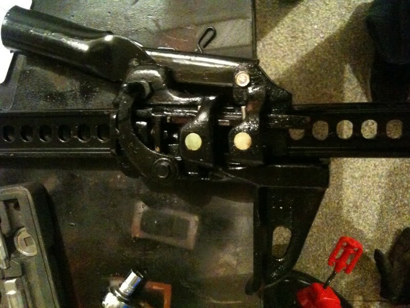

    Then take the whole thing apart and clean off as much rust as you can. If you can sandblast it that's great. I just went at it with a wire brush. Once you get it cleaned up as best you can, I used some Rustoleum Rusty Metal Primer to prime it and then sprayed it with 3-4 coats of Rustoleum Semi-Gloss Black. Once it was all dry I assembled it with the new climbing pins etc and get it all back together. That's all there is too it. Makes a HUGE difference and I feel much safer using it again.

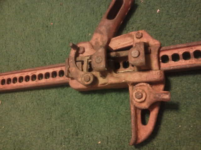

    Here's some before and after pics of my jack. Sorry for the crappy phone pics.
    Before:
    you can see how rusted the pins were. It was not a smooth operation to use this in this condition.
    After: all painted and reassembled.
