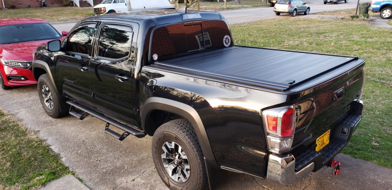

    And here it is..

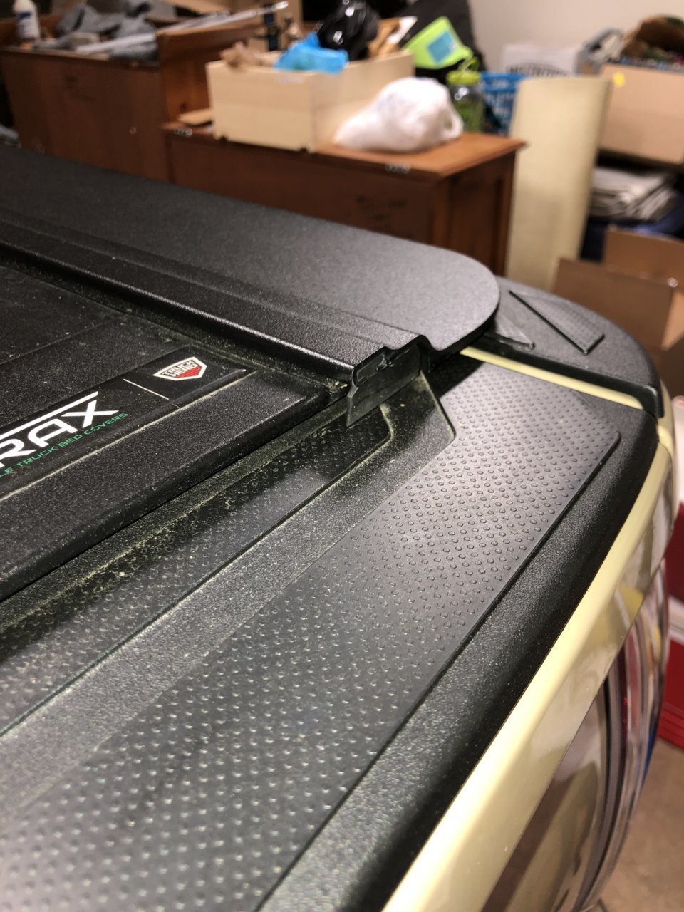

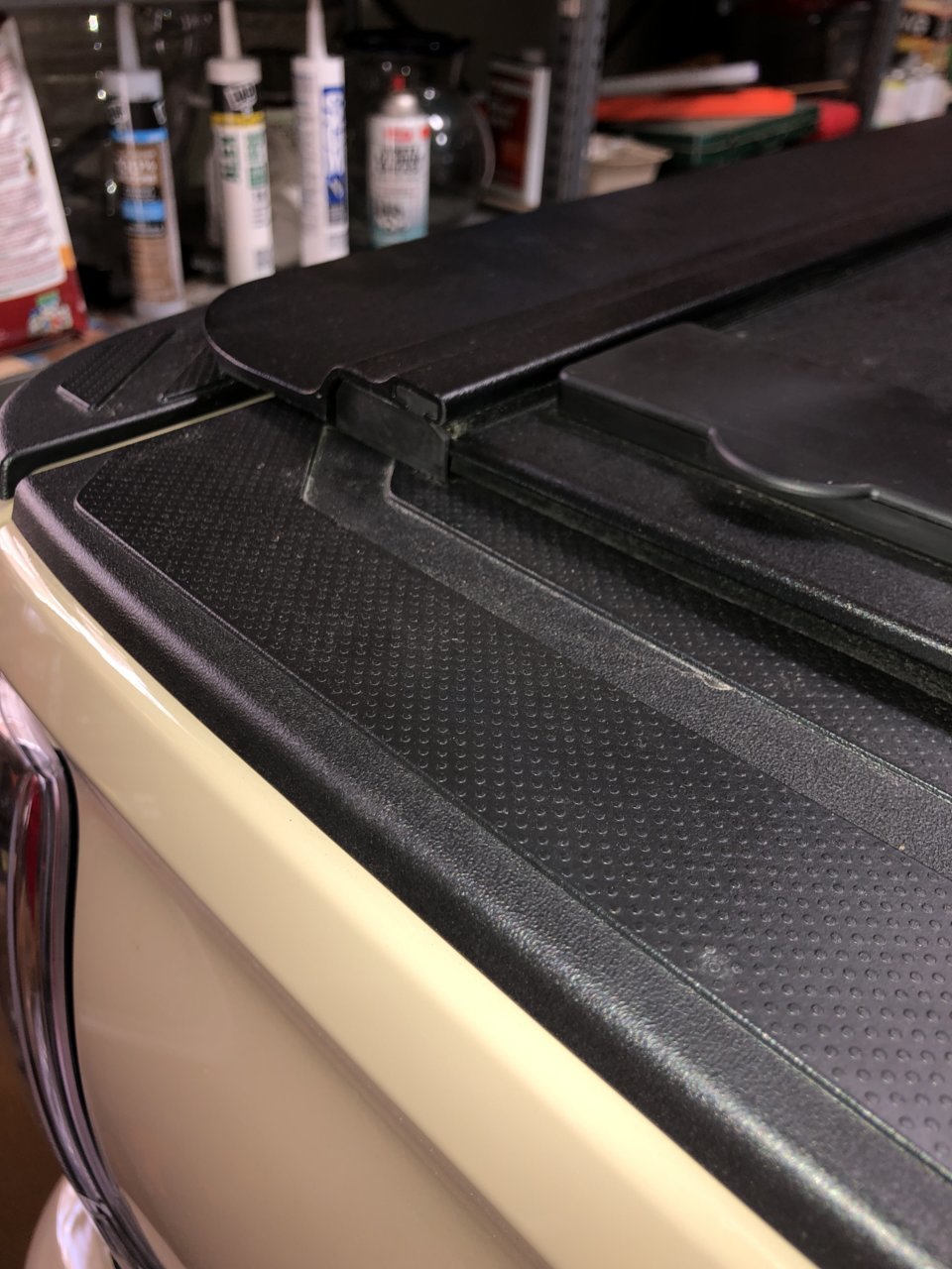

    OP or any other. Has anyone had issues with their retrax opening a bit on the non-locking side after driving for a bit? Mine does so I wrote retrax and they were less than helpful. Ran into a guy on the street who has one on his Taco and he said he has the same problem. Looking for solutions. Thanks!

    When you say, "opening a bit," what exactly do you mean? I've had the Retrax for over a year now and though I don't drive a lot, I've not had any problems with it at all.

    Here are some pics of what is happening. The left side stays put, all the way closed, because of the locking mechanism, whereas the right side seems to vibrate open a bit. ReTrax said some movement was common and that I should try shimming the rails together slightly on the tailgate side so it sort of pinches the cover together. I used the spacer shims that came with the kit, but it only was about 1/8" per side, so it didn't do much. Thoughts?

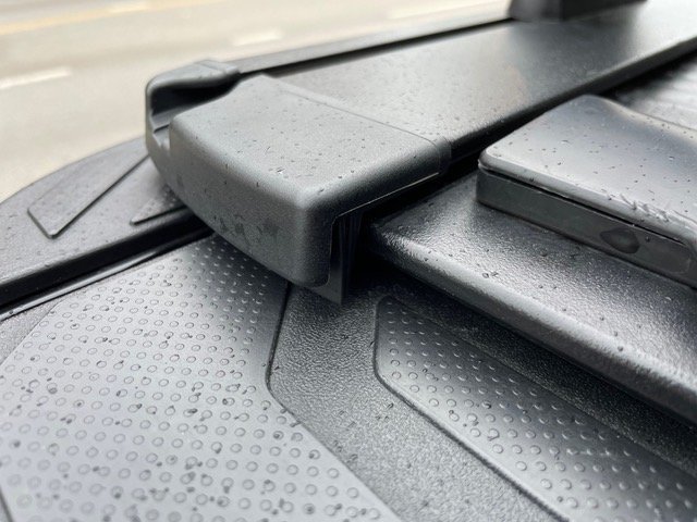

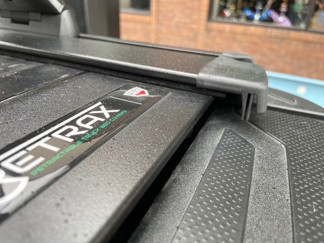

    Here are pics from my professionally installed Retrax for comparison. I have the MX; it looks like you have the XR. Are you sure the front of your Retrax near the cab is positioned correctly?IMG_0152.jpg IMG_0153.jpg

    Thanks for the tip @DMZ - I just adjusted the can a little closer to the cab. It makes me think that maybe the gasket on the bottom of the leading edge of the cover was pushing against the tailgate and causing it to open on that side. I lined it up so that the gasket just touches the tailgate. I drove it around a bit and it didn't open, but the proof will be tomorrow after I drive 100 M home. Thanks much and happy Thanksgiving.
