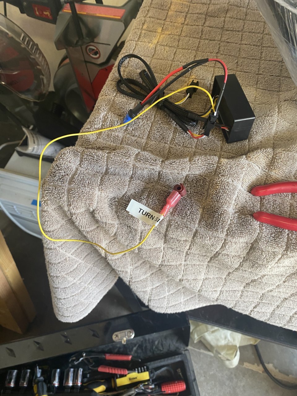

    6193882D-2323-41EE-88E1-BC29C0E9B32C.jpg Anyone know which wire I tap into for the Meso side marker switch backs? It’s the yellow turn signal wire

    the positive wire going to your stock turn signal bulb. It’s blue on one side of the truck, peach on the other.

    Tap the turn signal hot wire. There is a plug behind your turn signal bulb with 2 wires going to it.
    Driver and passenger have different colors. Each has a ground and a hot wire. Tap the hot wire.
    BOMBS and MunchTIME[QUOTED] like this.

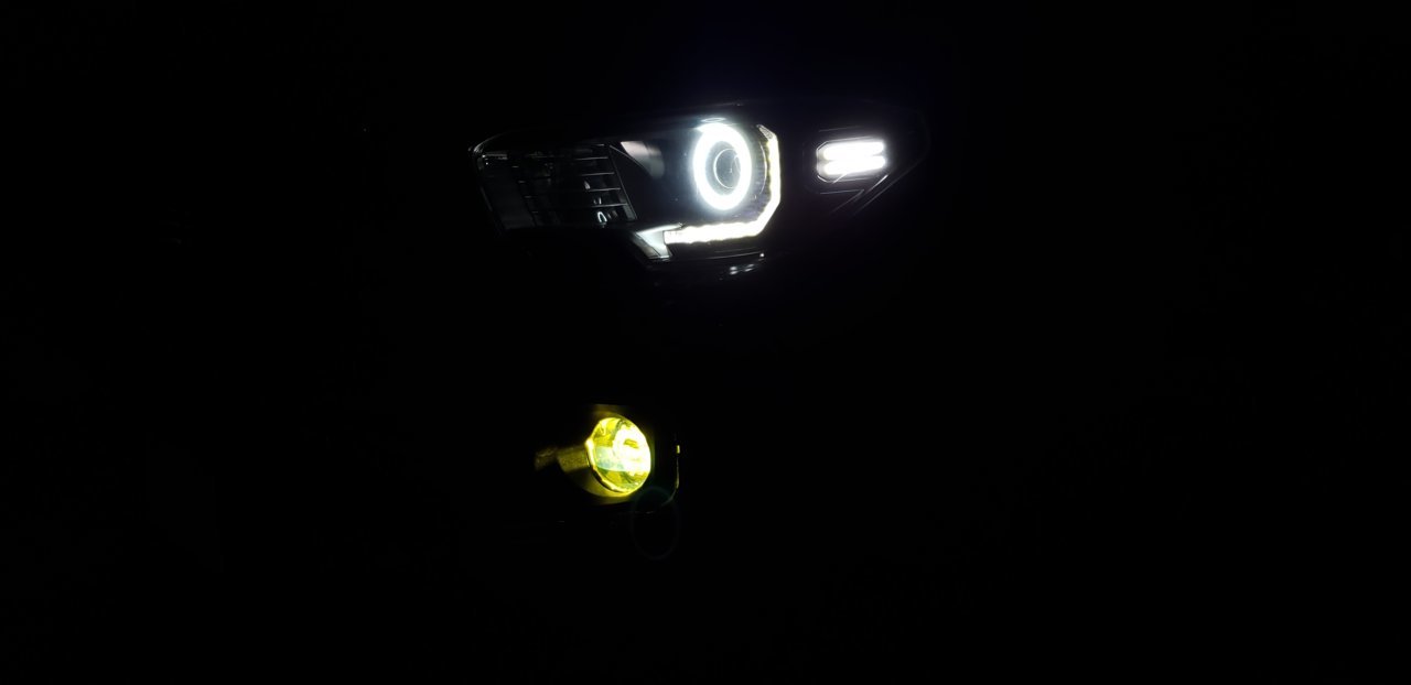

    Mine are installed! Night photos to come.
    BOMBS, dskakie, PapaRee and 3 others like this.

    Looks great! Glad to see another black truck with the setup that I’m getting done. Mine will be shipped next week!
    Show us some pics with DRLs, running lights, hazards and headlights (if possible).
    Cipher94[QUOTED] likes this.

    Here's what my hazards look like/they also look like that when signaling. I have meso turn signals in the mirrors too.
    I need to get LEDs for the front signals.
    cshrum, EldenRivas, BOMBS and 2 others like this.
