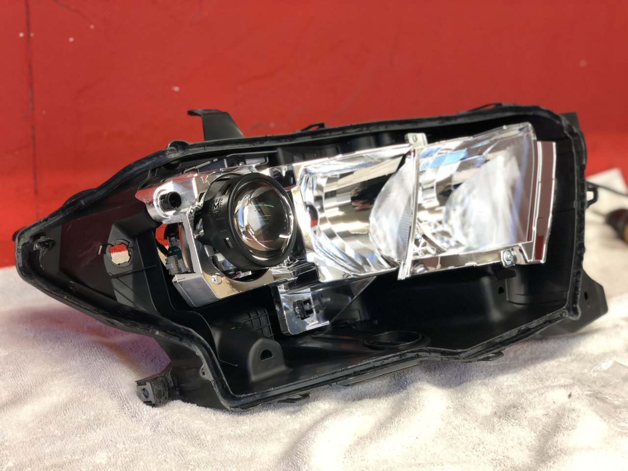

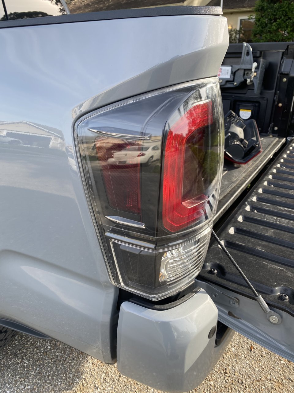

    Those look great. Can't beat that OEM+ look! The MLEDs are what I'd like to swap into mine once I get some time to get them apart. My dad and I did a set of 2020 tail lights, removed the chrome, painted everything satin black and smoked the reflectors. seeing as we wont need to cut into the lights to get the headlight apart, it should be a much easier task.
    We'll be redoing this drivers side light since the sealant decided it was going to seep into the housing but the right came out fine. 19789A01-A5D1-46FB-B333-E79470044CA4.jpg

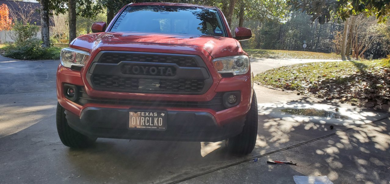

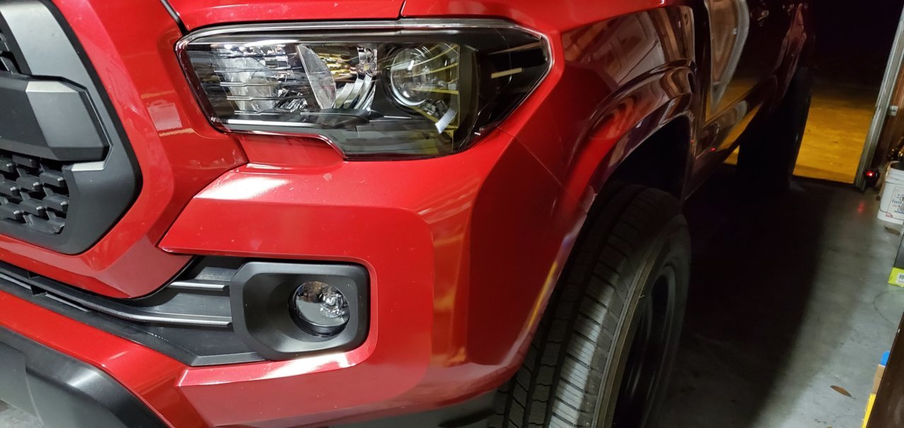

    Just finished putting these in 5 minutes ago. Already dark out so these are the best pictures I could get but these things look awesome and now my headlights match my fog lights!!!!
    Thanks @no vtec 4me !!!!
    Kevin is a PRO! The packaging my lights came back to me in were WAY better than how I sent them! Lights look amazing. Can't even tell they were opened up. 5 stars!!!20210107_175912.jpg 20210107_175922.jpg

    Thanks!^
    They really brought the front end together!

    I just did the BHLM and added the @MESO side marker switchbacks. Pretty basic.

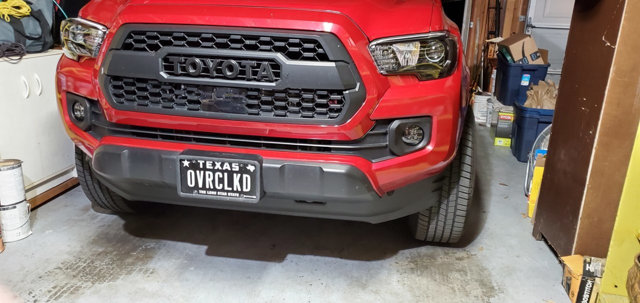

    20201212_143756.jpgBefore and After. Will post better pics later.

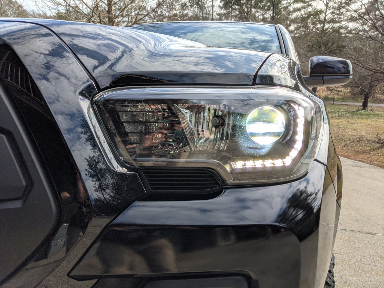

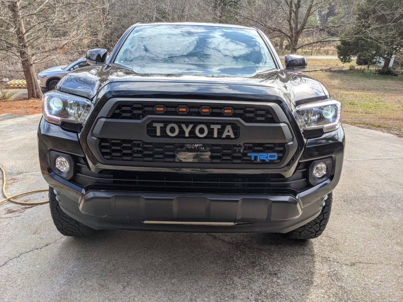

    Got a better pic in the daylight.
    Love 'em!

    Whats your lift and wheel setup
