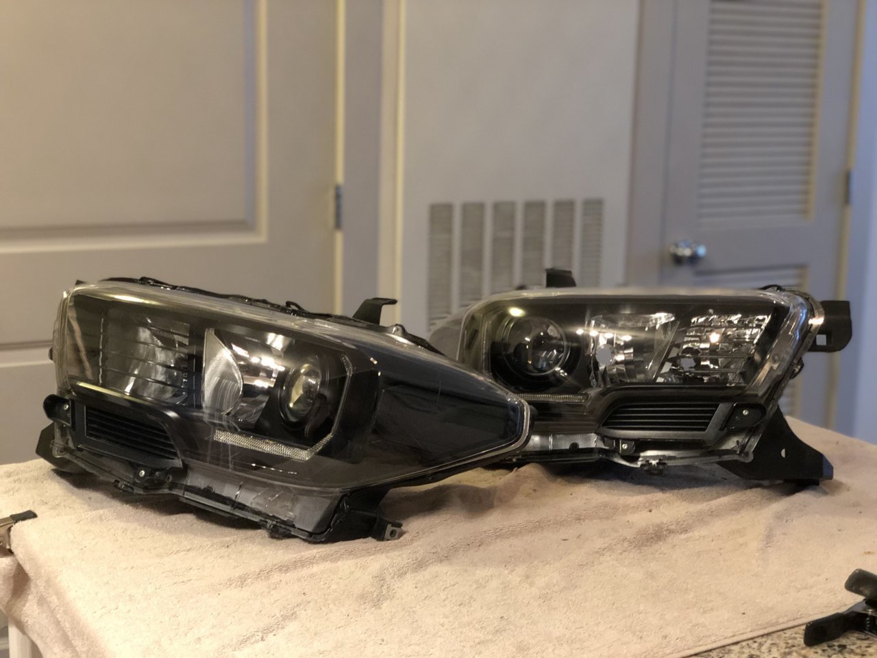

    Another standard bhlm getting shipped out. These are really a great bang for your buck cosmetically!

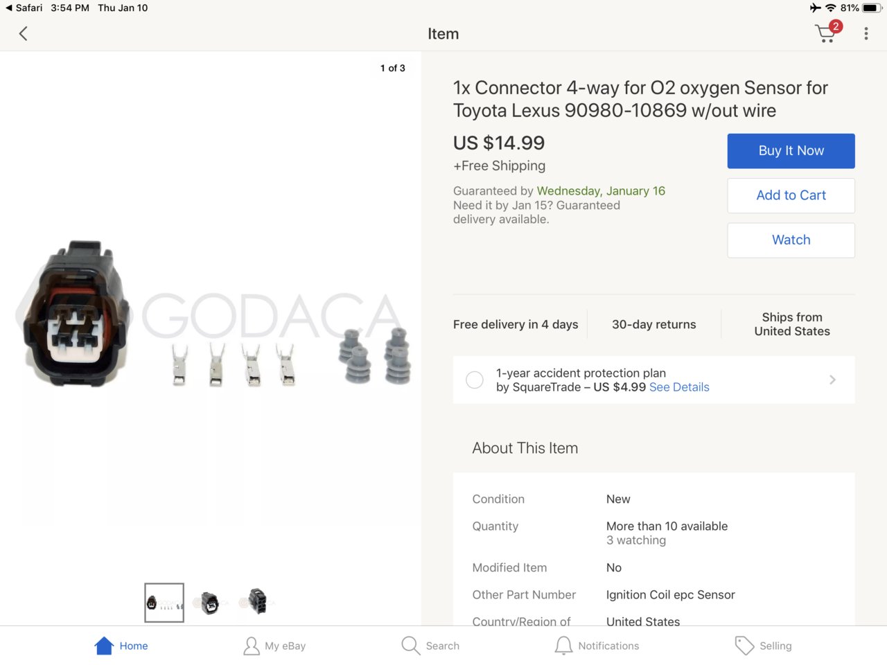

    Look what I found hope this helps. I’m pretty sure it’s the sameE75C430C-CEF8-41E7-AB87-1E60C8773289.jpg

    Good find! Looks to be the same, I’m sure that could come in handy for people.

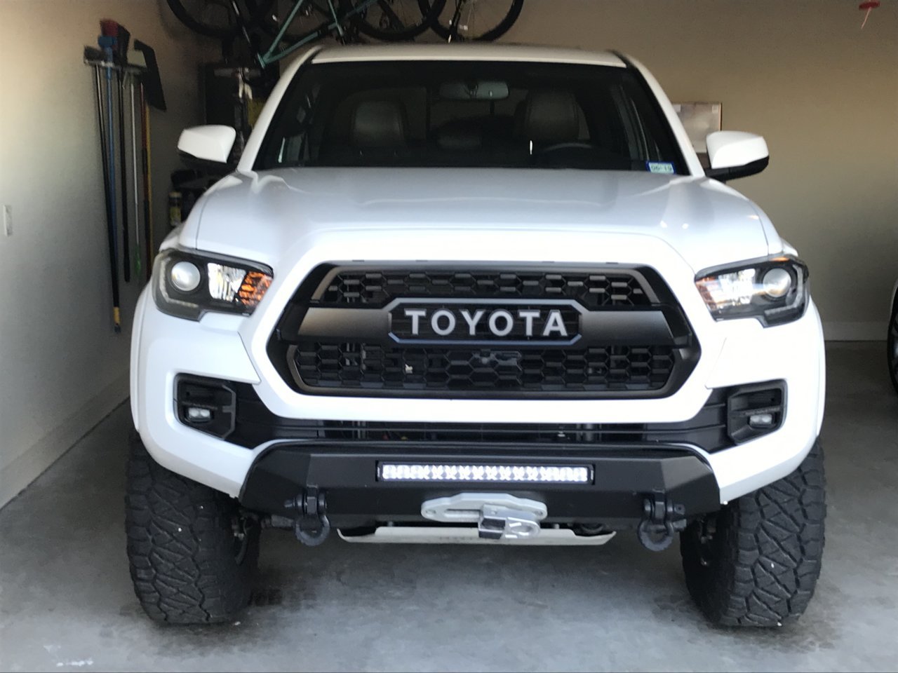

    Absolutely BEAUTIFUL ...
    I can’t wait for my set!!!!!!
    Great Job

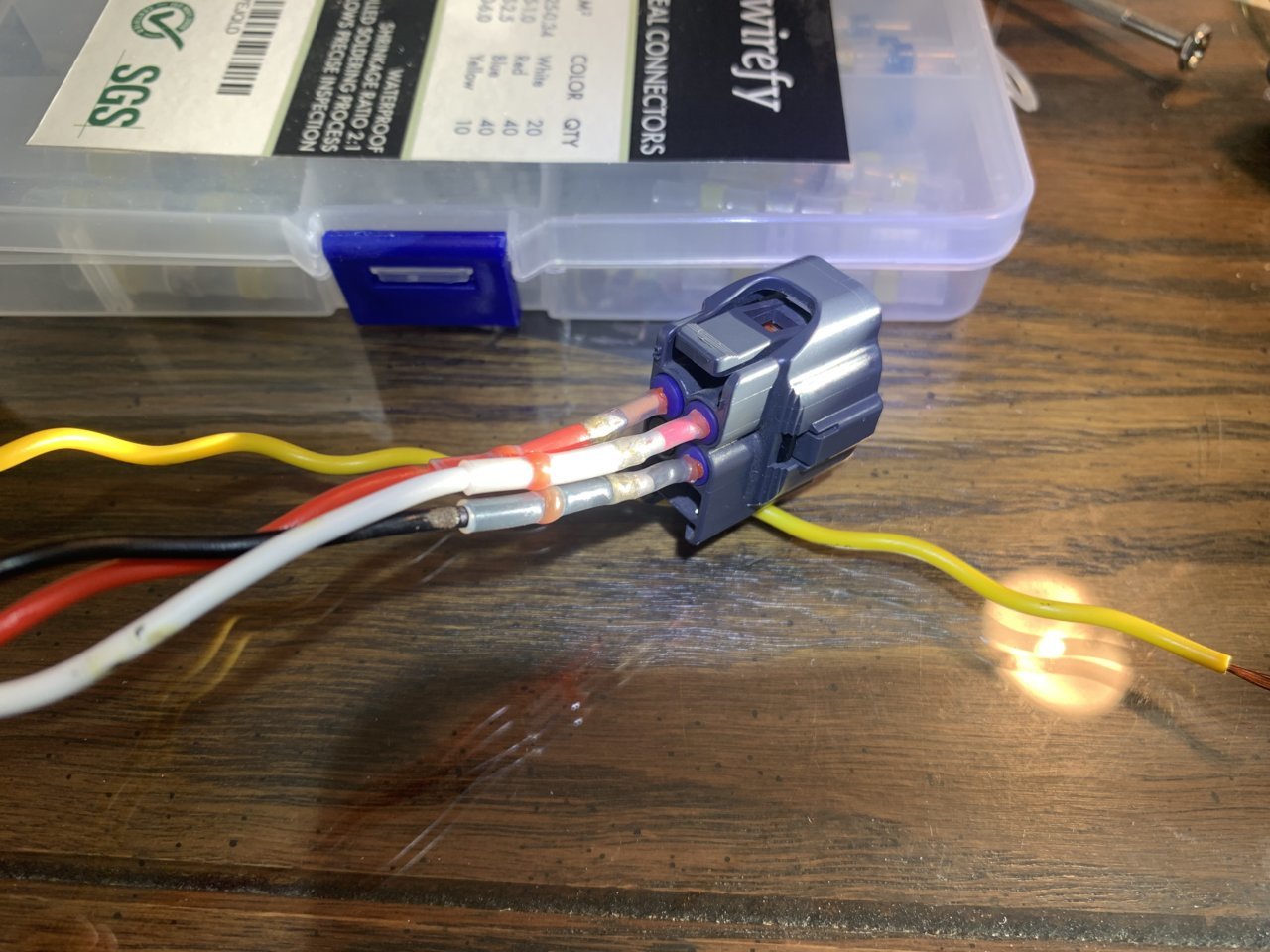

    Nice! I was able to piece together the original DRL connector to the Diode Dynamic Driver9B38F082-9225-4799-9BE5-CA43A549DD7E.jpg

    I did the same thing so I didn't have to splice anything on the the wiring harness. Nice job.

    Got the idea from you!!
    This was the easiest way to wire the DRL.

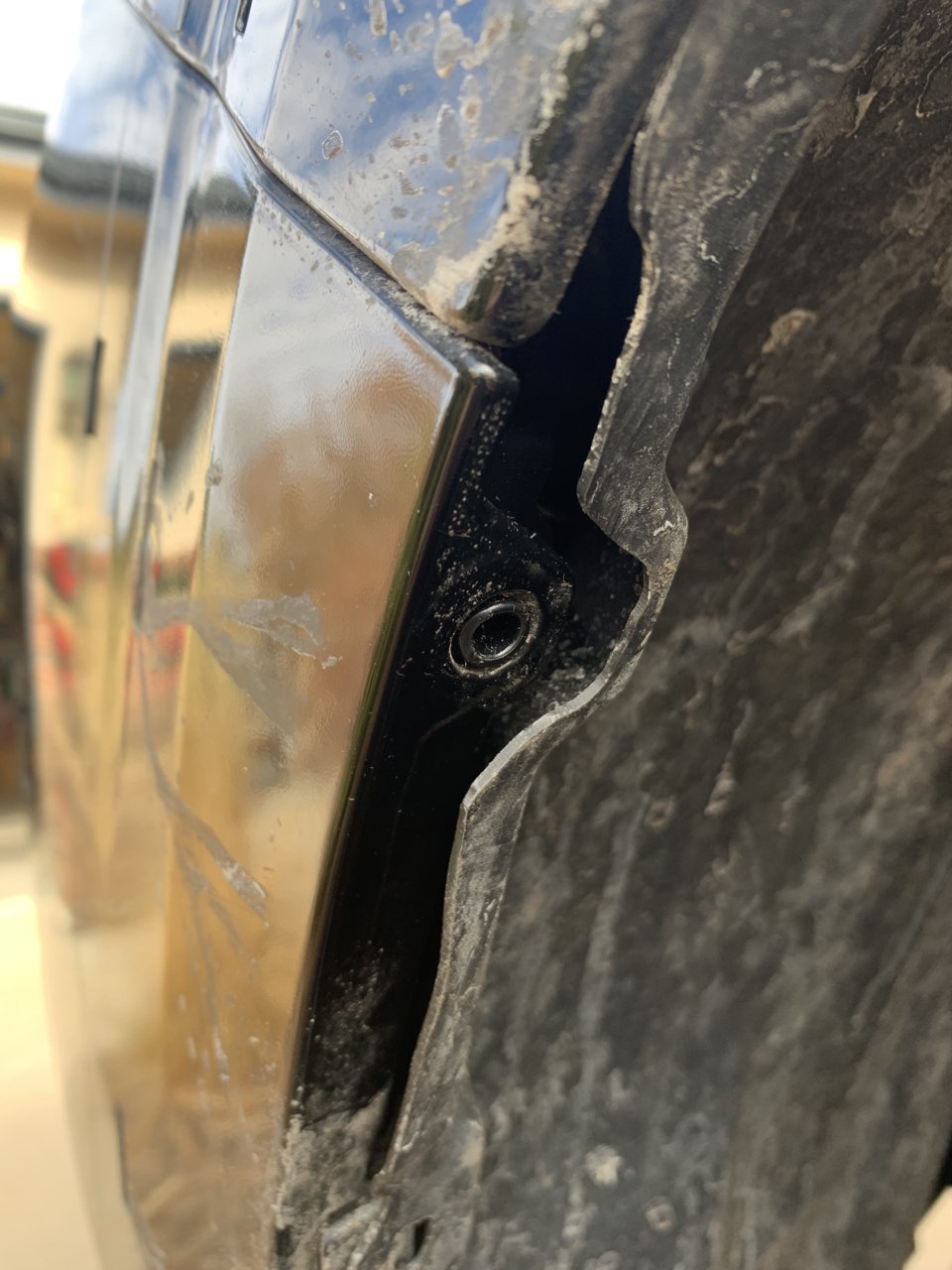

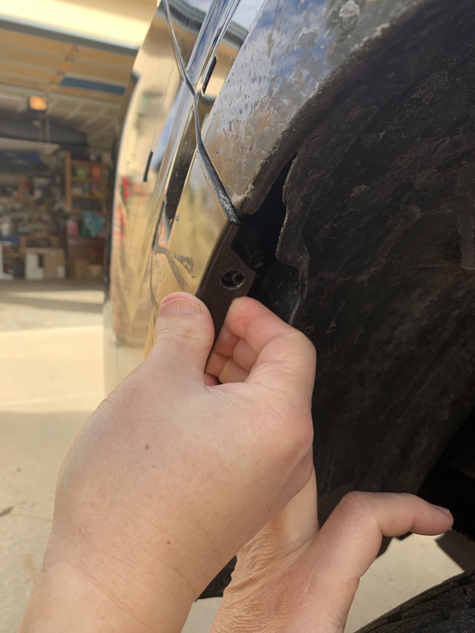

    Crazy to quote myself - could not figure out how to edit my own post and add a new pic. as I reinstalled my bumper I realized why I broke those tabs mentioned above.
    This is driver's side wheel well looking forward. Front bumper back on snug with fender over the black hole ( this hole is part of the bracket that I broke; also where the screws go in to hold the bumper to that bracket.
    THIS IS HOW YOU SHOULD REMOVE THE BUMPER . ONCE YOU LIFT IT OVER THAT HOLE, NOW YOU CAN GENTLY LIFT UP... WISH I HAD SEEN THIS PIC BEFORE I STARTED IT. OH WELL, HOPE IT HELPS SOMEONE

    Is there something different about your amber inner signal?
    Thought about the Meso plates too not sure really how they look on a blue truck. Cement and white are amazing imo.

    No just that “fins” are painted black
