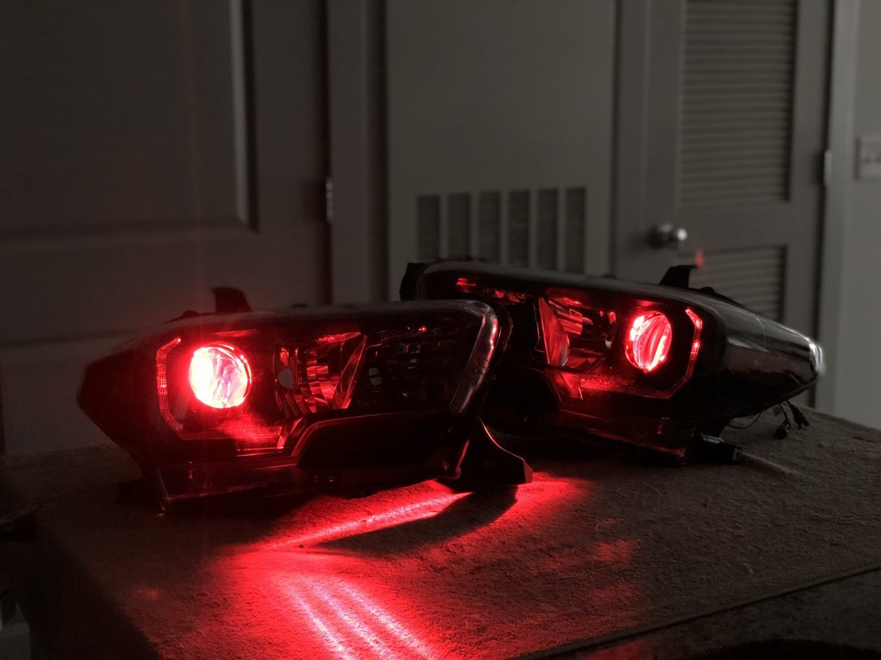

    Single color demon eyes are now available. They come in red, green, blue, or amber. $40, I’ll be adding them to my price list.

    These demon eyes are they set up as a daytime running light- plug and play? And can this be done with the stock halogen projector or do u need the hid upgrade ?

    They can be tied in with your drl’s for a complete plug and play set up. They can be done on the stock halogen projector, yes.
