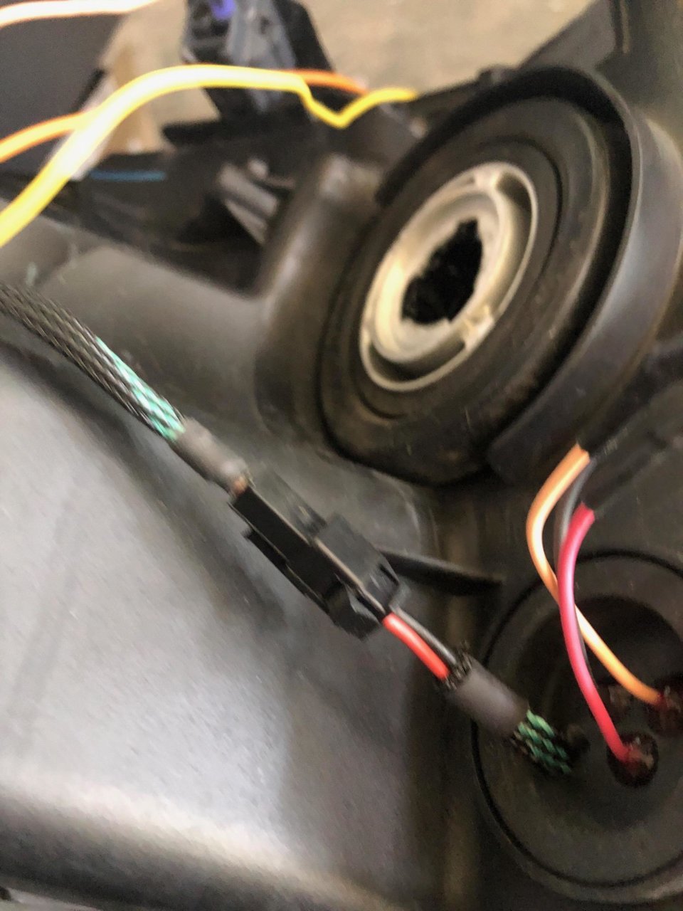

    Just picked up a used set of these with diode dynamic switchback side markers. Can anyone tell me how the side markers wire up?

    Blue wedge connector goes in place of your stock side marker bulb.
    yellow wire gets tapped into your positive turn signal wire.

    ok, thanks. That’s what I thought. Just wasn’t sure what to tap the yellow wire to. Much appreciated.

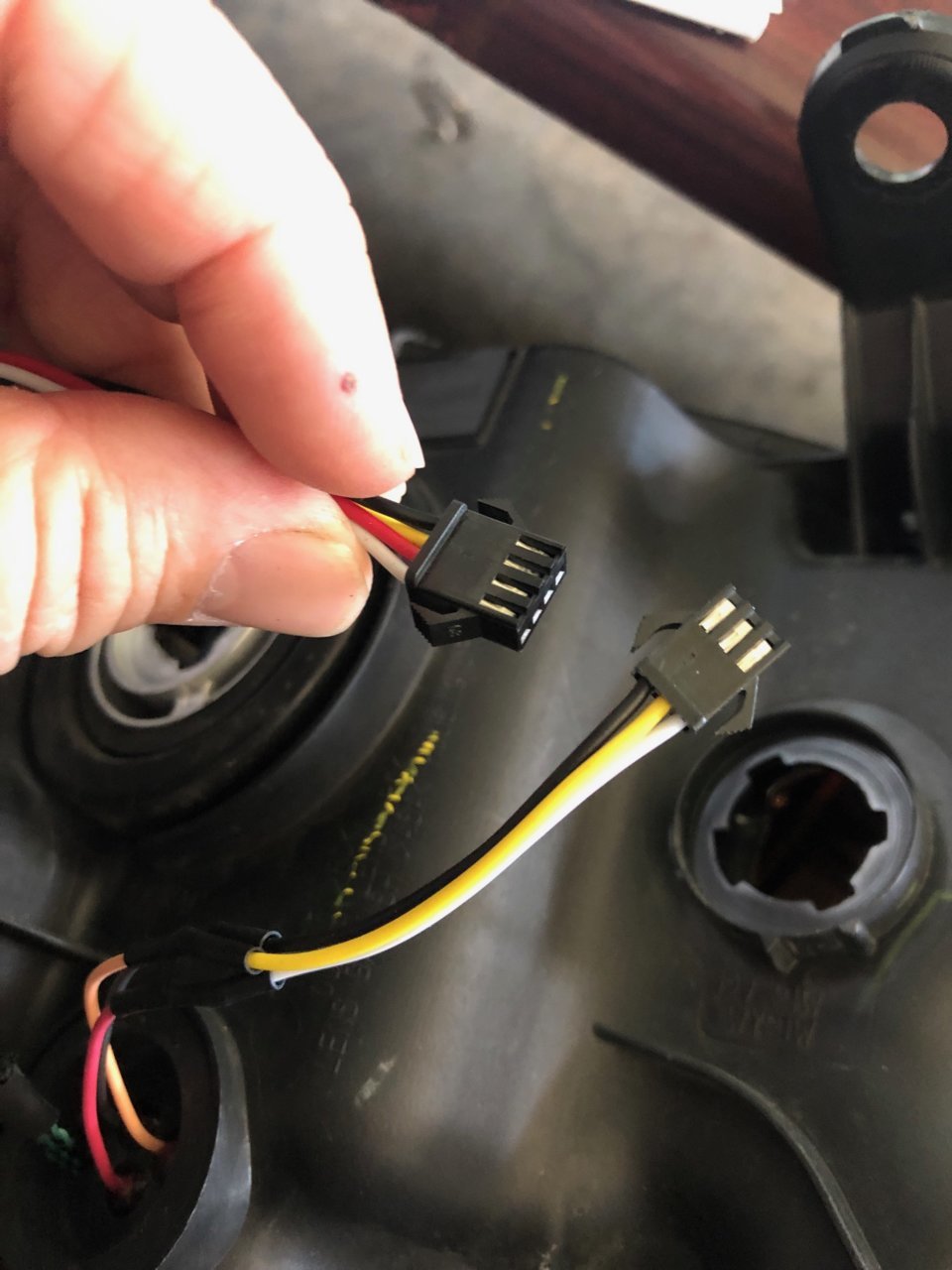

    Hey everybody. I'm kind of in a pinch here. I need a quick response on the wiring diagram for headlights that have been retrofitted and have both the switchback diode dynamics DRLs along with the halo lights. There's wires coming out of the headlight assembly but they're not marked as to which is which. Does anyone have a wiring diagram that they could shoot out ASAP?

    A picture of which wires would be helpful

    Two male connectors. I got 30 minutes to figure this out if someone can help.611171732.jpg 611171747.jpg 611171732.jpg 611171747.jpg

    So it's the yellow black and white one that I can't figure out. What goes where?

    There’s a LED driver that goes in between those 2 plugs. DO NOT PLUG THEM
    TOGETHER

    Found them. Buried at the bottom of a very large box. Thanks Meso.
