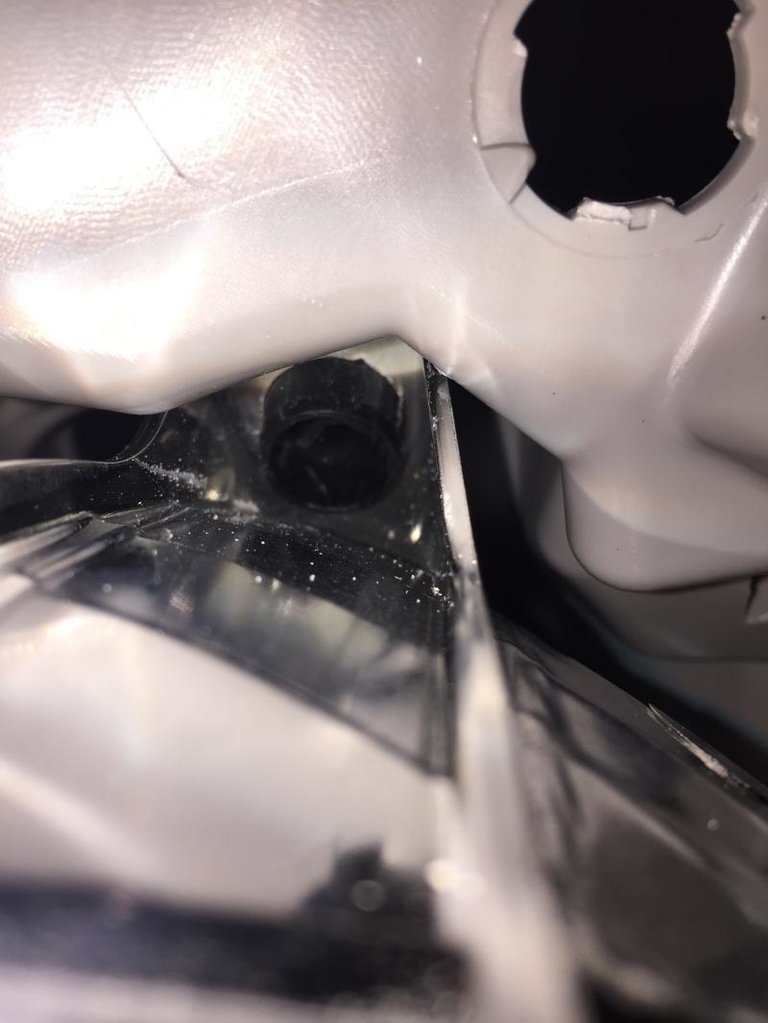

    The screws Ive got now. What about this part? I put a lot of pressure on it pulling and pushing from the back. What's the trick?2029E273-71D7-42E4-8B5F-85BA2BB95BE5_98fe08c6b9944fcbaec3b5af223364b831fe7846.jpg

    On the inside of that black round piece there's a tab that needs to be pushed in. That's the piece that you should try n avoid destroying lol. Use something small like a eyeglass flat head screw driver...I used a regular flat head and it kinda destroyed that part so my reflector has some wiggle in it now
    Edit: actually it should have 2 tabs that need to be pushed in
