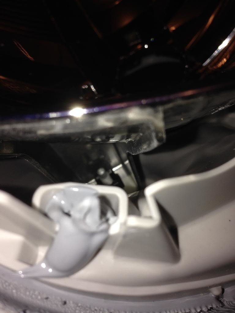

    does anybody have a tip for getting the outer part of the reflective bowl out? the inner side pops right off. a write up said to pry the tabs inward while putting some pressure on the bowl but the tabs don't seem to budge

    i think you get it apart by backing it out with the adjustment screws on the back after you pop it loose from the inner part
