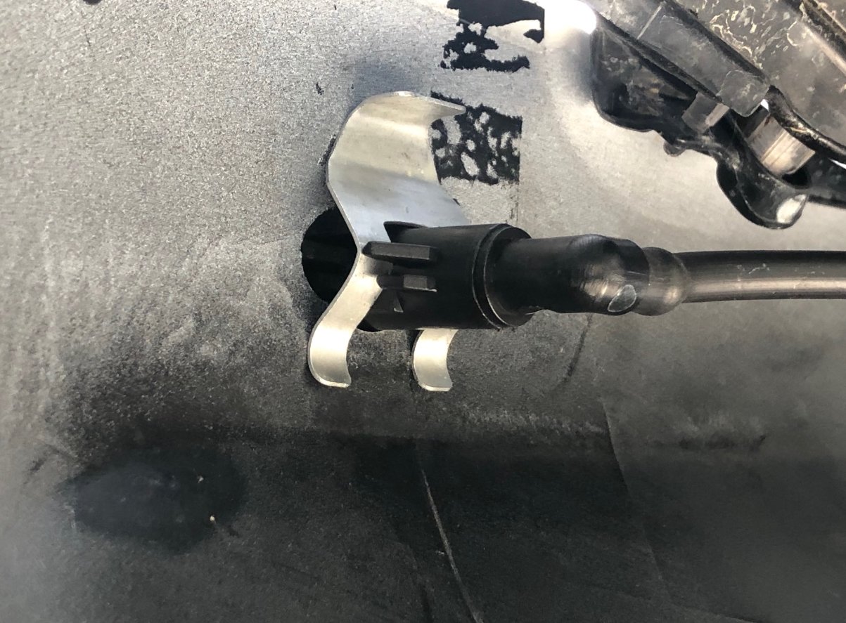

    So here's how it looks behind the bumper.

    Before making the hole, didya just eyeball it for position? I mean how to get the spray pattern right?

    I did make a template by cardboard, just to make sure both sides are at the same position.
    For the nozzles, yes you can also adjust them to some degree by pushing it downward, upward, left or right.
