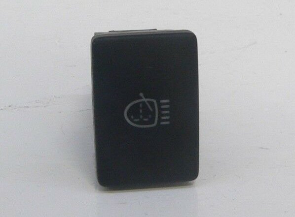

    Yes, for the rear washer I think. As long as you can find another tank small (Or big enough) to fit in the Engine Bay then it is cool to have a separate switch like the Land Cruiser LC200. They even have the factory style switch you can purchase and do the retrofit.

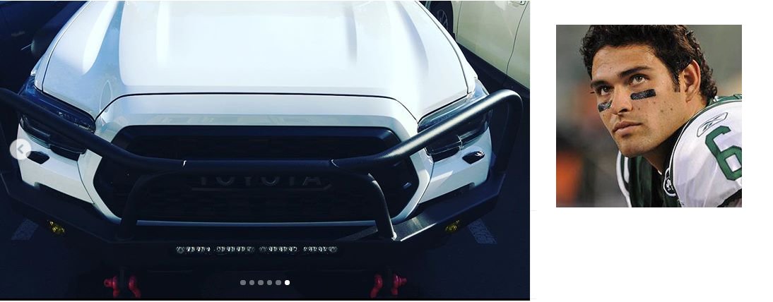

    My buddy just told me that this mod looks like the Eye black for the football players! lol:rofl:

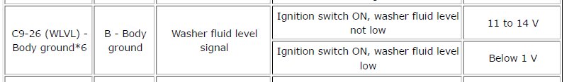

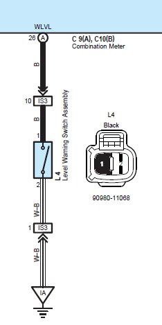

    So the wire harness is there for the sensor already? Do you think if you plug it in it would activate the low washer warning light properly, or do the Canadian trucks have it software enabled separately?

    I know the plug is there, but I can't tell if it is just a plug and play. Toyota is running CANBUS on their ECU these days, so it could be a potential challenges.

    Make a jumper wire and verify...22 awg

    Hmmm... Is it just a 2-wire harness? Shorted = empty? I wonder if there is a missing fuse somewhere also?

    So closing the circuit would be empty...
