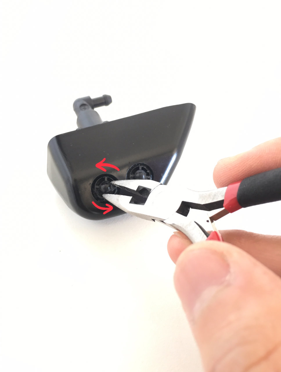

    Some member asked me how to adjust the nozzle. See the photo attached, you can pretty much adjust the nozzle any angle you want. Up, down, rotating to the left or right.

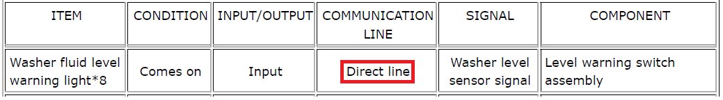

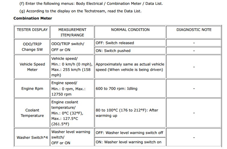

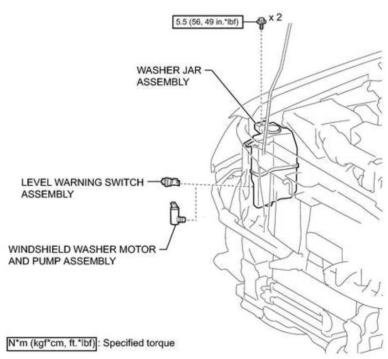

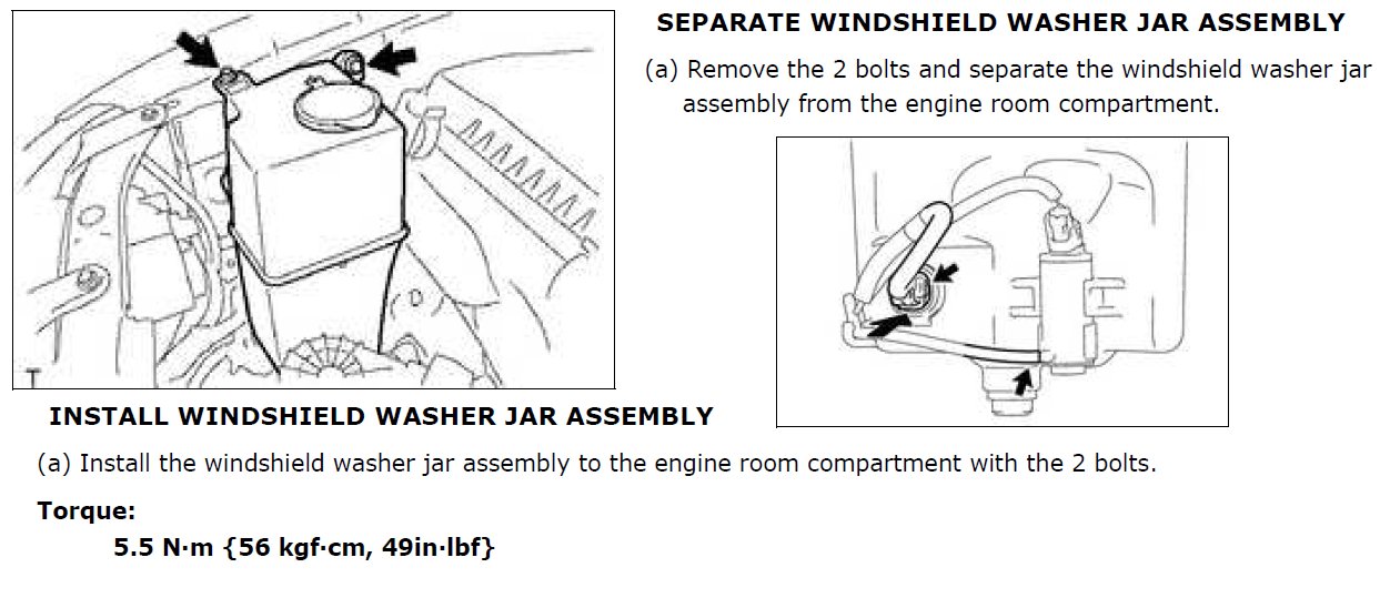

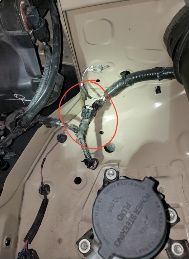

    Edit: After digging around a bit more, I believe us US folks would have to
    replace our combination meters in order to get the low fluid warning
    indication. That would be cost prohibitive.
    I ordered the fluid level switch. It's a magnetic float switch, which is kind of interesting.
    • It fit the existing plug perfectly.
    • I held off on installing it in the fluid container until I was sure it worked.
    • Flipping the switch 180 degrees to open and close the magnetic switch produced zero results.
    • No message appeared on the the multi-information display.
    • The switch did not appear in Techstream.
    There are a couple of possibilities:
    • The US models have the plug, but no message/light system.
    • There is a system that must be enabled by the dealer.
    • There is a fuse required for the switch. However, even if the fuse is missing I would expect the switch to appear in Techstream.
    More research is required on my part.
